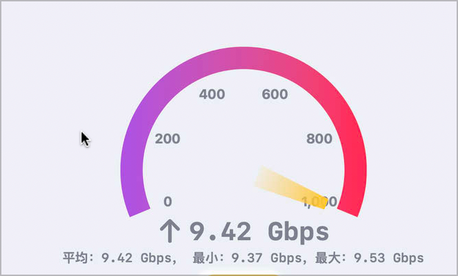

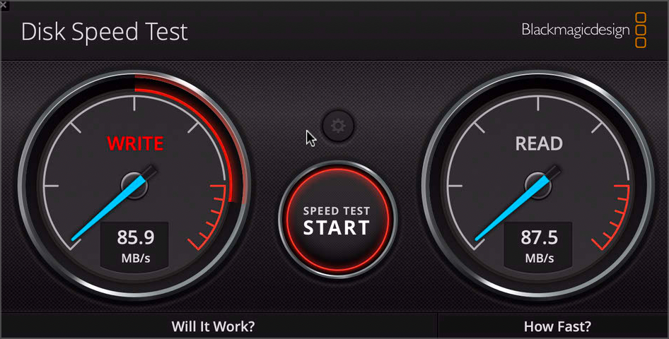

I've added a standalone NVMe solid-state drive to my NAS, which has a speed of 7GB/s. However, after connecting to iSCSI, the speed is still very slow. Here are my diagnostics, could you please help me figure out where the problem lies?
Please share a bit more information about how you've set it up.

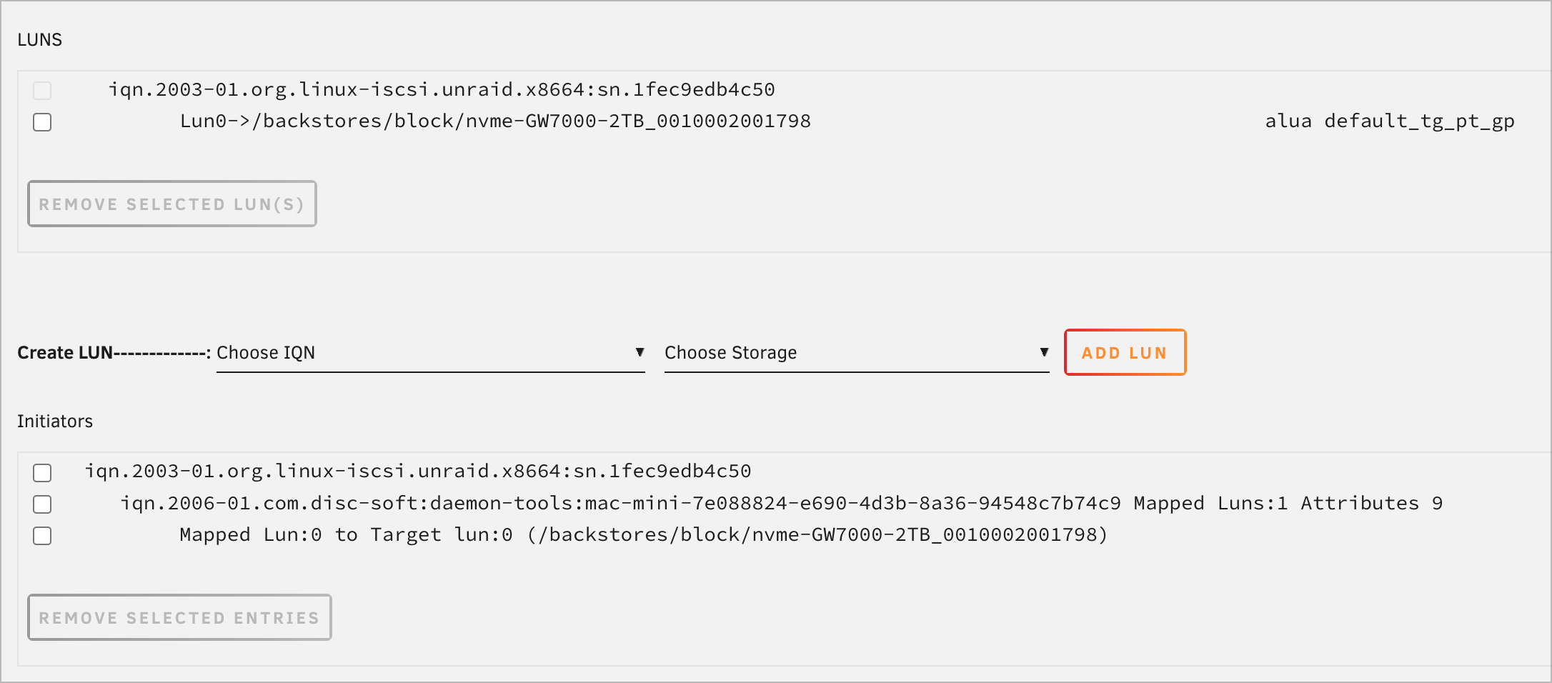

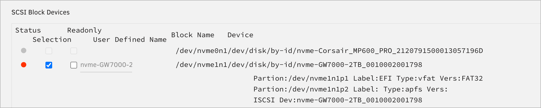

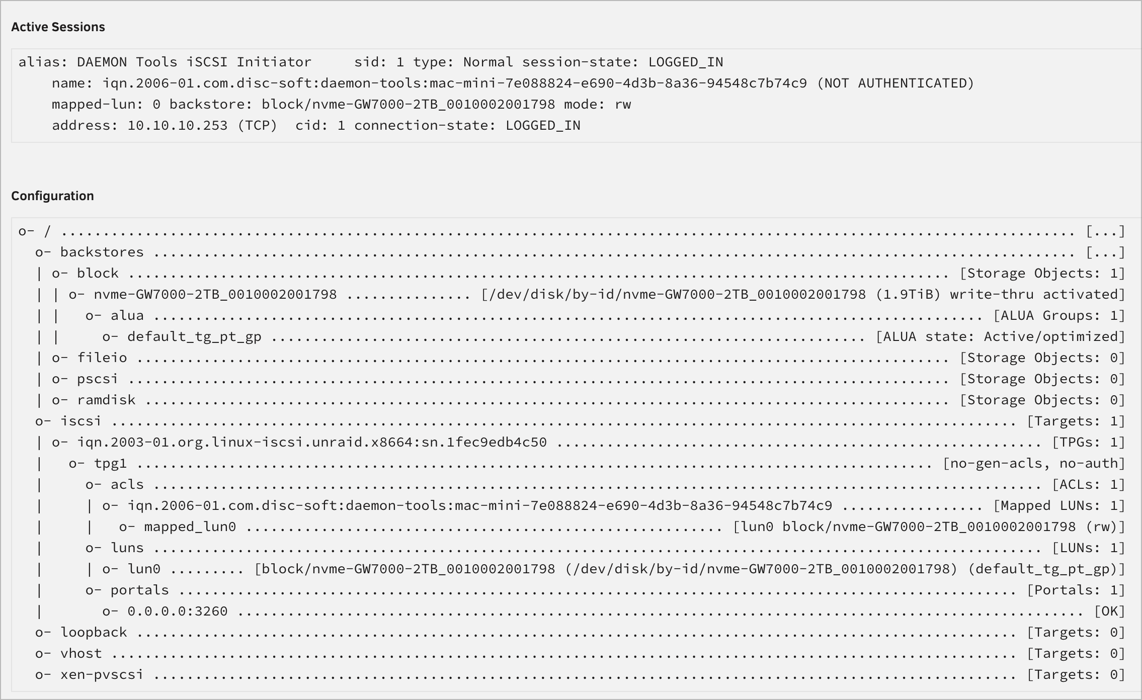

Here are my diagnostics, along with some screenshots of my settings.

What client or better speaking initiator are you using? Are you sure that you aren't limited by the client?
Have you yet tried another machine?

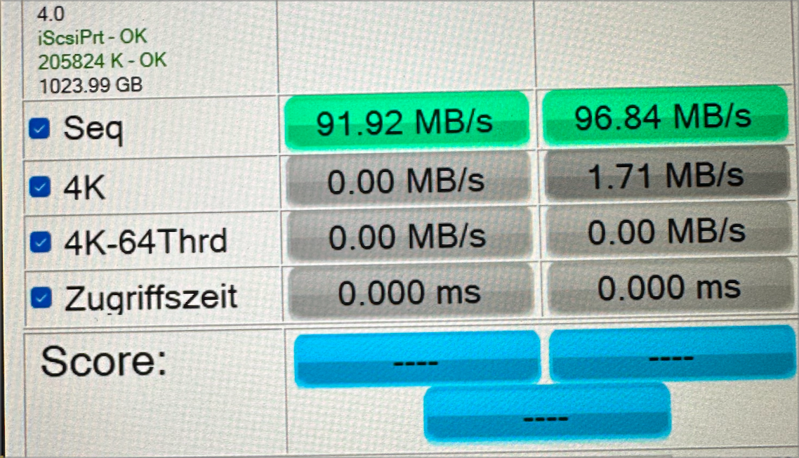

I have the same issue under Windows, and I've tried all other settings, but it's still not working. However, under the same network conditions, the SMB protocol can reach 900MB/s.

Have you yet tried it with write thru deactivated?
I would also recommend checking what's going on here your syslog is full of these messages:
