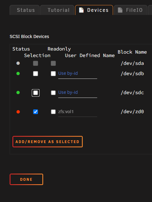

Hi, like everyone, new to ISCSI World lol I got few question that I need some help

And also I have a bug on my newer server on UnRaid v6.12.14 -> I am unable to Add devices.
In Devices -> I check on the first one and it auto select all the available disk. after I Click on Add/Remove as Selected Button -> got the popup saying Adding Block and few second later it disappear, all selected device return to unselect and can't select them in Initiators.
Been able to add them one by one with targetcli only.
With v6.12.4, the GUI to Select all drives work #1 with same plugin version.
I tried to reboot the server and redownload the plugin and still same issue. Also tried on another browser. The GUI on v6.12.14 are a littlebit offset compare on 6.12.4 also (see picture)
Maybe @SimonF can help with that.

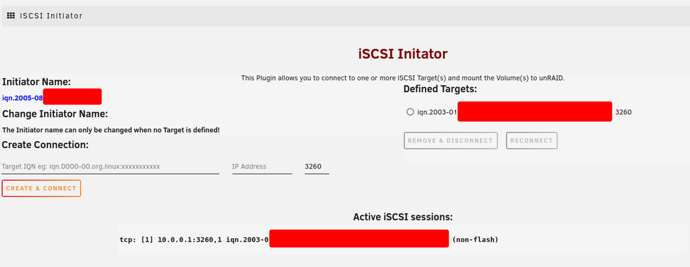

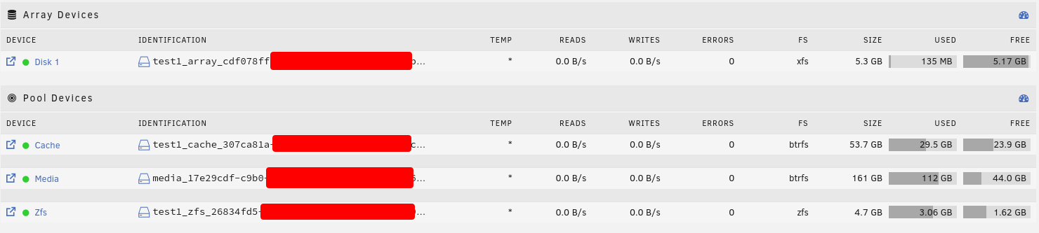

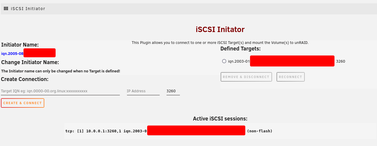

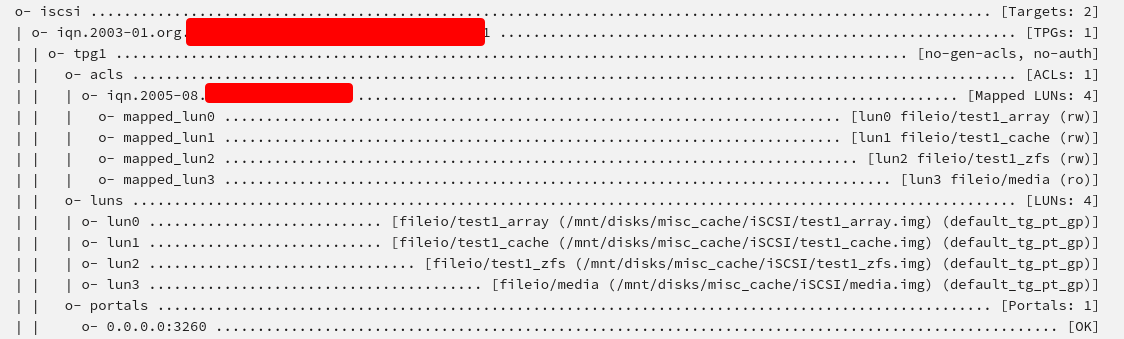

Yes, you can use whatever Block Device your iSCSI Target is providing on another server as long as you install the iSCSI Initiator:
This is the Target Side (please note that I use FileIO images which I don't recommend since I don't need that much performance on my test servers) :
This is the Initiator Side:

Yes.
This is how it looks on my 6.12.14 test machine, I cannot replicate you issue my is working as expected. Will look at diags to see if I can see any common values that may affect.

Hi, is that can help -> I can only add them by using the CLI and I cannot remove any Devices from the GUI either.
By the way, What is the targetcli to remove a block device? I need to remove some block :/ uhuh

Hi, meet a wireed performance issue,
I am using the ISCSI target plugin and trying to expose a zvol to windows. The connection between my nas and windows is a 40Gb/s network card. The ZFS pool is built by 8 HDDs with RAIDZ2 and no performance issue occurs while coping data between windows and this ZFS pool via smb (around 500~700mb/s).
The problem is that writing speed drops to 0 or a very low speed after a few seconds with full speed, even through for a large single file, and I noticed that there will be a SINGLLE CPU core will have full usage while others remain 0% usage.
Here is my ISCSI configuration:
o- / ......................................................................................................................... [...]
  o- backstores .............................................................................................................. [...]
  | o- block .................................................................................................. [Storage Objects: 1]
  | | o- main:new_expansion .......................................... [/dev/zvol/main/new_expansion (10.0TiB) write-thru activated]
  | |   o- alua ................................................................................................... [ALUA Groups: 1]
  | |     o- default_tg_pt_gp ....................................................................... [ALUA state: Active/optimized]
  | o- fileio ................................................................................................. [Storage Objects: 0]
  | o- pscsi .................................................................................................. [Storage Objects: 0]
  | o- ramdisk ................................................................................................ [Storage Objects: 0]
  o- iscsi ............................................................................................................ [Targets: 1]
  | o- iqn.2003-01.org.linux-iscsi.tower.x8664:sn.9cc9a9dacbf0 ........................................................... [TPGs: 1]
  |   o- tpg1 ............................................................................................... [no-gen-acls, no-auth]
  |     o- acls .......................................................................................................... [ACLs: 1]
  |     | o- iqn.1991-05.com.microsoft:zhikai-pc .................................................................. [Mapped LUNs: 1]
  |     |   o- mapped_lun0 .................................................................... [lun0 block/main:new_expansion (rw)]
  |     o- luns .......................................................................................................... [LUNs: 1]
  |     | o- lun0 ..................................... [block/main:new_expansion (/dev/zvol/main/new_expansion) (default_tg_pt_gp)]
  |     o- portals .................................................................................................... [Portals: 1]
  |       o- 0.0.0.0:3260 ..................................................................................................... [OK]
  o- loopback ......................................................................................................... [Targets: 0]
  o- vhost ............................................................................................................ [Targets: 0]
  o- xen-pvscsi ....................................................................................................... [Targets: 0]
Can you help me to figure out how can i fix this issue.
