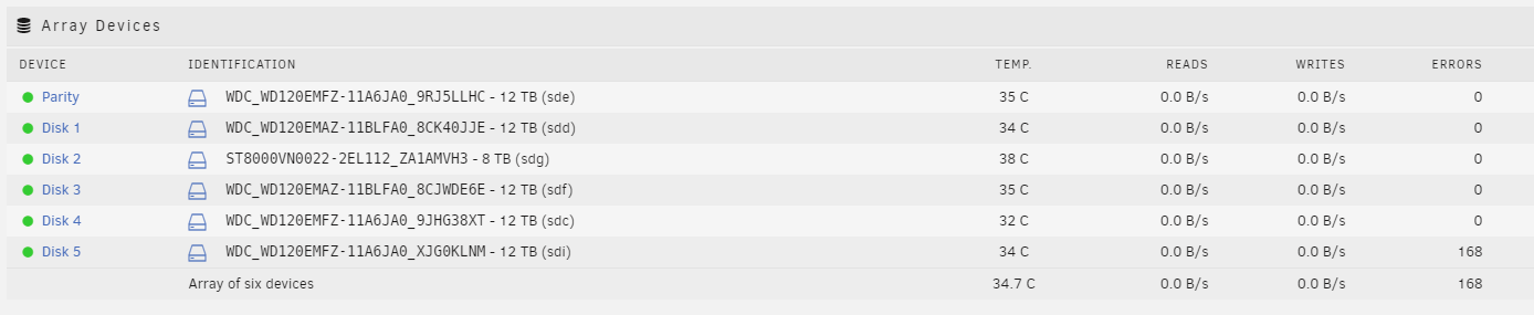

Greetings UNRAID community. I received the status report below via my email notifications. Disk 5 is active and seems to be working fine, but there are read errors documented in the attached log file. A smart short self-test passed. Do I need to stop and restart my array/dig deeper into the operation of disk 5 further? It's only ~3 months old or so. It's under warranty if I need to replace it. I believe what precipitated this was my UPS inexplicably powered off a few days ago. Parity was rechecked successfully after the UPS turned itself off.  There was no power outage with our electrical grid so not sure why the UPS powered off (working on that with CyberPower to figure out what happened there).

Disk 5 - WDC_WD120EMFZ-11A6JA0_XJG0KLNM (sdi) - active 34 C (disk has read errors) [NOK]

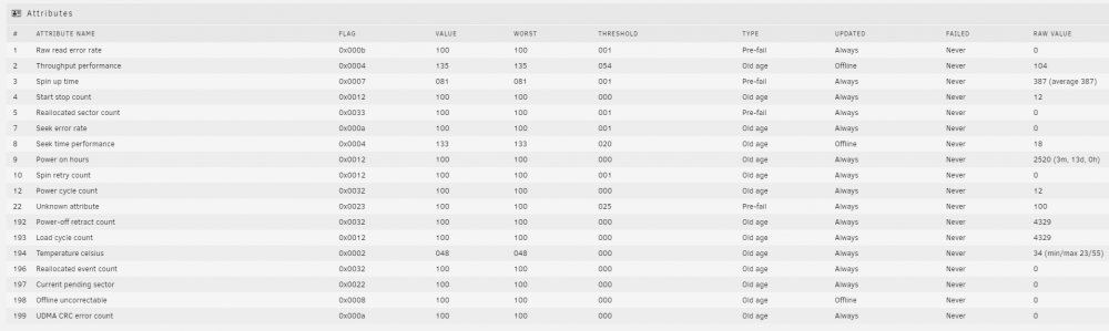

No, simple execute extend / long test for disk5, if fail, go warranty.

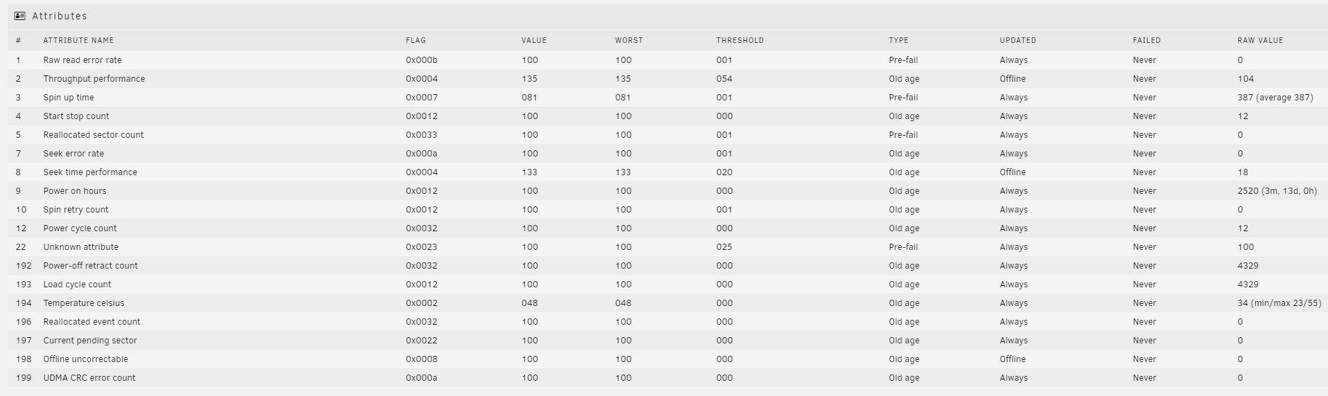

Thanks for the response. I'll give a long SMART test a shot then.
It passed the long SMART test. The array health report failed again (disk 5) with the prior read errors which are now documented on the main dashboard for UNRAID. Anything to be concerned about, or am I good to go?
If long test pass, then problem should not on disk side, pls troubleshoot on controller, cable, etc.
