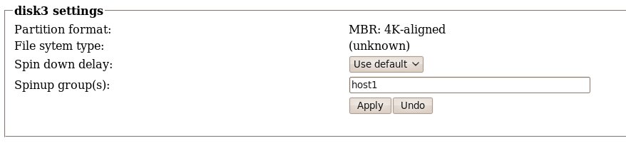

Using 4.7, I replaced a 1TB WD Black (EADS) drive with a 2TB WD EARS without a jumper but pre-cleared with -A.  The rebuild has just completed and all the balls are green now. One oddity though - if I click on the disk from the array screen it says the File system type is Unknown.  I haven't rebooted since I rebuilt it, so I don't know if next time it comes up whether it will read reiserfs. Is the expected behaviour?
Expected Yes...  A Bug, yes...  Reported in the past, Yes.  It will show the file-system type when you next reboot.
Expected? No... A Bug? Appears so... Reported in the past? Yes...  Fixed in the past, Yes...  New in 4.7? Appears to be the case... Will it be correct when you next reboot? Yes...  Does it warrant a 4.7.1 release? Probably not.
Thanks guys.  Just rebooted so we could close the loop on this, and I can confirm it does indeed show reiserfs now. :)
It might be you fixed it when initially adding a new disk to the array, but not when re-constructing a missing/un-assigned drive.
End-users are really good at finding the subtle things... aren't they. ;D
