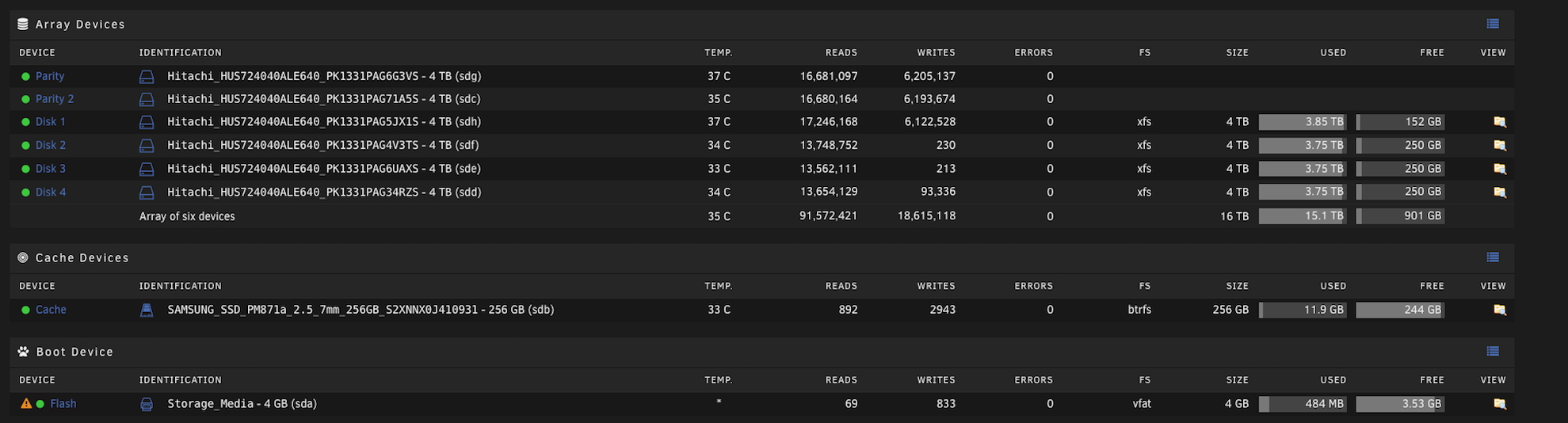

Was running rock solid with i7 3930k 64gb ram and 2x4TB Parity drives, 4x4TB data drives, 1 SSD 256 gb Cache.
New rig is 3700x Ryzen, mobo Asus TUF x5700-Plus, 16GB ram and all the drives from the old pc. i tested the hardware for 6 days with test key and 3 hdd.was stable and no problems at all

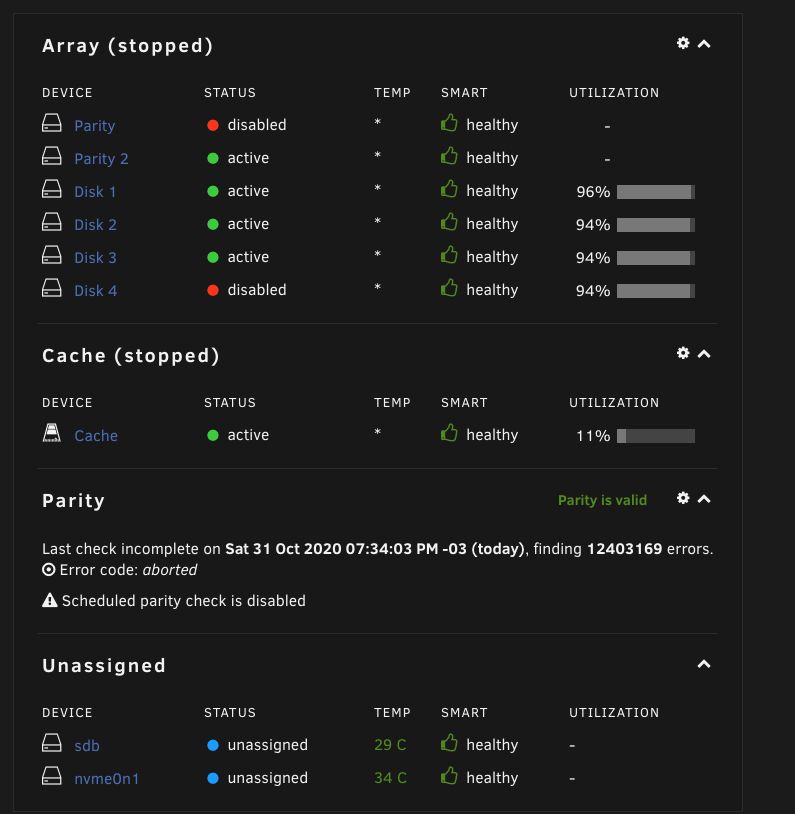

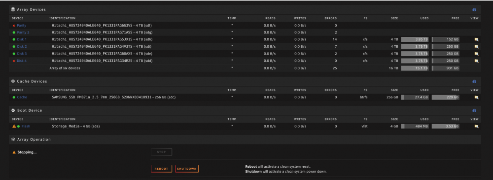

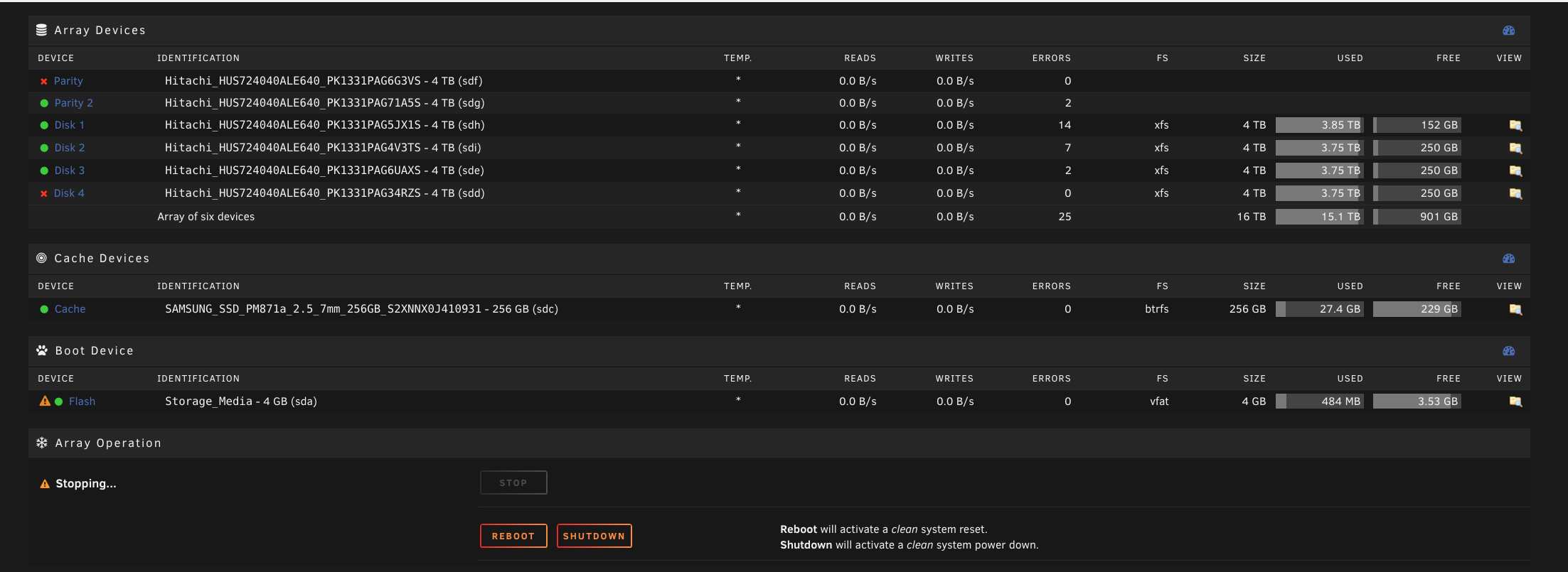

After the migration, all disk was installed in the new rig, Unraid started ok, but when VM started automatically error appears.  i think that for some reason, during the VM start up, the sata controller was passedthrough VM. the sata controller that is used by unraid.
after that i can't access my data and the array has some errors

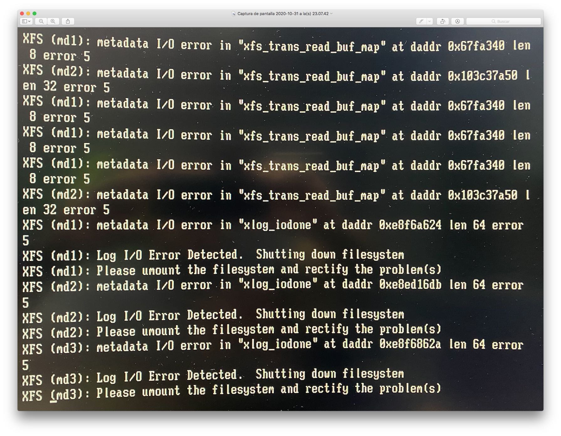

Oct 31 19:32:16 Gideon kernel: md: disk1 read error, sector=1954196440
Oct 31 19:32:16 Gideon kernel: md: disk1 read error, sector=1954196448
Oct 31 19:32:16 Gideon kernel: md: disk1 read error, sector=1954196456
Oct 31 19:32:16 Gideon kernel: md: disk1 read error, sector=1954196464
Oct 31 19:32:16 Gideon kernel: XFS (md1): metadata I/O error in "xfs_trans_read_buf_map" at daddr 0x747aabd8 len 32 error 5
Oct 31 19:32:16 Gideon kernel: XFS (md1): xfs_imap_to_bp: xfs_trans_read_buf() returned error -5.

Oct 31 19:32:44 Gideon kernel: BTRFS error (device sdc1): bdev /dev/sdc1 errs: wr 0, rd 1, flush 0, corrupt 0, gen 0
Oct 31 19:32:44 Gideon kernel: print_req_error: I/O error, dev loop2, sector 0
Oct 31 19:32:44 Gideon kernel: BTRFS error (device loop2): bdev /dev/loop2 errs: wr 0, rd 0, flush 1, corrupt 0, gen 0
Oct 31 19:32:44 Gideon kernel: BTRFS warning (device loop2): chunk 13631488 missing 1 devices, max tolerance is 0 for writeable mount
Oct 31 19:32:44 Gideon kernel: BTRFS: error (device loop2) in write_all_supers:3716: errno=-5 IO failure (errors while submitting device barriers.)
Oct 31 19:32:44 Gideon kernel: BTRFS info (device loop2): forced readonly
Oct 31 19:32:44 Gideon kernel: BTRFS warning (device loop2): Skipping commit of aborted transaction.
Oct 31 19:32:44 Gideon kernel: BTRFS: error (device loop2) in cleanup_transaction:1860: errno=-5 IO failure
Oct 31 19:32:44 Gideon kernel: BTRFS info (device loop2): delayed_refs has NO entry
Oct 31 19:32:44 Gideon kernel: BTRFS error (device sdc1): bdev /dev/sdc1 errs: wr 1, rd 1, flush 0, corrupt 0, gen 0
Oct 31 19:32:44 Gideon kernel: BTRFS error (device sdc1): bdev /dev/sdc1 errs: wr 2, rd 1, flush 0, corrupt 0, gen 0
Oct 31 19:32:44 Gideon kernel: BTRFS error (device sdc1): bdev /dev/sdc1 errs: wr 3, rd 1, flush 0, corrupt 0, gen 0
Oct 31 19:32:44 Gideon kernel: BTRFS error (device sdc1): bdev /dev/sdc1 errs: wr 4, rd 1, flush 0, corrupt 0, gen 0
Oct 31 19:32:44 Gideon kernel: BTRFS error (device sdc1): bdev /dev/sdc1 errs: wr 5, rd 1, flush 0, corrupt 0, gen 0
Oct 31 19:32:44 Gideon kernel: BTRFS error (device sdc1): bdev /dev/sdc1 errs: wr 6, rd 1, flush 0, corrupt 0, gen 0
Oct 31 19:32:44 Gideon kernel: BTRFS error (device sdc1): bdev /dev/sdc1 errs: wr 7, rd 1, flush 0, corrupt 0, gen 0
Oct 31 19:32:44 Gideon kernel: BTRFS error (device sdc1): bdev /dev/sdc1 errs: wr 8, rd 1, flush 0, corrupt 0, gen 0
Oct 31 19:32:45 Gideon kernel: print_req_error: I/O error, dev loop3, sector 0
Oct 31 19:32:45 Gideon kernel: BTRFS warning (device loop3): chunk 13631488 missing 1 devices, max tolerance is 0 for writeable mount
Oct 31 19:32:45 Gideon kernel: BTRFS: error (device loop3) in write_all_supers:3716: errno=-5 IO failure (errors while submitting device barriers.)
Oct 31 19:32:45 Gideon kernel: BTRFS info (device loop3): forced readonly
Oct 31 19:32:45 Gideon kernel: BTRFS warning (device loop3): Skipping commit of aborted transaction.
Oct 31 19:32:45 Gideon kernel: BTRFS: error (device loop3) in cleanup_transaction:1860: errno=-5 IO failure
Oct 31 19:32:45 Gideon kernel: BTRFS info (device loop3): delayed_refs has NO entry
Oct 31 19:32:49 Gideon kernel: btrfs_dev_stat_print_on_error: 6 callbacks suppressed
Oct 31 19:32:49 Gideon kernel: BTRFS error (device sdc1): bdev /dev/sdc1 errs: wr 12, rd 3, flush 0, corrupt 0, gen 0
Oct 31 19:33:10 Gideon kernel: BTRFS error (device sdc1): bdev /dev/sdc1 errs: wr 13, rd 3, flush 0, corrupt 0, gen 0
Oct 31 19:33:10 Gideon kernel: BTRFS error (device sdc1): bdev /dev/sdc1 errs: wr 14, rd 3, flush 0, corrupt 0, gen 0
Oct 31 19:33:10 Gideon kernel: BTRFS error (device sdc1): bdev /dev/sdc1 errs: wr 15, rd 3, flush 0, corrupt 0, gen 0
Oct 31 19:33:10 Gideon kernel: BTRFS error (device sdc1): bdev /dev/sdc1 errs: wr 16, rd 3, flush 0, corrupt 0, gen 0
Oct 31 19:33:10 Gideon kernel: BTRFS error (device sdc1): bdev /dev/sdc1 errs: wr 17, rd 3, flush 0, corrupt 0, gen 0
Oct 31 19:33:10 Gideon kernel: BTRFS error (device sdc1): bdev /dev/sdc1 errs: wr 18, rd 3, flush 0, corrupt 0, gen 0
Oct 31 19:33:10 Gideon kernel: BTRFS error (device sdc1): bdev /dev/sdc1 errs: wr 19, rd 3, flush 0, corrupt 0, gen 0
Oct 31 19:33:10 Gideon kernel: BTRFS error (device sdc1): bdev /dev/sdc1 errs: wr 20, rd 3, flush 0, corrupt 0, gen 0
Oct 31 19:33:10 Gideon kernel: BTRFS error (device sdc1): bdev /dev/sdc1 errs: wr 21, rd 3, flush 0, corrupt 0, gen 0
Oct 31 19:33:10 Gideon kernel: BTRFS: error (device sdc1) in btrfs_commit_transaction:2267: errno=-5 IO failure (Error while writing out transaction)
Oct 31 19:33:10 Gideon kernel: BTRFS info (device sdc1): forced readonly
Oct 31 19:33:10 Gideon kernel: BTRFS warning (device sdc1): Skipping commit of aborted transaction.
Oct 31 19:33:10 Gideon kernel: BTRFS: error (device sdc1) in cleanup_transaction:1860: errno=-5 IO failure
Oct 31 19:33:10 Gideon kernel: BTRFS info (device sdc1): delayed_refs has NO entry
Oct 31 19:33:14 Gideon kernel: BTRFS error (device sdc1): bdev /dev/sdc1 errs: wr 21, rd 4, flush 0, corrupt 0, gen 0
Oct 31 19:33:14 Gideon kernel: print_req_error: I/O error, dev loop2, sector 240160
Oct 31 19:33:14 Gideon kernel: print_req_error: I/O error, dev loop2, sector 764448
Oct 31 19:33:14 Gideon kernel: BTRFS info (device loop2): no csum found for inode 3940 start 0
Oct 31 19:33:14 Gideon kernel: BTRFS info (device loop2): no csum found for inode 3940 start 4096
Oct 31 19:33:14 Gideon kernel: BTRFS info (device loop2): no csum found for inode 3940 start 8192
Oct 31 19:33:14 Gideon kernel: BTRFS info (device loop2): no csum found for inode 3940 start 12288
Oct 31 19:33:14 Gideon kernel: print_req_error: I/O error, dev loop2, sector 8717552
Oct 31 19:33:20 Gideon kernel: btrfs_dev_stat_print_on_error: 38 callbacks suppressed
Oct 31 19:33:20 Gideon kernel: BTRFS error (device sdc1): bdev /dev/sdc1 errs: wr 21, rd 27, flush 0, corrupt 0, gen 0
Oct 31 19:33:20 Gideon kernel: BTRFS error (device sdc1): bdev /dev/sdc1 errs: wr 21, rd 28, flush 0, corrupt 0, gen 0
Oct 31 19:33:20 Gideon kernel: BTRFS error (device sdc1): bdev /dev/sdc1 errs: wr 21, rd 29, flush 0, corrupt 0, gen 0
Oct 31 19:33:21 Gideon kernel: md: disk1 read error, sector=3977861336
Oct 31 19:33:21 Gideon kernel: XFS (md1): metadata I/O error in "xfs_trans_read_buf_map" at daddr 0xed1958d8 len 8 error 5

Oct 31 19:33:35 Gideon kernel: mdcmd (54): check nocorrect
Oct 31 19:33:35 Gideon kernel: md: recovery thread: check ...
Oct 31 19:33:36 Gideon kernel: BTRFS error (device sdc1): bdev /dev/sdc1 errs: wr 21, rd 32, flush 0, corrupt 0, gen 0
Oct 31 19:33:36 Gideon kernel: md: disk1 read error, sector=0
Oct 31 19:33:36 Gideon kernel: md: disk2 read error, sector=0
Oct 31 19:33:36 Gideon kernel: md: disk3 read error, sector=0
Oct 31 19:33:36 Gideon kernel: md: disk29 read error, sector=0
Oct 31 19:33:36 Gideon kernel: md: disk1 read error, sector=8
Oct 31 19:33:36 Gideon kernel: md: disk2 read error, sector=8
Oct 31 19:33:36 Gideon kernel: md: disk3 read error, sector=8
Oct 31 19:33:36 Gideon kernel: md: disk29 read error, sector=8
Oct 31 19:33:36 Gideon kernel: md: disk1 read error, sector=16
Oct 31 19:33:36 Gideon kernel: md: disk2 read error, sector=16
Oct 31 19:33:36 Gideon kernel: md: disk3 read error, sector=16
Oct 31 19:33:36 Gideon kernel: md: disk29 read error, sector=16
Oct 31 19:33:36 Gideon kernel: md: disk1 read error, sector=24
Oct 31 19:33:36 Gideon kernel: md: disk2 read error, sector=24
Oct 31 19:33:36 Gideon kernel: md: disk3 read error, sector=24
Oct 31 19:33:36 Gideon kernel: md: disk29 read error, sector=24
Oct 31 19:33:36 Gideon kernel: md: disk1 read error, sector=32
Oct 31 19:33:36 Gideon kernel: md: disk2 read error, sector=32
Oct 31 19:33:36 Gideon kernel: md: disk3 read error, sector=32
Oct 31 19:33:36 Gideon kernel: md: disk29 read error, sector=32
Oct 31 19:33:36 Gideon kernel: md: disk1 read error, sector=40
Oct 31 19:33:36 Gideon kernel: md: disk2 read error, sector=40
Oct 31 19:33:36 Gideon kernel: md: disk3 read error, sector=40
Oct 31 19:33:36 Gideon kernel: md: disk29 read error, sector=40
Oct 31 19:33:36 Gideon kernel: md: disk1 read error, sector=48
Oct 31 19:33:36 Gideon kernel: md: disk2 read error, sector=48
Oct 31 19:33:36 Gideon kernel: md: disk3 read error, sector=48
Oct 31 19:33:36 Gideon kernel: md: disk29 read error, sector=48
Oct 31 19:33:36 Gideon kernel: md: disk1 read error, sector=56
Oct 31 19:33:36 Gideon kernel: md: disk2 read error, sector=56
Oct 31 19:33:36 Gideon kernel: md: disk3 read error, sector=56
Oct 31 19:33:36 Gideon kernel: md: disk29 read error, sector=56
Oct 31 19:33:36 Gideon kernel: md: disk1 read error, sector=64
Oct 31 19:33:36 Gideon kernel: md: disk2 read error, sector=64
Oct 31 19:33:36 Gideon kernel: md: disk3 read error, sector=64
Oct 31 19:33:36 Gideon kernel: md: disk29 read error, sector=64
Oct 31 19:33:36 Gideon kernel: md: disk1 read error, sector=72
Oct 31 19:33:36 Gideon kernel: md: disk2 read error, sector=72
Oct 31 19:33:36 Gideon kernel: md: disk3 read error, sector=72
Oct 31 19:33:36 Gideon kernel: md: disk29 read error, sector=72
Oct 31 19:33:36 Gideon kernel: md: disk1 read error, sector=80
Oct 31 19:33:36 Gideon kernel: md: disk2 read error, sector=80
Oct 31 19:33:36 Gideon kernel: md: disk3 read error, sector=80
Oct 31 19:33:36 Gideon kernel: md: disk29 read error, sector=80
Oct 31 19:33:36 Gideon kernel: md: disk1 read error, sector=88
Oct 31 19:33:36 Gideon kernel: md: disk2 read error, sector=88
Oct 31 19:33:36 Gideon kernel: md: disk3 read error, sector=88
Oct 31 19:33:36 Gideon kernel: md: disk29 read error, sector=88
Oct 31 19:33:36 Gideon kernel: md: disk1 read error, sector=96
Oct 31 19:33:36 Gideon kernel: md: disk2 read error, sector=96

This is the array in the old rig
927922692_Capturadepantalla2020-10-31ala(s)22_43_28.thumb.png.2c2b9111a571ccd4c7f2d8012e03128d.png
Array in the new rig,
1643384691_Capturadepantalla2020-10-31ala(s)22_44_58.thumb.png.16649af6fa9d64a5fab11e9c39ea879d.png
Once the array was started i can not stop again.

822033635_Capturadepantalla2020-10-31ala(s)22_50_30.thumb.png.8cfc81d6a07732dccb0ba0f7b68f39b1.png
 i think my problem is related to the cache drive. but now the drives disabled are parity 1 and disk 4. if i remove those disk in theory the array need to start in emulated mode with no data loss.
but i wanted to know if i need to check manually the XFS file system
also in the console monitor this messages appears.

yes, but now the arrays has errors, XFS,  and don't start up. need to solve that corruption first then edit de VM xml or create new ones
Finally solved the problem.
1- complete several checks and repairs to the disks. but error always persists when the array mounted.
The x570 was tested with 3 drives and 1 m2 nvme. no problems at all. system was very stable. but when i moved the disks, the 8 sata ports on the Mainboard was in use, plus the m2 nvme.
In others asus mb i see in the documentation that if you use m2 slots there are some sata ports that are disabled.
According to my documentation on the x570, does not mention any sata ports disabled on any condition.
According to the bios, the 8 sata ports was detected with no issues and also the m2 nvme drive.
But when unraid try to mount the arrays the errors appears. and the data of the disk are not accessible.
Finally i removed the m2-slot drive, booted with 8 sata ports in use 6 hdd + 2 SSD. bios check, all disk are detected and unraid  now mount the array with no problems
I complete the check xfs on all disk.
Parity 1 ok - shows disabled
Parity 2 ok - shows ok
Disk 1 ok - shows ok
Disk 2 ok - shows ok
Disk 3 ok - shows ok
Disk 4 ok - shows disabled.
I stop again the array
unassign disk 4
start the array again
Array mounted with disk 4 emulated
stop the array
Assign again the disk 4
Start the array again.
Now the rebuild process was started and content of disk 4 its being emulated.
I have no more errors on the console about i/o errors, or xfs problems.
rebuild is about 30% complete. and after that i need to do the same operation with the parity 1 disk that still shows bad and disabled.
i need and LSI card to add more hdds to the system. i have 3 more slots for 3.5 disk and 2 slots for 2.5. Plus the Mainboard having 2 m2 slots empty now.
Server is up and running again.
