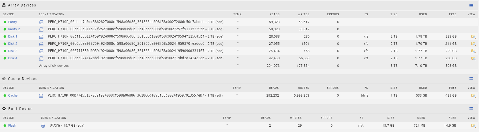

I am running into a problem assigning a 8TB drive to my data drive pool.
Recently I bought two HGST HUH728080AL4200 (8TB drives) orginally they are formatted in 4kn sectors, but because my PERC H710P Mini does not support this format I reformatted them to 512 sectors.
My current setup is shown in the picture below:
The problem is that when I try to move parity drive (1 or 2) to the data pool it says the biggest drive is not a parity drive.

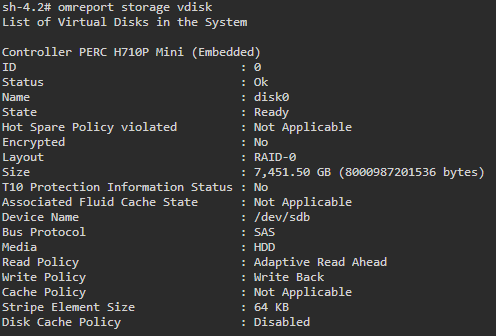

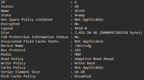

Omreport reports that both drives are exactly the same size as shown in the pictures below:
I really hope someone is able to help!
