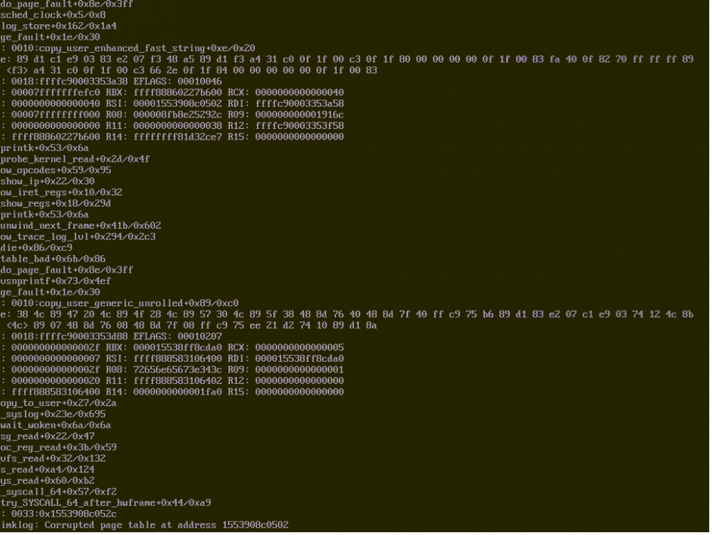

I solved the Issue by changing the RAM-Sticks to one known good RAM-Stick.
I still don't know why the Kernel Panic messes up all the Network-Connections at the Switch.

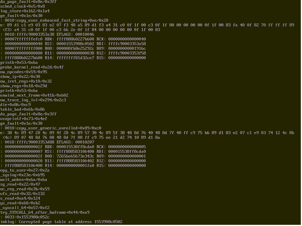

I unplugged the Unraid-Server from ethernet and connected to my KVM-Switch just to see an kernel panic. So I guess its memtest-time.
