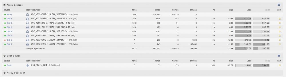

When pre-clearing two new 12tb drives, one drive generated 1024 errors and cannot be mounted - see attached images and diagnostics. Could this be a cable issue or is it likely to just be a straightforward faulty disk that needs RMA'ing?

26 minutes ago, BlackBriar said:
When pre-clearing
FYI that was clearing, pre-clearing means clearing outside the array.
Disk dropped offline, most likely a connection issue, but since there's no SMART more difficult to say, check connections and post new diags.

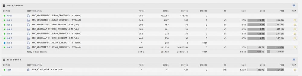

I started moving files onto the array, and everything seemed fine, so left it for a couple of hours. When I came back, both this drive, and the other 12tb drive I added recently, are displaying errors - see image attached.
I am assuming now that this is the SATA card i'm using (Ziyituod (https://www.amazon.co.uk/gp/product/B07T8XNQT6/ref=ppx_yo_dt_b_asin_title_o06_s00?ie=UTF8&psc=1)) or I need new sata cables, but I would have assumed if the cables were faulty it would be a binary issue.

That controller uses a SATA port multiplier and is not recommended.
Given the errors I have described above, it that a likely source of the problems?
It's possible, even likely:
Nov  9 05:07:22 Teletran kernel: ata7.15: limiting SATA link speed to 3.0 Gbps
Nov  9 05:07:27 Teletran kernel: ata7.15: softreset failed (1st FIS failed)
Nov  9 05:07:27 Teletran kernel: ata7.15: failed to reset PMP, giving up
Nov  9 05:07:27 Teletran kernel: ata7.15: Port Multiplier detaching
Nov  9 05:07:27 Teletran kernel: ata7.00: disabled
Nov  9 05:07:27 Teletran kernel: ata7.02: disabled
But can also be a cable issue.
