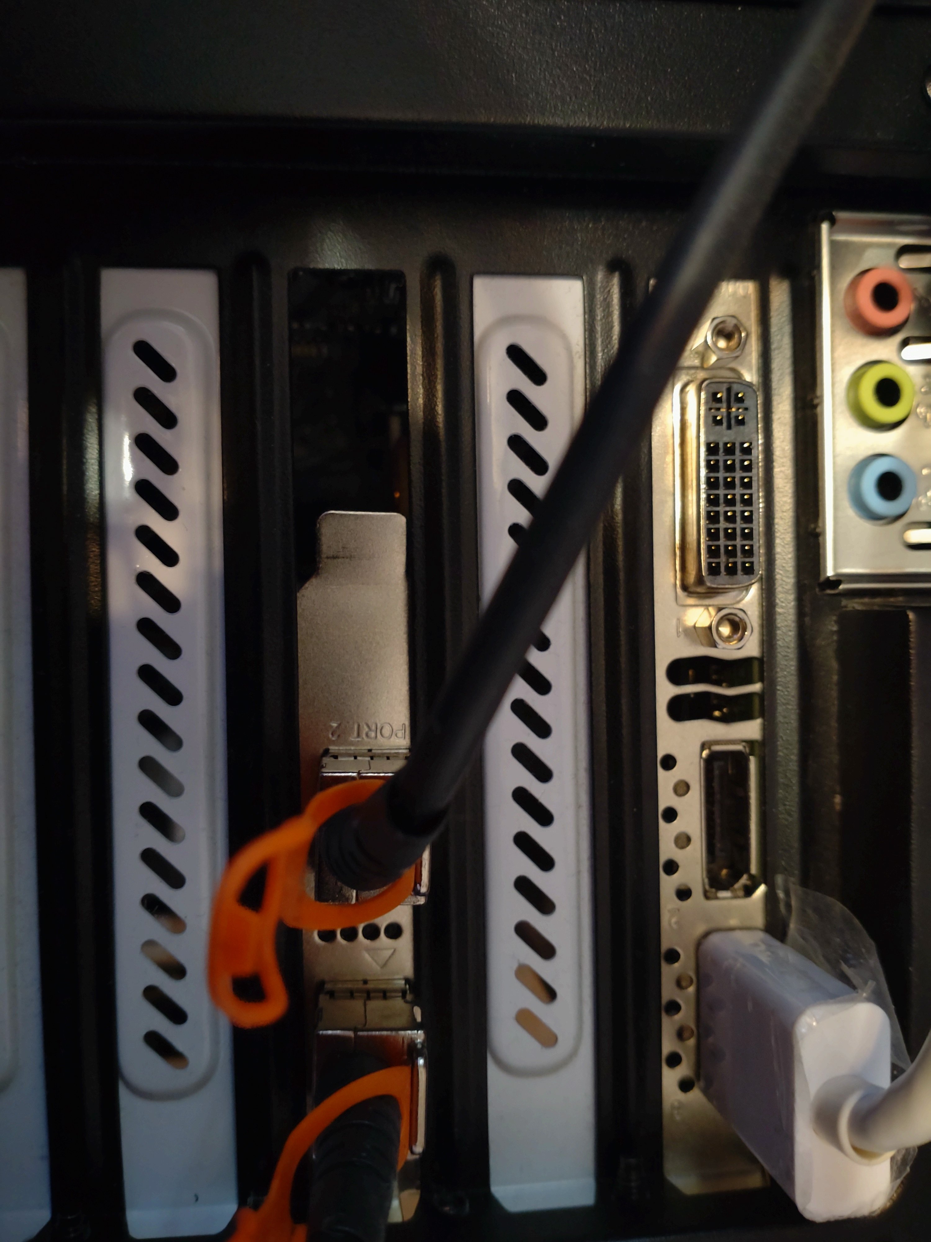

  • I have a https://www.startech.com/en-gb/cards-adapters/pex1to162 with IBM Connectx3 flashed to latest Mellanox Firmware.   Mellanox Network Card: Temperature: 39 °C Info: FW Version: 2.42.500

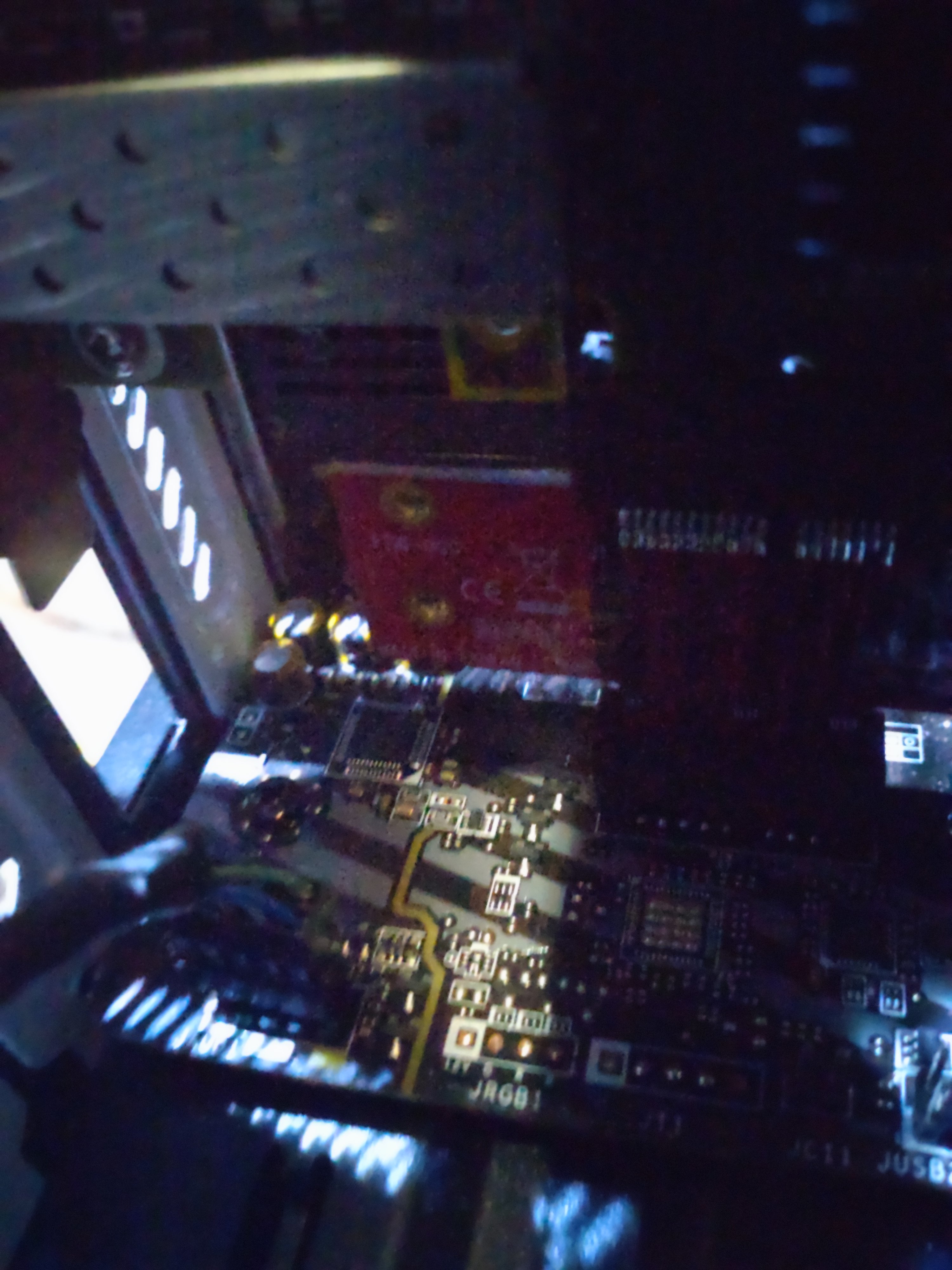

@SimonF I saw some pictures, but I would appreciate a pic if its easy for you.
I saw another item, this one, that has the plate I think you're referring to.
Is it much of an issue without it, I guess its secure with the usual bracket screw?
Edit: Looks like the metal bracket wouldn't fit the X1-to-X16 riser anyway.

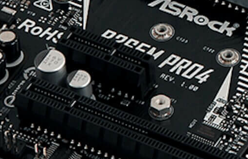

Its possible with an open x1 slot (like on my ASRock board) because the cards have all PCIe 3.0 x4 interfaces - but with speed reduction.
See this link for the speeds https://en.wikipedia.org/wiki/PCI_Express
You can see that a PCIe 3.0 x1 can handle 985MB/s - not really less compared with max. 1250MB/s a 10GBit-NIC can handle.
When i move data to my server over the Asus 10GBit NIC, i reach between 950MB/s and 1100MB/s.

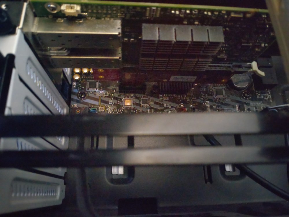

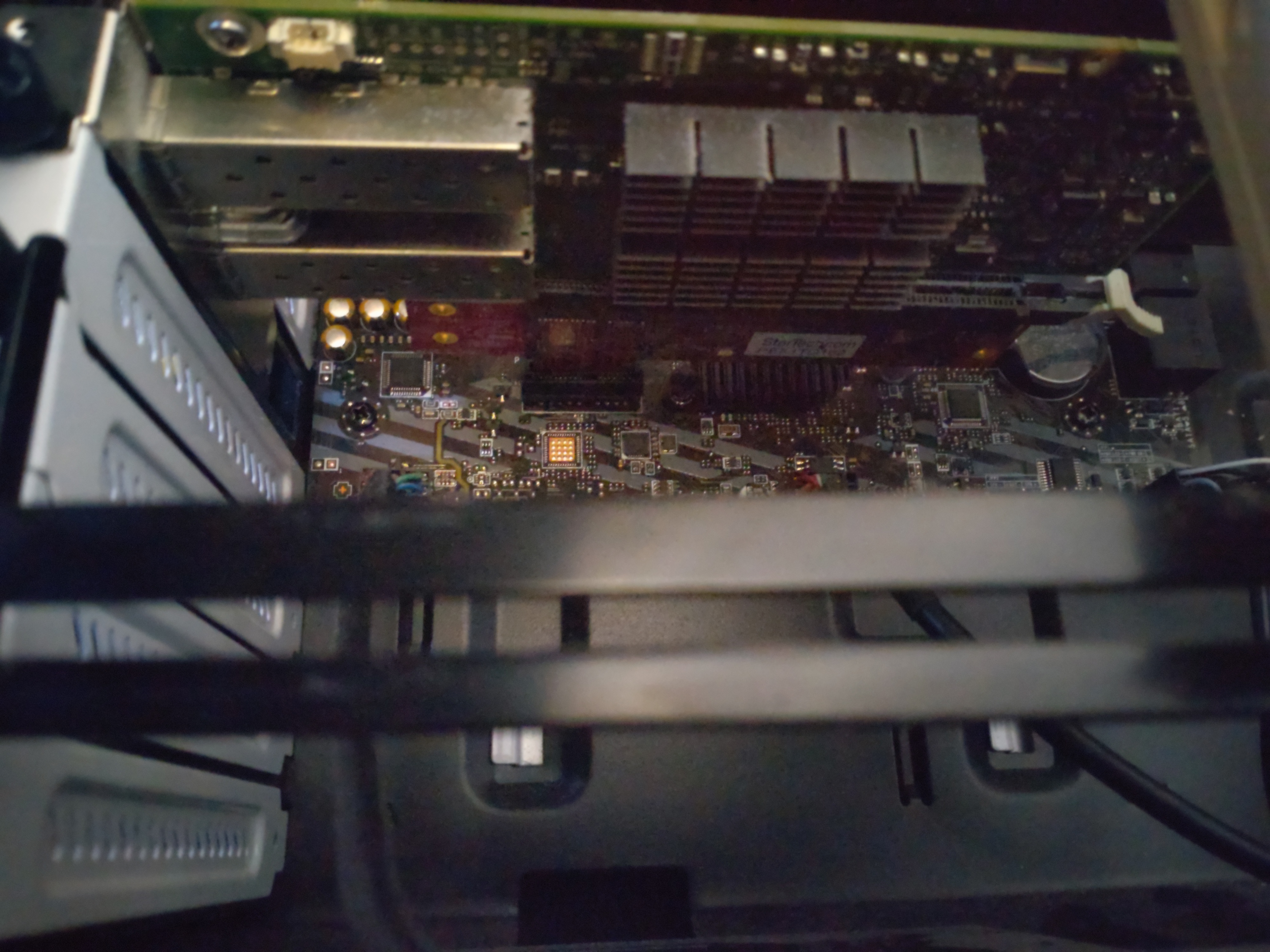

Pictures are not great. IBM Mellanox ConnectX-3 Dual Port 10GB SFP Adapter Card 00D9692_HH is the card.
Edited by SimonF
@Ford Prefect Thanks so much for the pictures, these are perfect for what I was wondering about.
The riser looks like its doing a great job, glad I ordered 2 already.
I didn't realise until seeing the pics that you're using a dual-port 10Gb card.
