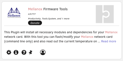

Also, check the Firmware of the cards. @ich777 does have a tool lying around somewhere.
Edit: a tool for flashing/upgrading a mellanox card, I mean.
That sounds useful.

That sounds useful.
There you go (since 6.9.0-beta23 in the CA App):
On the plugin page is a Guide to flash the cards, crossflash, remove the boot ROM and you also can change the mode if you are running Mellanox Infniband Cards to Ethernet if they support it, but please keep in mind that these are the open source Mellanox Firmware tools and they all start with mst... and not only with flint like the most tutorial mention, but this is basically the same. ;)

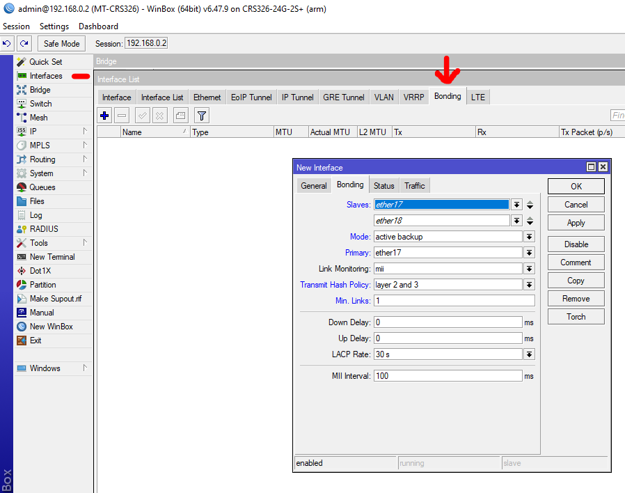

- OK, so the bond is *active* backup....active means, that there should be some "management" between them, which cannot take place when ports are across switches. The CRS on RouterOS definitely has a separate config for this, where you should declare the Master-port as well.
Edit2: forget this, that setting is for a bond setup in the main switch, faning out to others.
- I'd gather you did not check the default config of the CRS, when in RouterOS mode (should be the default OS booting, for a CRS).
  Maybe the bridge setup is not fully configured. As said, RouterOS is a bit of a learning curve.
Edit: OK, thinking of it, the bond0 - meaning the 10G+1G has a single same MAC (that of the first NIC, master = eth0 = 10G). I thing your loosing performance on SRTP between the switches, each seeing the same MAC (CRS for 10G and CSS for 1G). The fact that this is not as bad, is that there is a 10G link between CRS309 and CSS610. But I think some packets might be flowing in cicles ;-)
See Edit2 above....this should not impose problem...however, the performance is a bit too slow.
You should try and disable the bond0 for a first start. Then test again.
Yeah it's setup as an active-backup configuration.
I've still got the CRS running in RouterOS bridge mode, as I haven't yet moved my WAN router and that does my WAN routing pretty well at this point. I can't seem to setup the active-backup bond though, as the bridge mode throws an error:
Something else I'm having trouble with, I went and purchased a couple Ubiquity 1Gb RJ45 transceivers but they seem to not be recognised at all by the CRS309. I was trying to test bond by having everything on the same switch. I may have goofed. Are these not compatible:
This is my next move, I haven't had much chance to bring everything down and play around until today.
Will post back those results.
Edited by KptnKMan
Oh something I forgot to mention above.
I installed the Mellanox Firmware Tools and got the details of my cards:
unraid1:
unraid2:
The cards should be identical as well, but it seems they have different firmwares and also versions.
Thing is, I've been to the Mellanox ConnectX-3 firmware download page, and I'm a little confused which firmware to download:
Would the different firmwares be responsible for the performance behaviour I've been experiencing?
@KptnKMan ...sorry, i am on the road, and the post are hard to manage on my Phone.
RE bonding Mode....check the bridge setting. All interface, that are to be Part of a bond will need to be removed from the bridge first. Check bridge- bridge Ports.
Then under Interfaces create the bond.
After that, add the newly created bonding interface to the bridge.
MT is said to be very tolerant regarding modules and brands, but you never know. One cannot test all variants out there, can't they?
You should see the parameters and status of the module under interfaces.
If it is not shown at all, you are goofed...try an another brand.
But upgrade ROS to the latest stable first, as a last resort.
If it is shown there, but does not sync, disable auto- negotiation and force/enable a 1G link only.
Gesendet von meinem SM-G780G mit Tapatalk
Oh, these are IBM cards, please read the cross flashing guide on how to flash them with the stock Mellanox firmware and also research what firmware do you need for those cards.
A quick google search for the PSID number should do the trick.
I also recommend removing the BIOS from the cards after flashing them to speed up boot times. ;)
Thanks for the advice, I managed to test the cards today, but I need to do some more testing of the Ubiquity 1Gb transceivers. So far though, I couldn't get them to be recognised at all in the CRS309, they don't seem to show up from what I can see. I'm going to try them in one of the CSS610s and see if they are recognised there at all.

This is what interfaces on my CRS326 look like:
notice, that L2 MTU is shown with higher numbers (where L3 MTU is 9000 and 1500 respectively).
