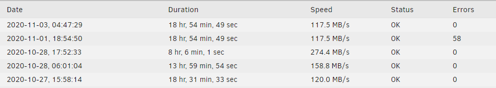

Everything went normal. No parity errors or anything during this process. Now here's my parity check log for the past 5 days:
Nr        Date                    Duration                Speed        Status    Errors
1        2020-11-03, 04:47:29    18 hr, 54 min, 49 sec    117.5 MB/s    OK        0
2        2020-11-01, 18:54:50    18 hr, 54 min, 49 sec    117.5 MB/s    OK        58
3        2020-10-28, 17:52:33    8 hr, 6 min, 1 sec        274.4 MB/s    OK        0
4        2020-10-28, 06:01:04    13 hr, 59 min, 54 sec    158.8 MB/s    OK        0
5        2020-10-27, 15:58:14    18 hr, 31 min, 33 sec    120.0 MB/s    OK        0
(if the above is not readable due to formatting, i have included a screenshot in the attachments)
I added a "nr" column to be able to name it here. So here's what's going on:
  • Looking at the delivery date of the two new drives, Nr 5 is the original parity rebuild that i described in step 5 above.
  • Nr 4 is a parity check described in step 7 above.
  • I am honestly not sure what nr 3 is. The speed is suddenly much higher and the duration much lower. I do not know what caused this and i do not know what this parity check is and why it was performed.
  • Nr 2 is the monthly first day of the month parity check, suddenly with 58 errors. I changed absolutely nothing between the first 3 parity checks and the monthly one. The server didn't power off, and i did not change any settings or anything. Auto correct errors was ON so it corrected them (which i later read is not always a good idea).
  • I performed another parity check to see if more errors would occur immediately after, which has 0 errors again. This is nr 1 in the list above.
What is the explanation for this? Why is there suddenly 58 errors in the scheduled check but is nothing wrong with my own manual checks? Do i need to be worried? How do i make sure really nothing is wrong? I have included the diagnostics in the attachments of this post as well.

These issues aren't easy to diagnose, I would start by running memtest for a few hours, ideally at least 24, if no errors run a couple of more checks.
