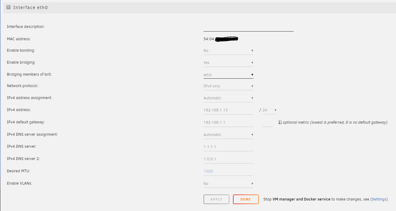

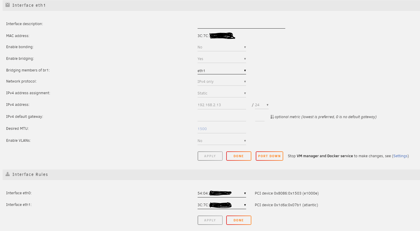

Windows 10 PC has an Asus Maximus XII Hero with a built-in 5GbE ethernet port on the back. Unraid server has an ASUS XG-C100C 10GbE PCI-E card (& is running version 6.9.0-beta30). They are connected via Cat 7 ethernet cable. Both Windows and Unraid can see they're connected by 5GbE in the Ethernet Status window on Windows and on the Dashboard in Unraid.

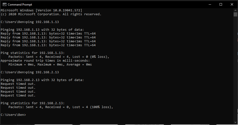

I am able to access the shares on Windows via 192.168.1.13 but not via 192.168.2.13 which should be connecting to the Unraid server using the 5GbE network. Windows will just hang if I try to Add Network Location before eventually saying "The folder that you entered does not appear to be valid. Please choose another."
If I try to ping from Windows it works fine for 192.168.1.13 but will time out and fail for 192.168.2.13. If I try to ping from Unraid using the 10GbE NIC (eth1, as detailed in the written tutorial on the 2nd link) I get a single line result saying "PING 192.168.1.83 (192.168.1.83) from 192.168.1.13 eth1: 56(84) bytes of data." - To be honest I'm not sure if this is all that should show up or if there's anything more.
I am totally new to Unraid and I am now totally lost & confused as to what on earth I have to do to get this working correctly. These tutorials make out like it's oh so simple, but I cannot for the life of me figure out what on earth is going wrong. Please can somebody help?

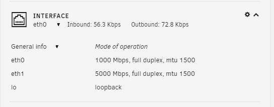

You can't have the same IP on both 5GbE NICs.
Sorry, what? All of the stuff I've seen says that you need to set the same IP on both of the 10/5GbE NICs.
So you're saying I need to change one to, say, Windows to 192.168.2.13 and Unraid to 192.168.2.14? Either I've totally misunderstood the tutorials, which very well might be true, or that can't be right...
You can never have two devices with the same IP address in the same subnet.  How could things be properly routed between them or from other devices if they have the same address?  Which one does the router pick as the destination for the traffic?
It is possible that devices can share an IP address in certain link aggregation or hot failover configurations, but, neither is a case of the two devices needing to communicate with each other or separate devices independently.

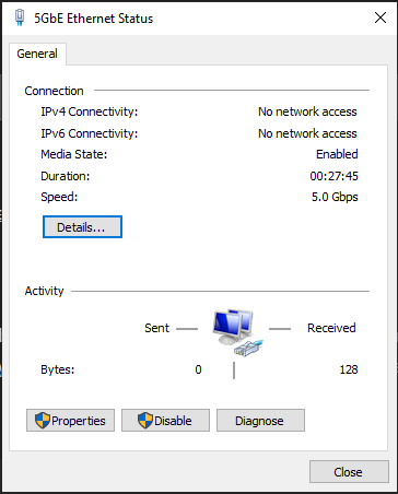

Curious where you saw that...

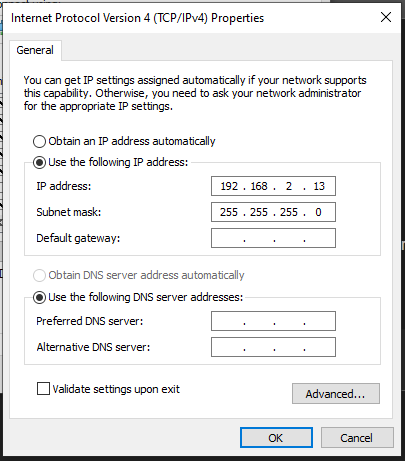

Okay so this is a good example of where, as I said, I might have got something wrong.
So I've just gone back to SpaceInvaderOne's video and at 10:30 he puts the Unraid server as 192.168.11.199. Then at 16:49 he sets setting in Windows to be 192.168.11.197
Clearly I was not paying enough attention both auditory and visually as I thought he put .199 for both.

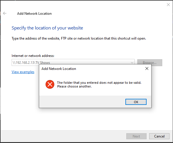

So I've just gone in to the 5GbE adapter properties on Windows and changed that to 192.168.2.12 and you know what... that appears to have worked! haha
Atleast to an extent. I can add a network share, it asks me to log in, I can then map the share to a drive letter and access my files as you would expect. However some quick tests I've just done copying a movie from Unraid to Windows via 1GbE and then via 5GbE, then copying a movie from Windows to Unraid by 5GbE then via 1GbE all seem to get very similar results of approximately high 80s - 110ish MB/s.

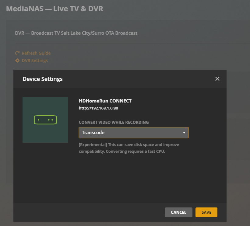

Also, I was going to open a separate thread but maybe you can help me with this, since doing all of what we've discussed today I'm now getting a share show up in Windows called "cache" which appears to me as though the cache drive has for some reason now become it's own share? All of the folders within / shares on the cache drive (ie domain, appdata, system) are all set to "Yes (Hidden)" so none of them should be visible, and they're not when you open the IP in explorer and view the possible shares, but if you open the cache folder there they are. If you can understand what I mean? This definitely wasn't there earlier. How I hide it again?
15 minutes ago, VisualHudson said:
where would I then set "Convert Video While Recording" to Transcode?
I have the remove commercials setting enabled in the Plex DVR as well so after recording it post-processes and removes commercials.  The above setting also creates smaller files than the raw .mt2s from an OTA record.

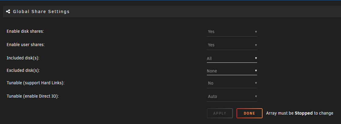

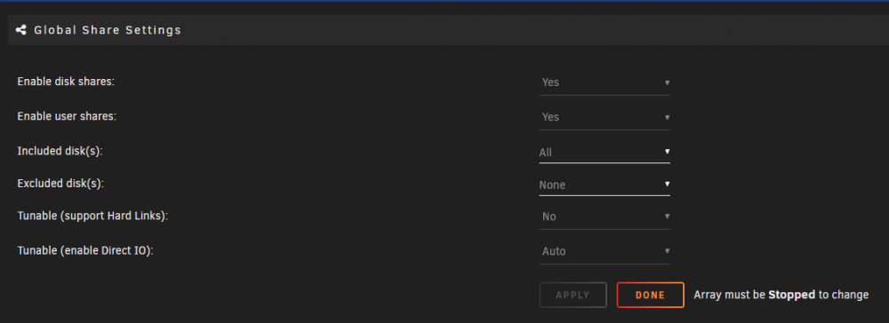

You wouldn't have an idea about why that cache drive is showing up as a share, would you?
And yeah I'm aware that we're very very off topic now, but I do very much appreciate having you here to help me today and so quick with your responses too. If I could show you my gratitude I would!! It's very nice to have someone a lot more knowledgeable than I helping me to get along and learn this whole new world of Unraid haha
3 minutes ago, VisualHudson said:
To edit the 'go' file I assume I'd just have to view the flash drive as a share in Windows, go to config, then open and edit the file using notepad then just save it. Right? Would I need to include:
#Setup drivers for hardware transcoding in Plex
modprobe i915
sleep 4
chown -R nobody:users /dev/dri
chmod -R 777 /dev/dri
Yes, that's how you edit the go file.  The lines above in the go file are because my CPU has an integrated GPU and I am using that for hardware transcoding in Plex and this sets up the drivers for doing that.  If you do not have an Intel CPU with iGPU, those lines are of no use to you.
Your cache drive is showing up as a share because you have disk shares enabled and you are exporting the cache disk.  I am doing this intentionally because I want direct access to the cache share as I store some temporary downloads there.
