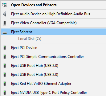

Due to issues with my AMD mobo (ASROCK TRX40 Creator) not playing nicely in passing through USB, I've only been able to pass through one USB C port on the mobo itself, and also a standalone PCIe USB controller. This all works but I've seen some very strange behaviours with USB devices:
Two separate USB hubs, one plugged into the USB C, and one into the USB 3.0 card have both died within days of being plugged in. Could be coincidence, but seems strange.
Trying to plug an external DAC in and using in 5.1 mode, throws up a "not enough USB controller resources" error. That's even when nothing else USB is plugged in, and I've tried on both controllers
When using MS Teams, as soon as I turn on my Bluetooth headset and it uses "headset" rather than "headphones" for audio my keyboard stops working. It's powered, Logitech Options still thinks it's connected, but it won't register key strokes. As soon as switch my Teams audio to another device it works fine again.
Passed through devices such as the NVMe drive, the VGA controller etc. all show up as ejectable USB devices, is this normal?
A quick tentative experiment with 6.9 beta seemed to show it resolved the issue around passing through other onboard USB, and also allowing proper passthrough of on-board audio (rather than as a "Generic USB Audio", so I'm half tempted to try it, but twitchy as this is my one and only server not a test bed.
Frustrating when I feel I'm close to the W10 VM being a viable daily driver/gamer.
