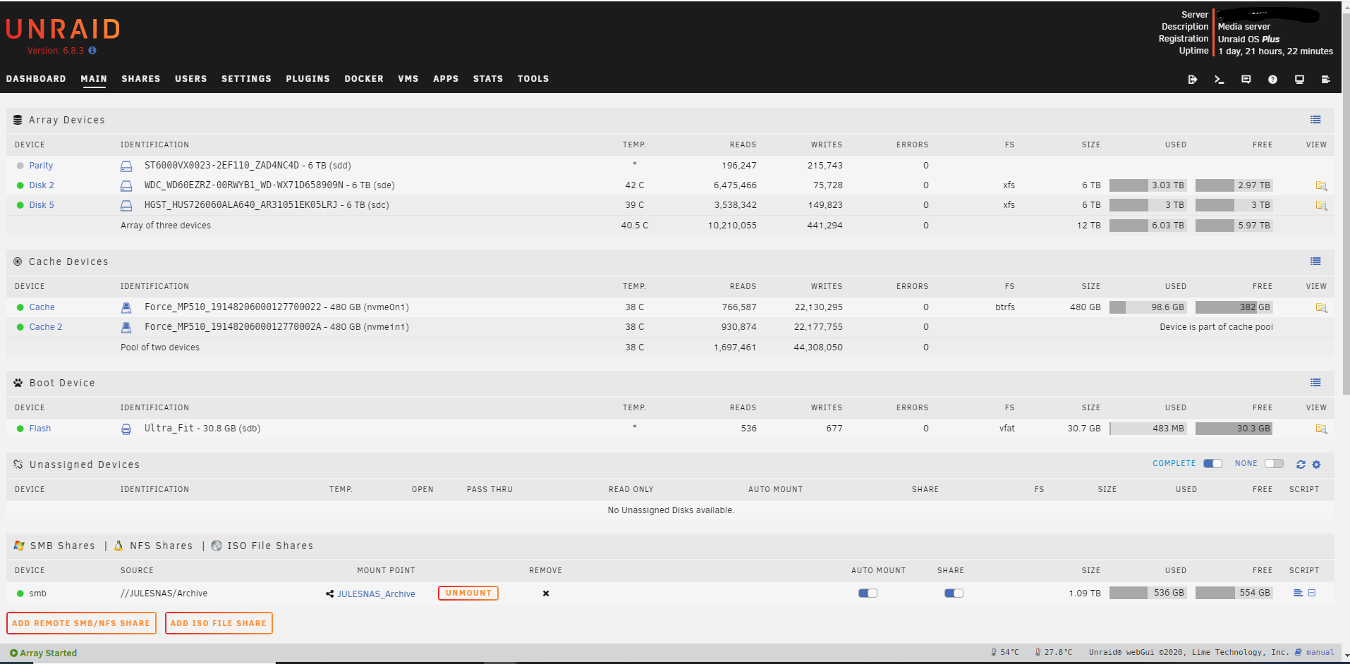

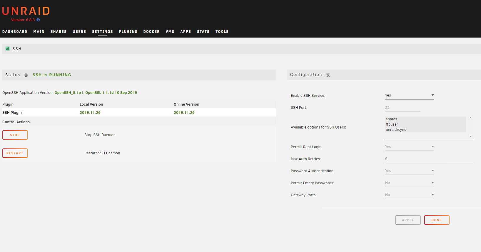

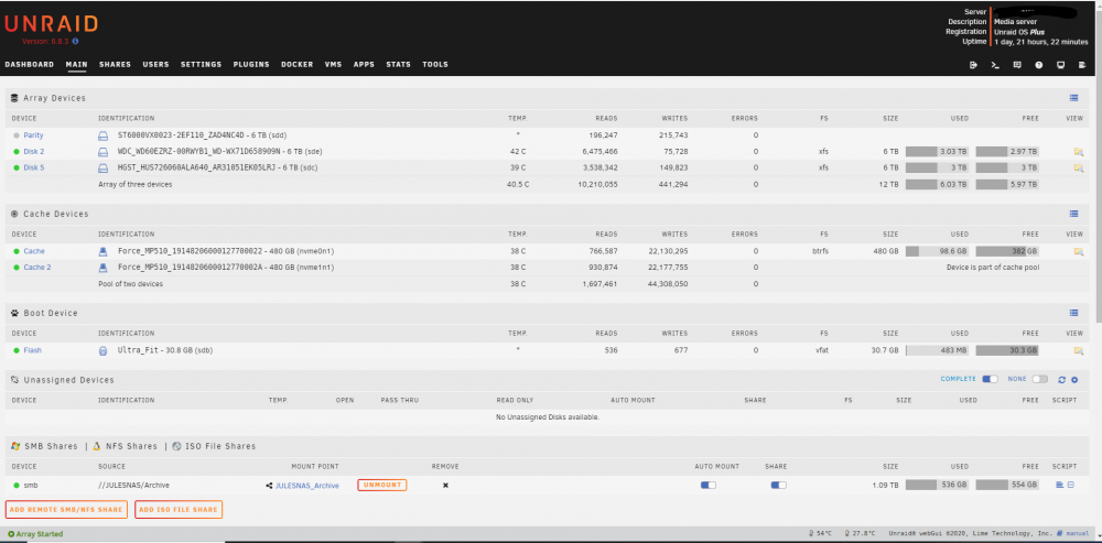

I've added screen shot of UnRaid showing what I have.

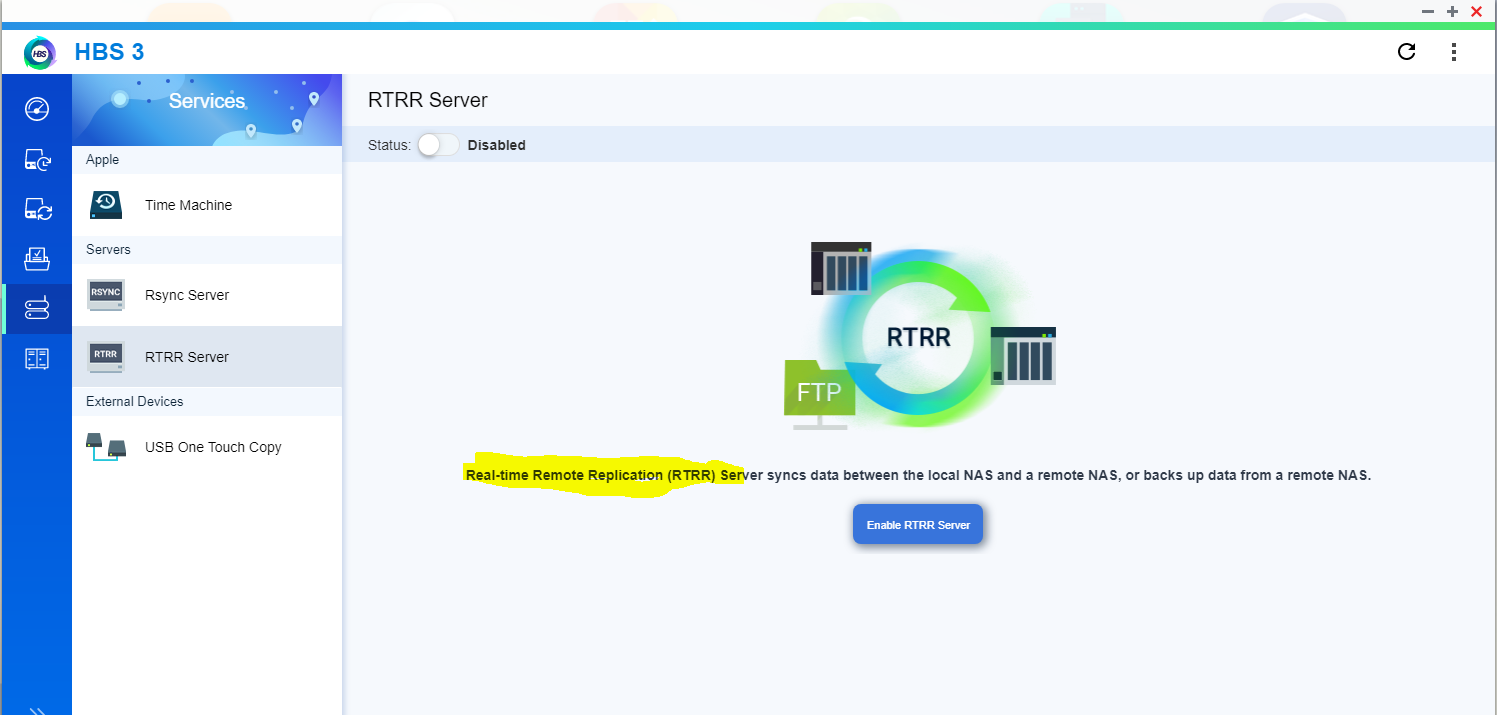

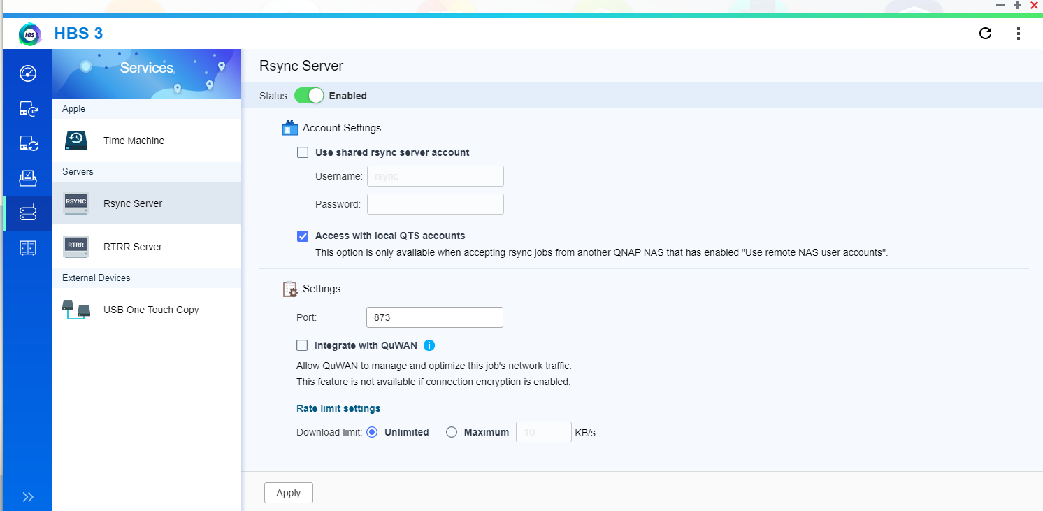

I've added screen shot from QNAP Hybrid back (HB3) that support RTRR (real-time remote replication ) and Rsync - Asking for guidance how to enable RTRR or Rsync to my UnRaid please?

23 minutes ago, huntjules said:
RTRR to my UnRaid please?
And what is RTRR?
Hi Johnnie. RTRR stands for Real-Time Remote Replication. But I think I actually meant enabling RSYNC.. I'll update the topic and ticket
That's not something that exists in Unriad, rsync you can use.

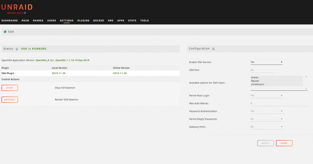

Thank you. Any guidance how i enable Rsync please? I've setup SSH already
Rsync the command doesn't need to be enable, if you mean rsync server then don't know, never needed that, but if you search the forum or google it you should get multiple hits.

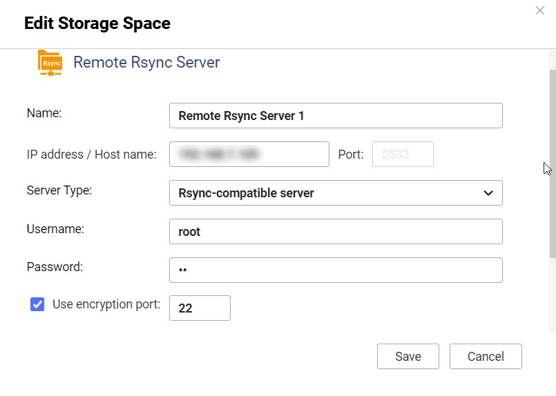

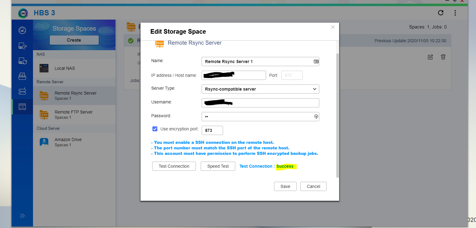

All setup now. Unraid already supported rsync. I just had to configure the QNAP remote end with correct user share credentials, SSH, encrypted port number and fiddled with QNAP drop down menu options and after a few options were tried, on 4th QNAP option, the qnap could see UnRaid shares.
If others interested, screen snip below of what options got working for me

On UnRAID SSH is enabled by default.
QNAP probably requires SSH to be enabled in the GUI somewhere. EDIT: https://wiki.qnap.com/wiki/How_to_SSH_into_your_QNAP_device

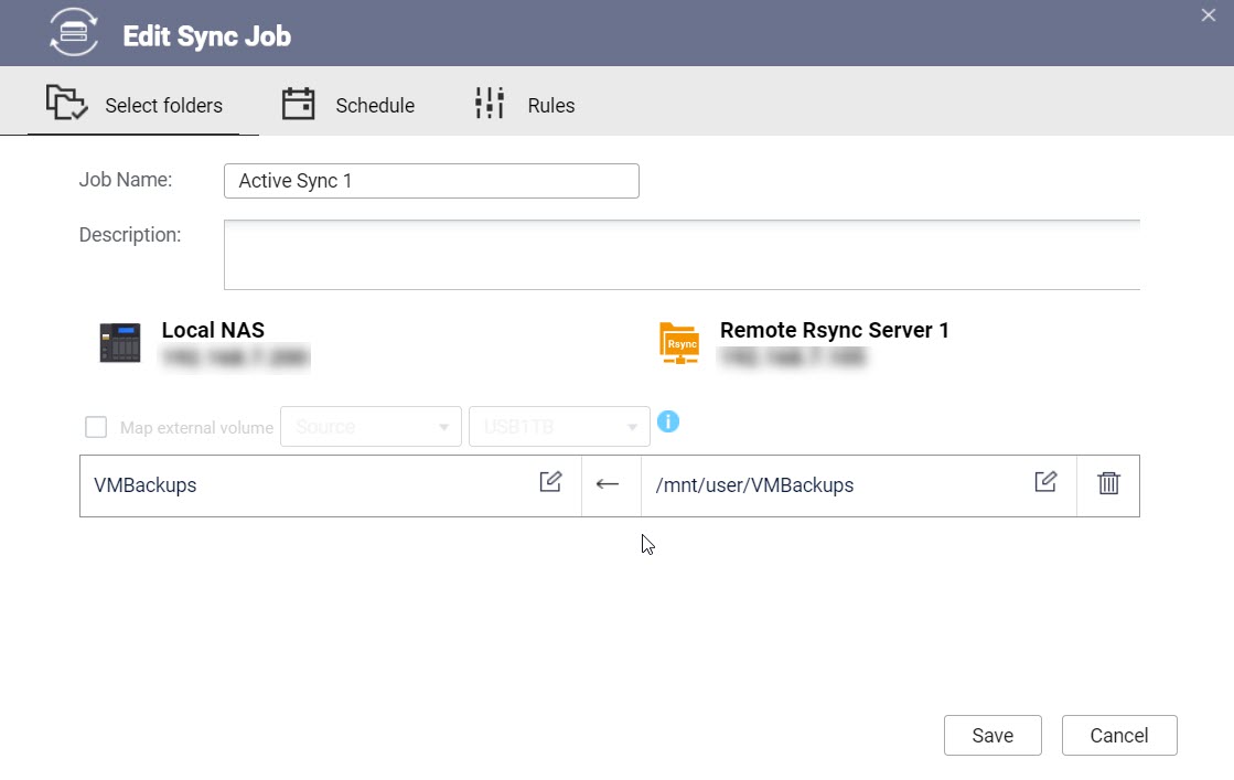

The SSH guide that @weirdcraphas mentioned has go to do with logging into QNAP via SSH. You don't need that. I have a similar setup as @huntjules where I required VM Backups folder copied over to my QNAP. At first was a bit of a hustle but realized it was my own "thinking-too-technical" brain misleading me-there really isn't much setup to do. Simply setup Rsync in HSB 3 using the "Active Sync Job" mode, this has the QNAP pull the files FROM Unraid, the other two options will send TO Unraid. Select 'Remote Rsync Server' and fill in the details. Username and Password are your Unraid login credentials and remember to check 'Use encryption port' which is 22. Test the connection then proceed on to select your folders/directories while completing the rest of the setup. That's all😊
A heads-up: the sync process may take a while depending on the size of the source file. Seems QNAP will 'cache', like how Download manager does when downloading, and it'll seem like the sync process is stuck. Be patient.
