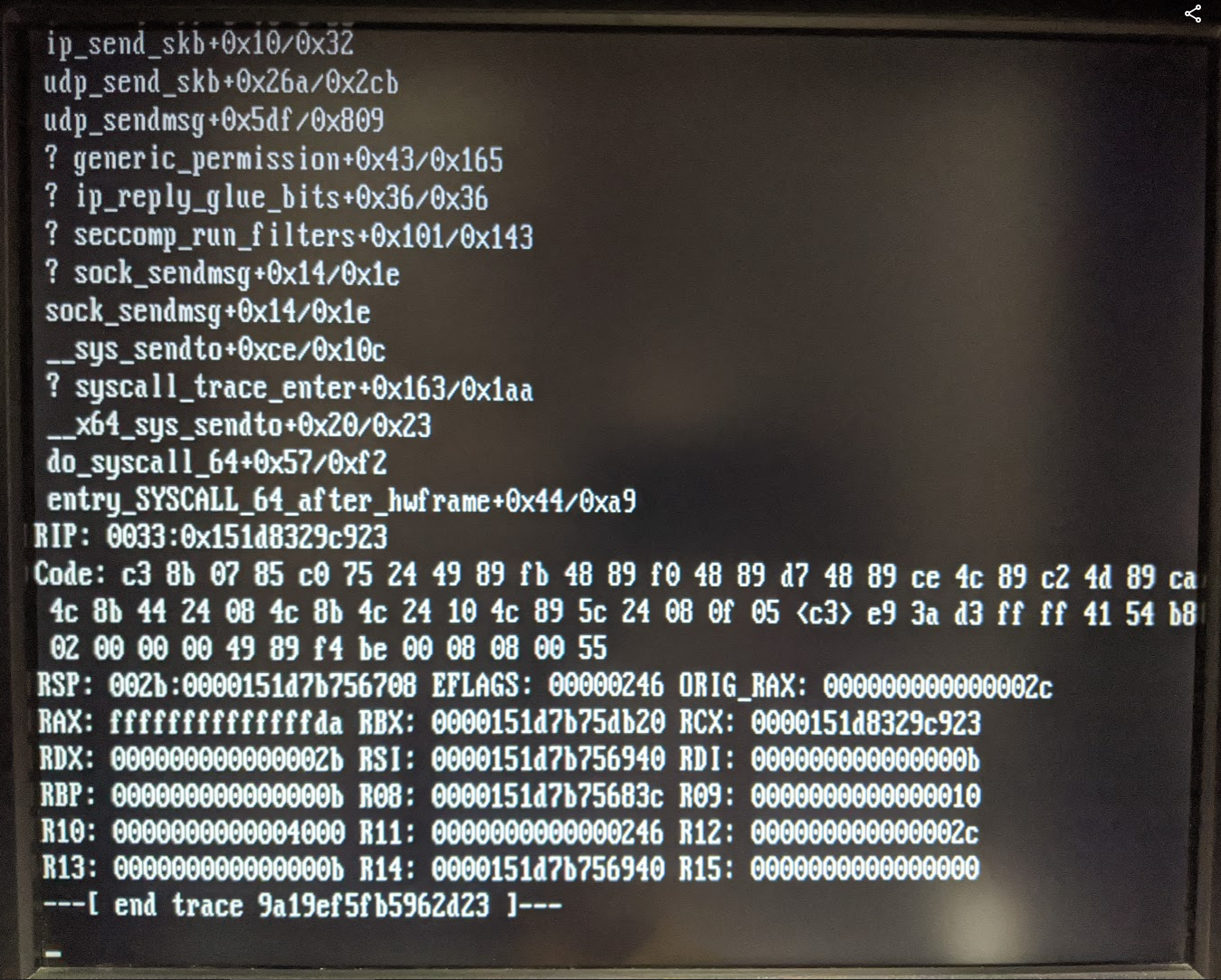

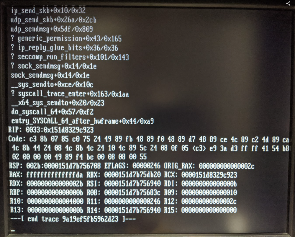

I've had Unraid running for a little while now on a Dell R510 (first time with Unraid), but I'm getting a random crash every 2-7 days.
I have been slowly disabling dockers, VMs, but I'm at a loss as to what is causing the crash.
tower-diagnostics-20201104-1234.zipsyslog
The WebUI becomes unresponsive, I cannot SSH in, and the physical terminal is frozen.
I will include a photo of the monitor, diagnostics, and the mirrored syslog.

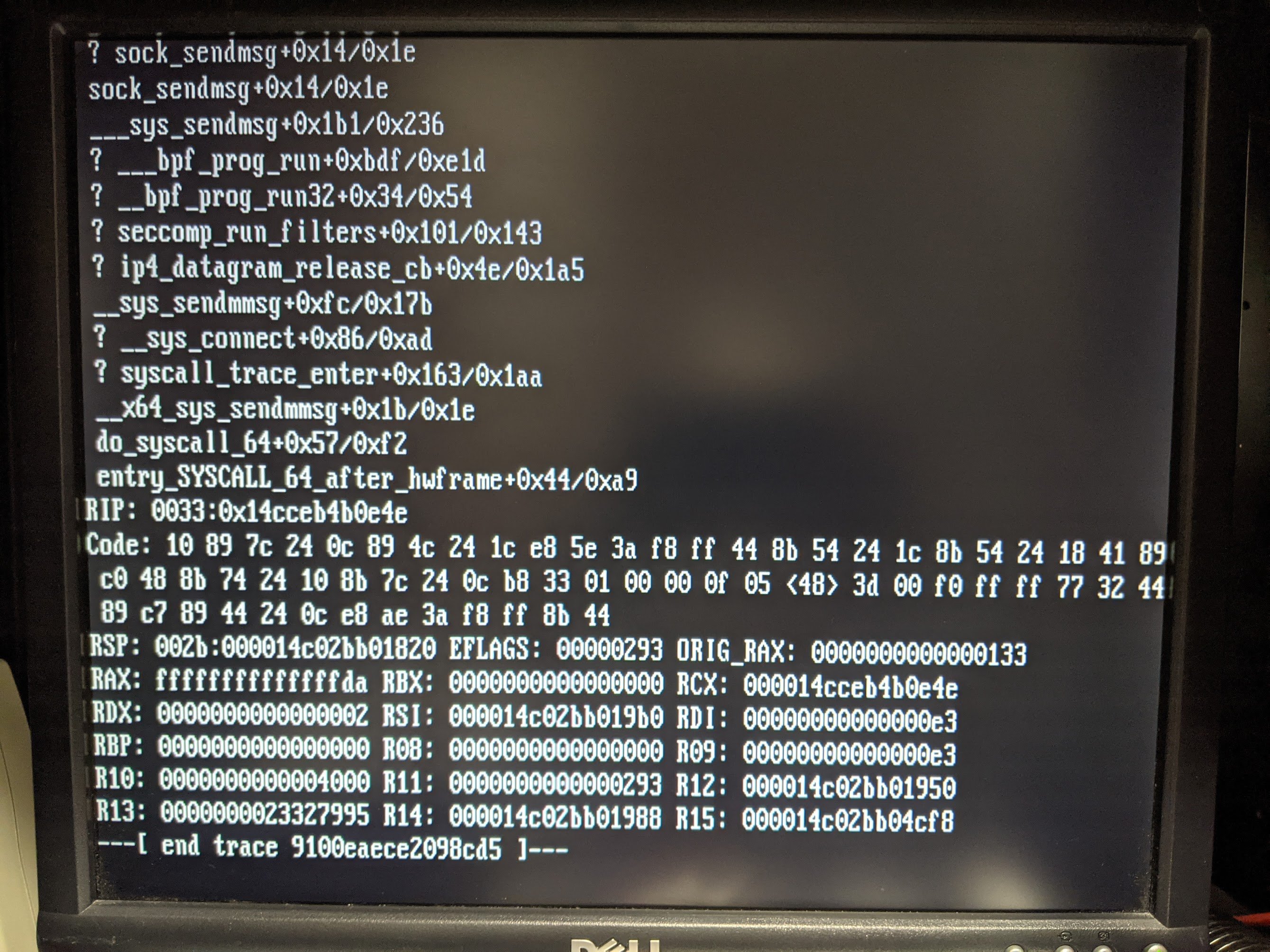

Hello Everyone,
So the instability is back, this time crashing after 19 days.
It appeared to crash last night, right before midnight after performing the AppData backup.
Any clues?
(Providing latest attachments)
syslog tower-diagnostics-20201215-0849.zip
2 hours ago, mortist said:
Any clues?
All the call traces I see are Macvlan related, this is usually the result of having dockers with a custom IP address, more info below:
Thank you for this piece of information.
You're correct, I had the Unifi controller running with a static IP on br0.
I changed some of the conflicting ports and switched Unifi back to bridge mode.
I will see if that helps.
Thanks!
