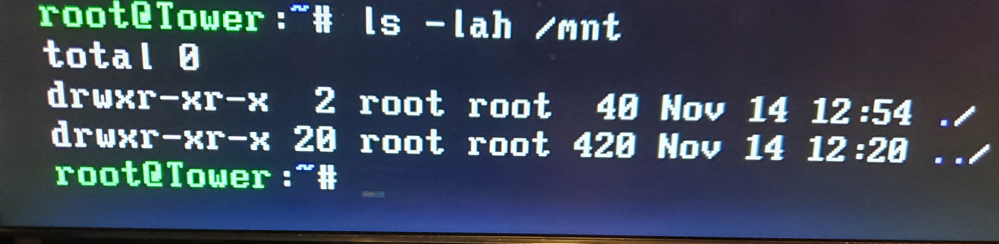

 What do you get from the command line with this?
ls -lah /mnt
ls -lah /mnt
Was the array started when you did that command?
No sorry, I forgot I restarted it.

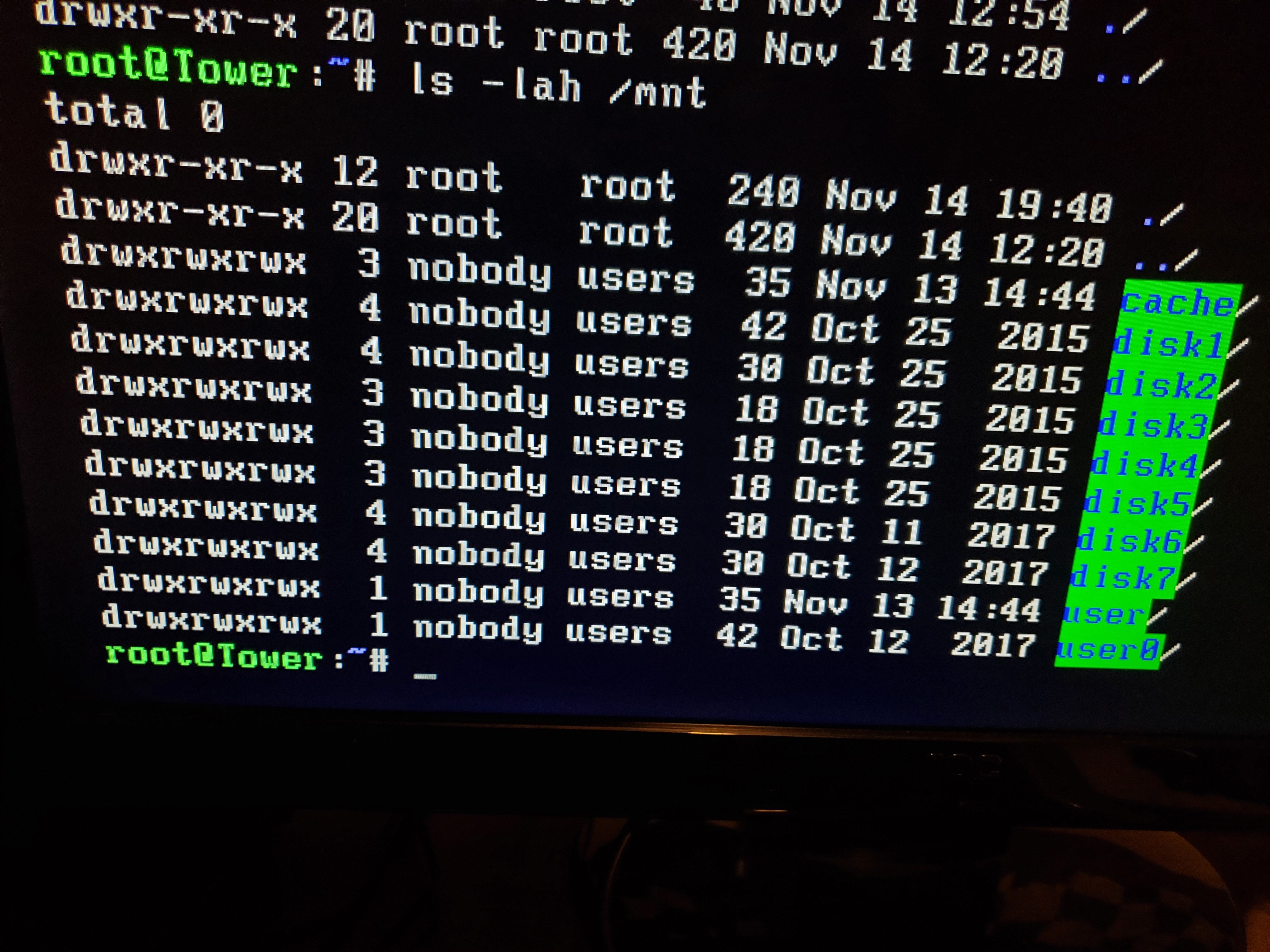

And what do you get with this?

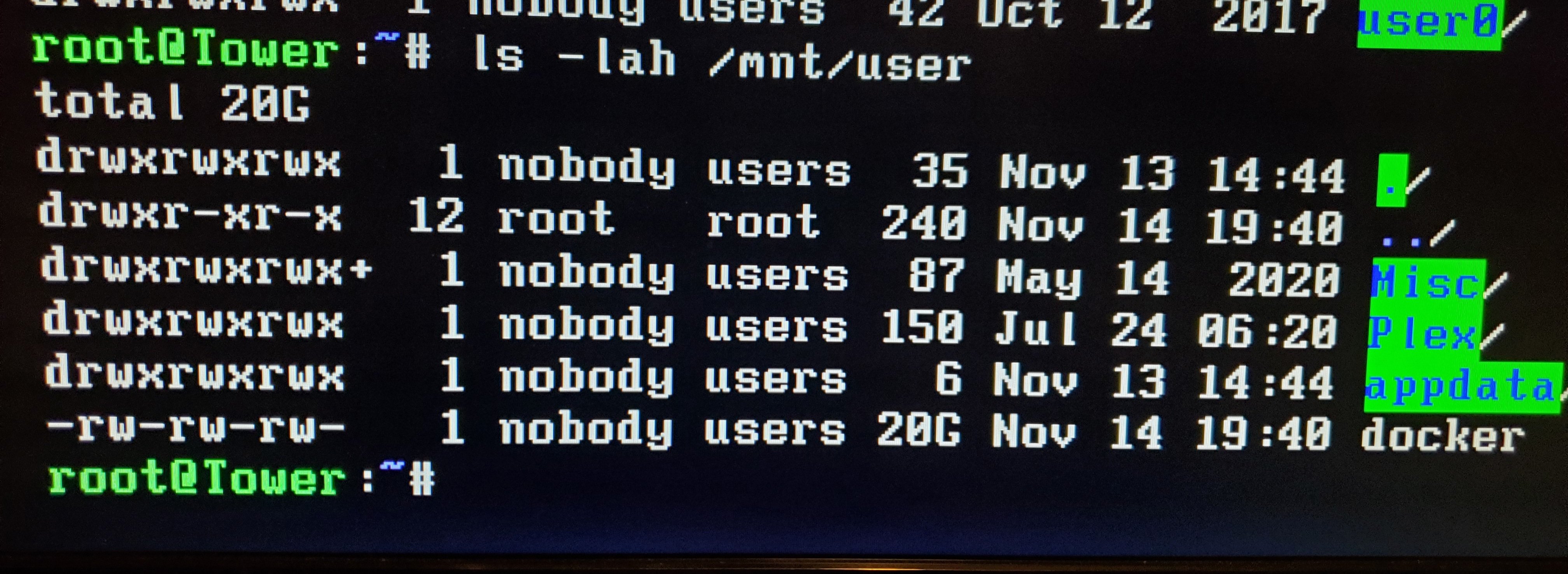

ls -lah /mnt/user
ls -lah /mnt/user
