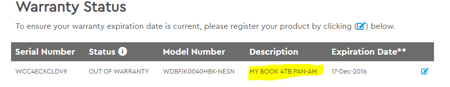

Parity disk is a shucked My Book USB device (though I remember some people buying these as if they were internal drives a few years ago), anyway that's why it's slightly smaller, you can use the parity swap procedure.
Thanks @JorgeB
The extended SMART passed ok and a did a parity swap followed by a rebuild and all was well.
