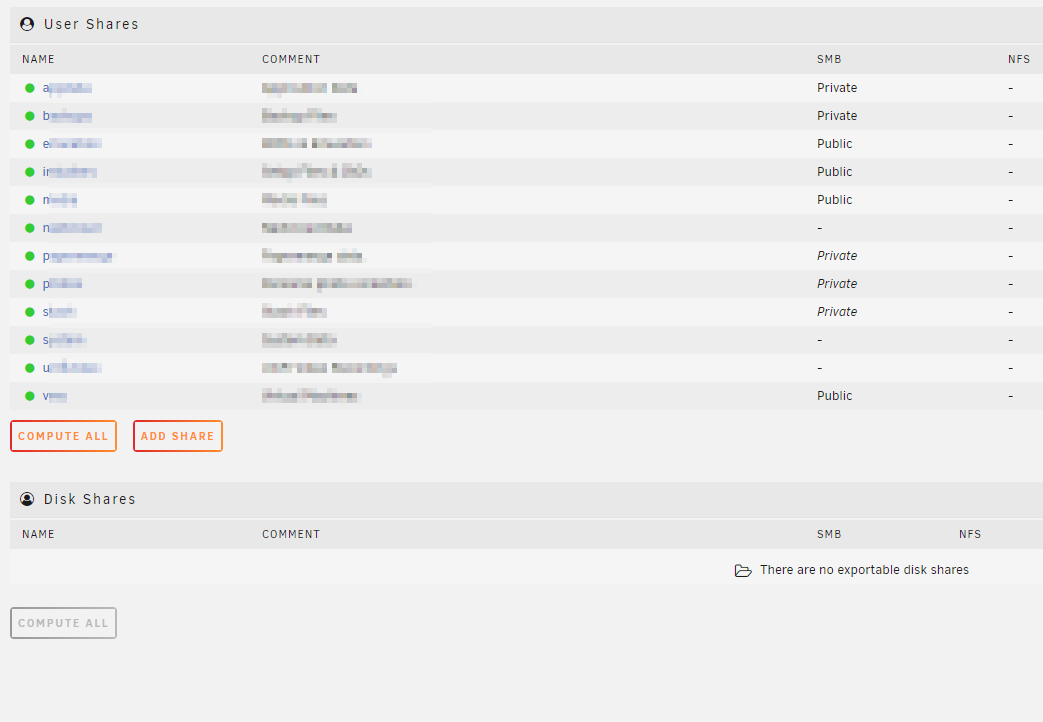

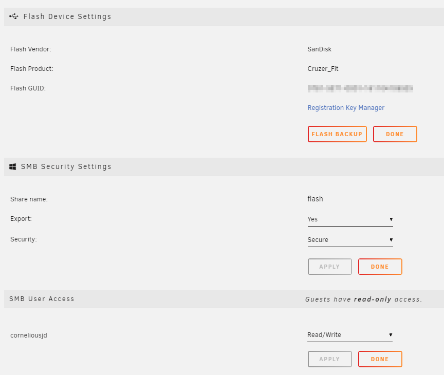

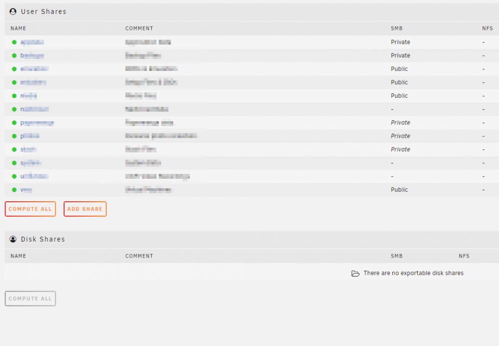

So here's some screenshots to show my current config first.

Flash Device itself - note SMB share is "flash"
Then my user/disks shares
Note you can see none of these start wth "f" so none are named flash.
No disk shares exist.
