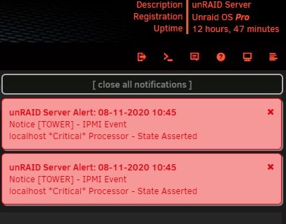

CPUTIN from sensors reads 42C when IPMI CPU temp reads 93C.  But I get critical notifications in unraid like the attached pic.  So what the heck is going on nd how do I achieve a "normal running" system?  Is the CPUTIN in sensors the accurate temp?  Why does IPMI read so high?

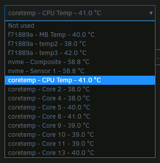

Seems it ref. to coretemp. Pls make Unraid also show coretemp and check it.
BTW, I think something wrong between heatsink and CPU. Could you try light loading and check the IPMI temperature again ?

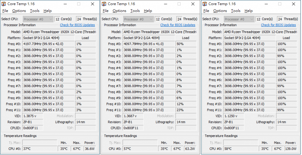

My new build was X299 with 9800x ( TDP 165W ) with Noctua  NH-D9L in 3U case also no issue, just bit hot in full load.
Room temp 25, system in idle ( 8982rpm was onboard power module fan, I add Noctua low noise adapter between that then reduce much noise.
123.PNG.cc24351cbdb9a006c2648fb63f69a419.PNG  456.PNG.8f2765fe69cb6b675d833c6e99c1081c.PNG

Those is normal figure, my 1920x also have similar behavior, i.e. in idle or only 1 or 2 core in loading, then voltage will be highest ~1.4v ( freq in 4.1GHz 4.2GHz) , but if all core-thread in loading, then voltage will steady at ~1.125v ( freq also steady 3.7Ghz ).
Below are coretemp figure in different loading, I also compare coretemp estimate power usage with the reading on UPS also match.
In summarize, system will thermal throttling automatically to make CPU not exceed 68C, during test I never exceed that even use different burn-in tools.
The problem seems your system sometime won't throttling, but I really not sure this perform by mainboard or CPU itself, you may need decide buy a CPU or mainboard to rule-out the problem or try setting "CPU voltage fixed at 1.125v and Core freq fixed at 37x", that means you will lost boost performance feature and use bit more power average.

My question is why should it even need to throttle?  I've never had cooling issues with other systems in this case and that was before I added beefier case fans a a server level CPU cooler.

I did mean 97/50.2.  97 Tctl and 50.2 Tdie.
Then no reason if Tdie is 50 but Tctl was 97 which out of 27C off set and cause alert. Does you observe offset always 27C ?
That's why I said need perform more test, problem may not come from cooling system. It could be some hardware not work in normal.
Edited by Vr2Io
My bad.  I meant 97/70.2. Too many numbers floating around in my head.
Edited by RockDawg
OK, but this also a question, what in mid load have problem, instead full load. I post three pic which means idle_mid_full, I would suggest you make some fixed setting in BIOS, then check back does thermal alert prompt.
