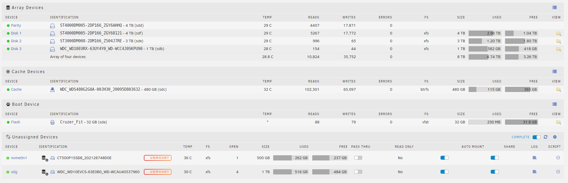

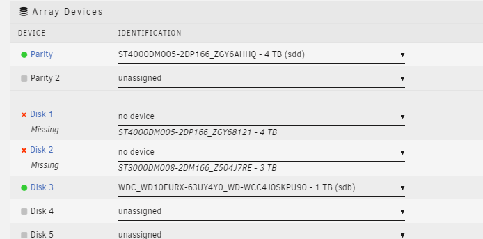

Been using Unraid for 6months now, and successfully dealt with a failed disk couple months ago. I got really worried yesterday when I got 7 read errors on 2 disks (disk 1 and disk 2). When I stopped the array, these 2 disks along with a unassigned device could not be detected by the system. Below are some details.
below is an unassigned device (expected to fail soon).

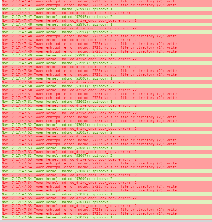

syslog was full of these, spammed every couple seconds for almost a day and half...
tower-syslog-20201108-0739.zip

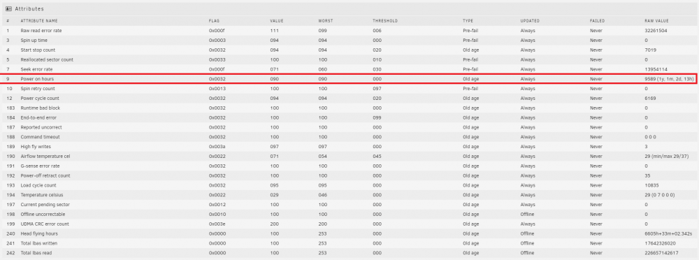

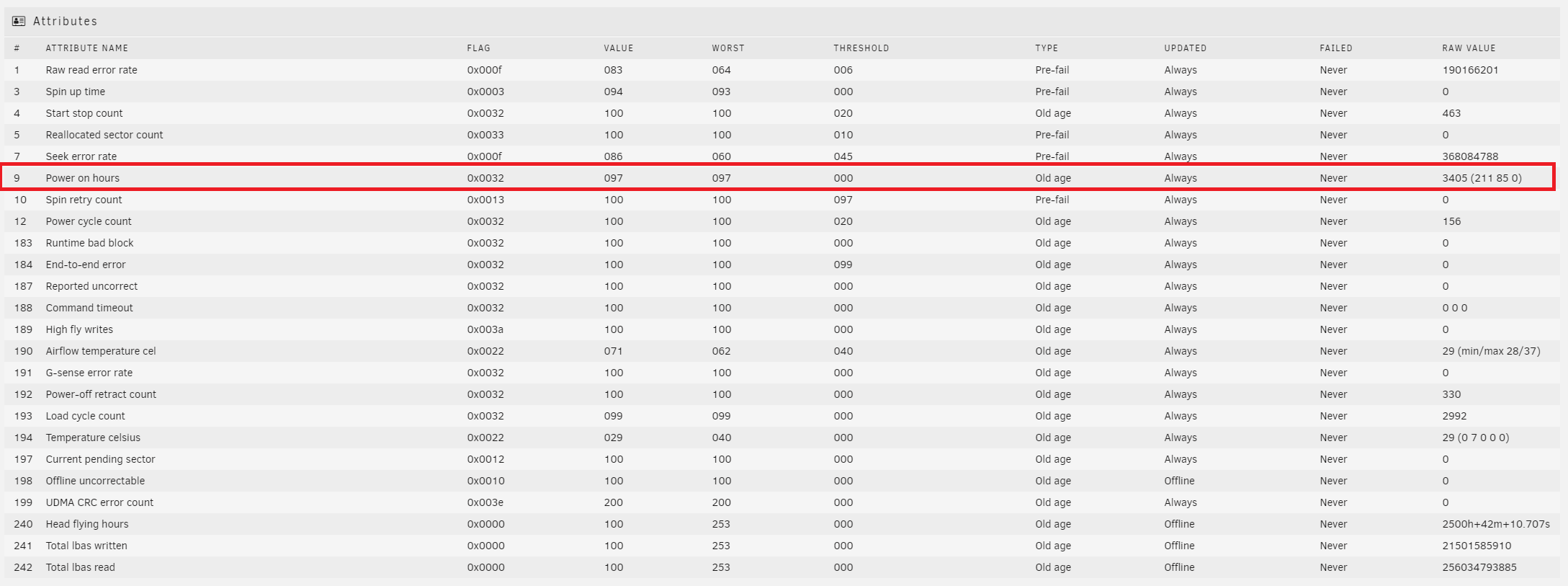

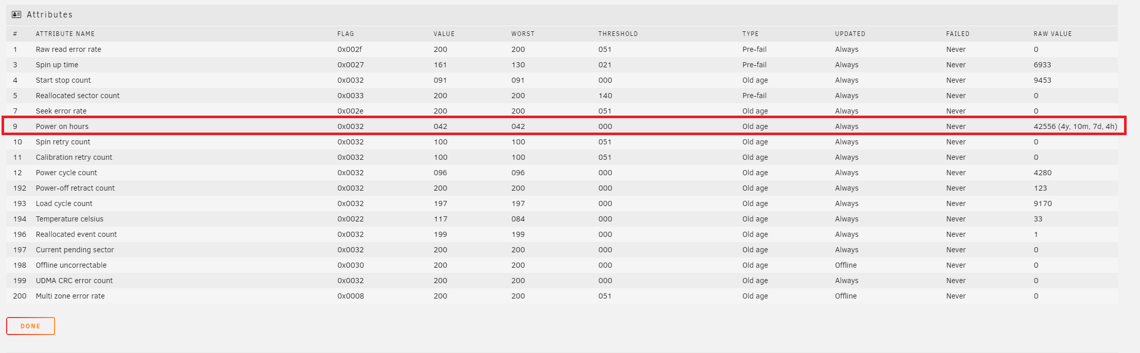

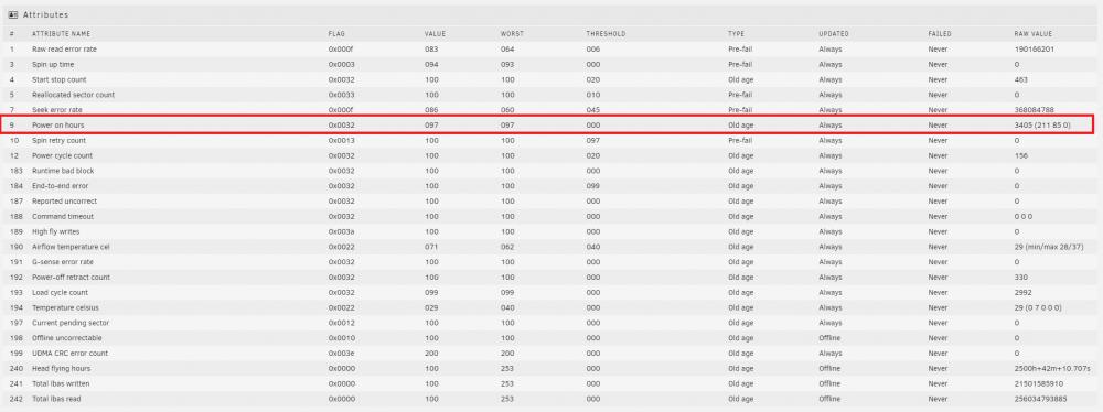

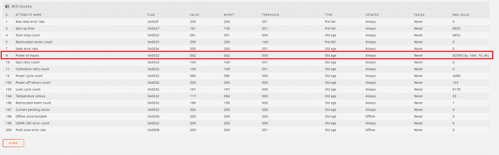

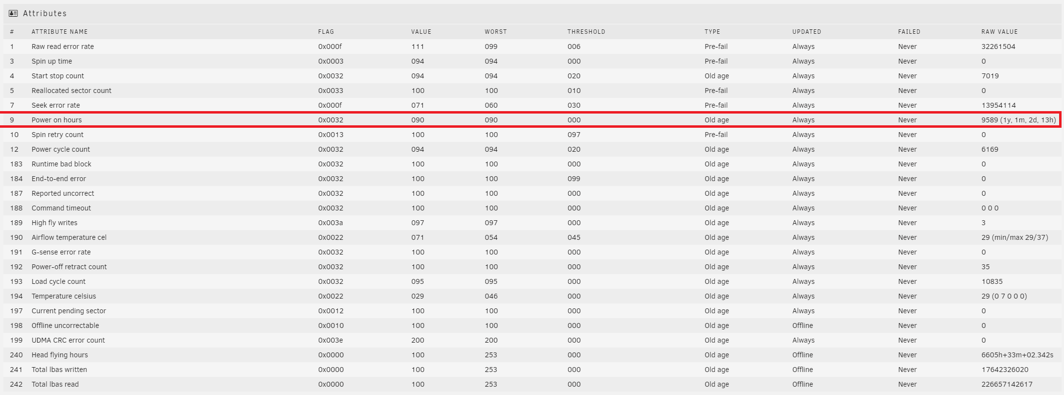

Since the system was not detecting 3 HDDs, I restarted the server in safe mode. All 3 missing HDDs came back. So I started running extended SMART tests on each.
disk 1 smart 2020-11-08.txt
disk 2 smart 2020-11-08.txt
unassigned smart 2020-11-08.txt
All 3 HDDs which went missing completed SMART with no issues.
My Disk 1 is new, only used for couple of months, but it still has many "pre-fail" and "old-age"...
My Disk 2 is not new, but hasn't been heavily used, but it also has many "pre-fail" and "old-age"...
My unassigned device disk is expected to fail any day now. but there's nothing critical on it and shouldn't cause any havoc on the system. But even this one came back as fine...

Those diags are after rebooting, and the syslog you posted before is incomplete and doesn't show the beginning of the problem, did you save the complete diags before rebooting?
unfortunately no. if it happens again, I'll do that for sure. Anything else to note?
Just that the disks look fine, so likely a controller or power/connection problem, my money would be on a controller issue, since it's quite common with Ryzen boards and v6.8.
