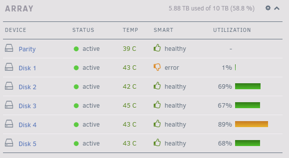

As it stands now the problem drive already has no data on it as I moved it all with Dolphin recently when it first started getting issues (It had two errors at first but since only now SMART 187 is present)
This is how the drives currently look (Disk 1 being the error child) and already has no data on it as present (the 1% is a random 14GB i cant seem to find what it relates to, I assume filesystem of sorts?)
I'm almost keen to rip out the parity drive and drive 1 and smash the build twice hahah, but I bet thats gonna be worse in practice sooo yeah :) prob wont be doing that

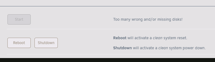

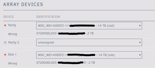

Ok so i finally got the drives installed (took awhile to finish the write and pass on the system) but its not letting me save the settings of the system?
The drives are installed and the format button is grey
When i assign the drive it shows no way to apply and rebuild the settings?
The only options i have in the operations is reboot and shutdown as start is shows too many things wrong
On 11/14/2020 at 3:51 AM, trurl said:
Go to Tools - New Config, keeping all other assignments, assign new parity and new disk1. Start the array to begin parity rebuild. After it finishes you can format new disk1.
It would seem I did not scroll up enough and this step wasnt in your last block :) so looks to be rebuilding now, only issue is disk one is showing 'Unmountable: Unsupported partition layout'
Update all should be sorted now, issue was device wasn't setup and needed formatting but the greyed out option was not letting me do it, but the array stop and restart kicked the format off,
rebuilding now
Because it hasn't been formatted yet.
