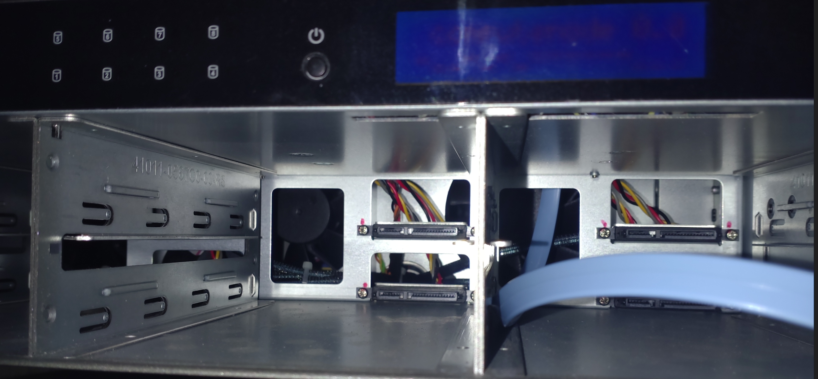

Got a TS-859U-RP+ to use for testing. I can get the screen to work using a USB Serial to breakout cable plugged into the LCD Display with lcdproc. But waiting on some memory to see if I can load UnRaid as only as 1Gb at present which is not enough for Unraid.

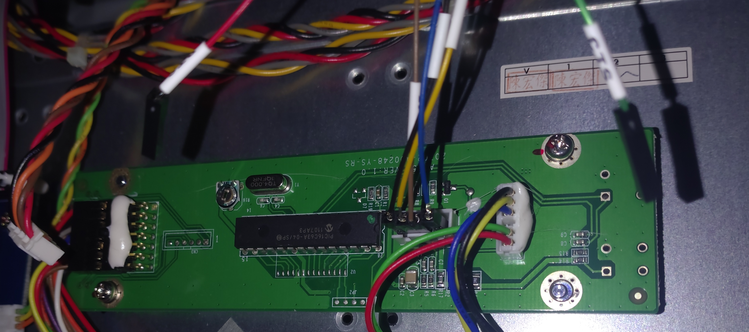

I use a USB to serial adapter with a ch340 chip. I pluged it to the internal USB connector and make a UDEV-rule for safety connection to the right USB.
SUBSYSTEMS=="usb", KERNEL=="ttyUSB*", ATTRS{idVendor}=="1a86", SYMLINK+="LCD"

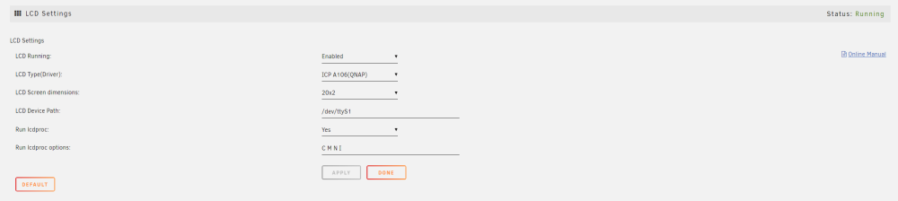

On 3/31/2023 at 12:08 PM, ricostuart said:
ttyS1 will show up in the next 6.12 release.
6.12rc3 addss in additional serial ports so lcd is accessable, 6,12 also has a smaller memory footprint. it will boot on a 1gb qnap.
With 6.12 RC3 i can confirm that not only ttyS0 but also ttyS1/ttyS2/ttyS3 show up on my Qnap TVS-882.

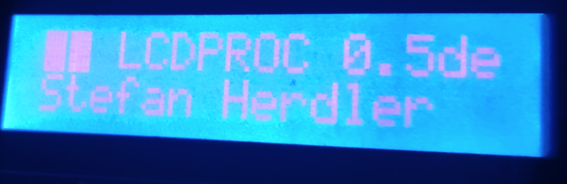

With the commands above i am able to control my display on ttyS1 (i.e. turn off, turn on, put a hello world text to the display)

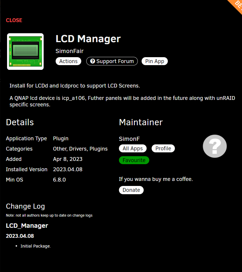

I have started creating LCD_Manager which will have a specific Unraid Client but currently just support lcdproc options. You can install from CA.
Thanks.
Can confirm that it works.
With just the lcdproc option some options are not really usefull due to how it is displayed (i.e. the display has simply too less characters to display), but the "N C M" options work quite well.
Since the Qnap is anyway just my backup NAS, which is just on for a few hours every few weeks, i am perfectly fine with anything other on the display that is not "booting ..."
