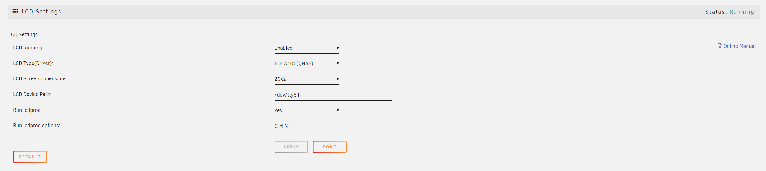

How do you get this to work? I have the plugin installed but it doesn't do anything,image.thumb.png.a9c01d584d553e6520df356f91a503e9.png
You need to specify a device path normally /dev/ttyS1 for qnaps.

This is the working config on my QNAP. you need to be on 6.12+
Thanks this helped me, all working on TS453-pro!
