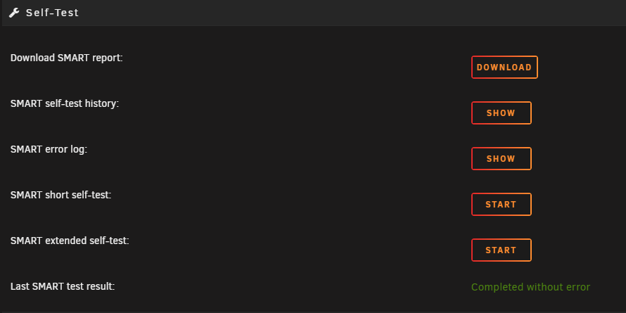

Ran extended test, but unsure where to get results. All I see is this, but I still have read errors showing on drive 7 (sdf) and parity is still disabled (sdg). Now drive  2 (sdi) is showing one read error as well. indicates a controller failure perhaps???

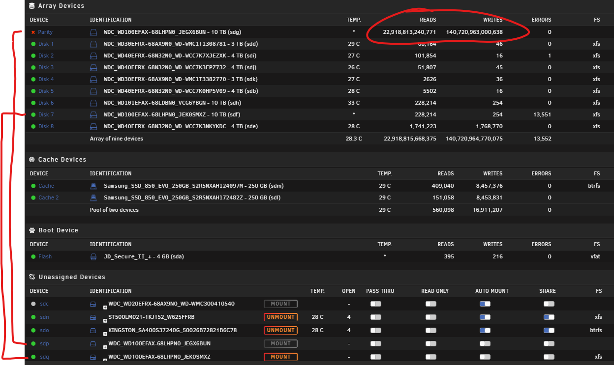

Figured another reply since I see this morning nothing has changed in terms of errors and offline drives. But this picture ...
There are a lot of reads and writes for a drive that is supposedly offline (parity), and both the drives are now showing up in UD ... ??? that is 16 hours since reboot.

Crazy number of reads/writes usually happen after a device drops offline, usually a cable issue, replace both cables on those disks.
They are SAS cables, will order a new set today and will report back once they're installed... *keeping fingers crossed* thank you!
Read, Write, and Error counts will all reset when you reboot (or you can reset them at Main - Array Operation - Clear Stats).
