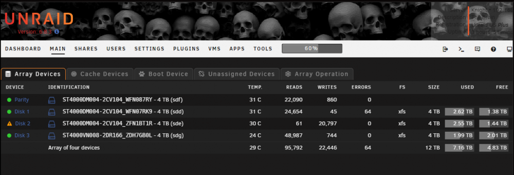

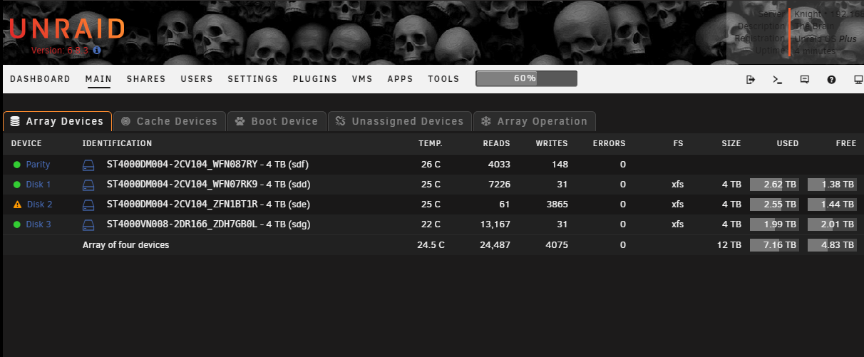

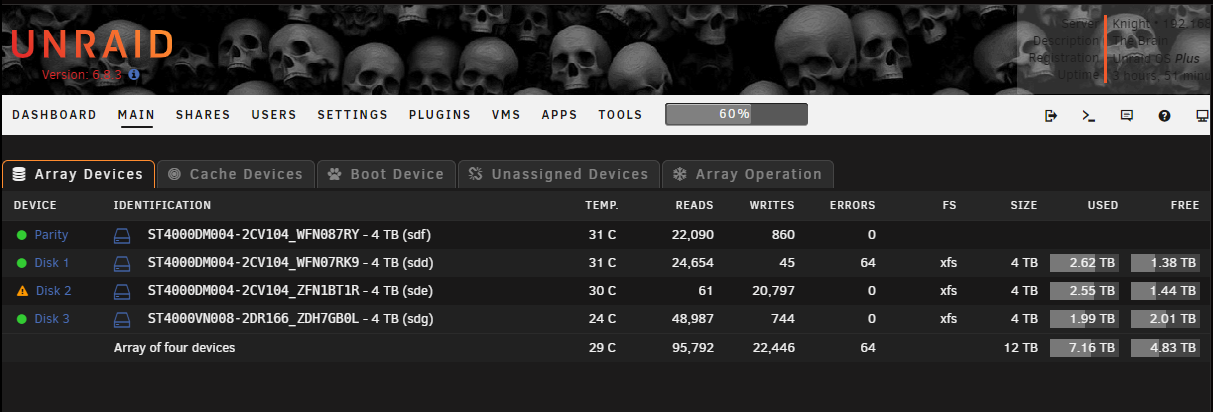

Post a screenshot of Main - Array Devices
Figures, problem is I was in the process of rebuilding disk 2. This is after a fresh startup.
Edited by Psycho
added description
I get errors on disk 1 after a while
The good news is all disks are mounted so you should be able to copy files off.
Well it's not letting me, errors keep adding up on Disk 1 and files aren't copying over. So how do I go about replacing disk 1 and deal with disk 2 being emulated. I know that I will probably lose some data but how can I save some of it?
