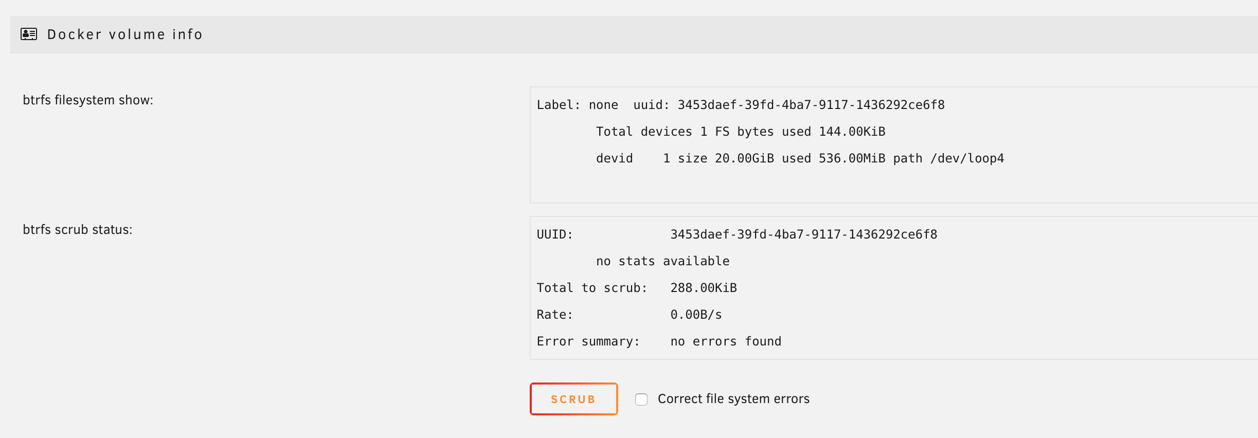

I deleted the docker image again and am receiving the below log output. Please also see screenshot of the docker volume info and diagnostic, attached. Thank you again for your help

According to that screenshot and diagnostics (and previous diagnostics now that I look again), docker.img is now /dev/loop4, don't know why /dev/loop2 is still hanging around.
Maybe try rebooting.
Okay, thanks for confirming. I'll have to wait for a couple new drives to finish preclearing and will then reboot the system. I'll report back here or submit a new post if I encounter problems after rebooting. Thank you both again for all your help!
