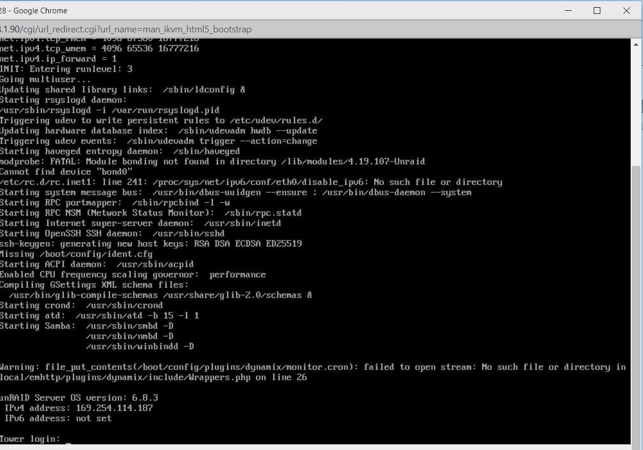

I can not get unraid to boot to any gui on my supermicro x11ssz-tln4f server. i can't get it to show up in a browser on a computer that's wired to my network, or from any wireless device. i tried 'http://tower/" and "http://tower.local" and no dice. can't get to a web gui.
I have my motherboard set to UEFI and have configured the 16Gb Usb 3.0 Sandisk USB stick to boot to UEFI and use a DHCP server, which is what I use with my netgear Nighthawk router.
one strange thing is that when i look at the boot process of unraid, where i would normally hope to see a local "192.168.x.x" ip address, i see one that is very different - "168.254.114.187"
I'm at my wits end. Please help me be less uninformed and desperate. :)

Tried the beta but still strange ip configuration. Moved my network cables to different ports on the motherboard, just to see if it made a difference and it did not. Went into the bios setup and re-enabled PXE boot just to see if that might force an 'awakening' of the network adapters. Can't boot to the gui either, I think I might add an aftermarket nic and see if that does anything different.
Same issues as before, removed all network cables from my motherboard onboard nics, And added a TP Link gigabit network card to the top PCI slot and still nothing. By “nothing”, I mean I can’t boot to a GUI and when I login to UNRAID at the console, I get the strange outside IP address is my IP V4 address. 169.254....  I also have a IPMI on the motherboard and it registers as “192.168.1.90” and is always seen in my network. Attached to a four port hub, same as the IPMI cable. Maybe I’ll switch cables, who knows...
