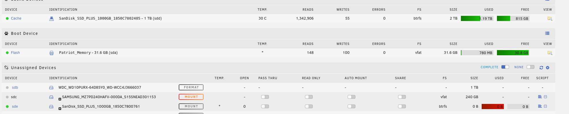

Edit 2:  Adding picture of how it looks like now after another reboot
I'm able to access the cache drive, so I'm backing it up for now.

I was able to resolve my problem since I was able to access the data (using the same steps mentioned in that first link).
I just moved all the data over to the main array, then rebuilt the cache array... I noticed one of the two drives acting odd before rebuilding the cache array, which after several tries to move data around, it eventually stopped working. Tried to format it w/ gparted, and it froze. Shortly afterwards it was undiscoverable by `fdisk -l` so I just assumed it died (still under warranty & was a raid 1 config, so not a big deal).
So right now I'm just using 1 of the 2 drives, which is still working. Cache is up working fine now. Ordered some more SSDs, and moving with the warranty process with the supposed dead one.
