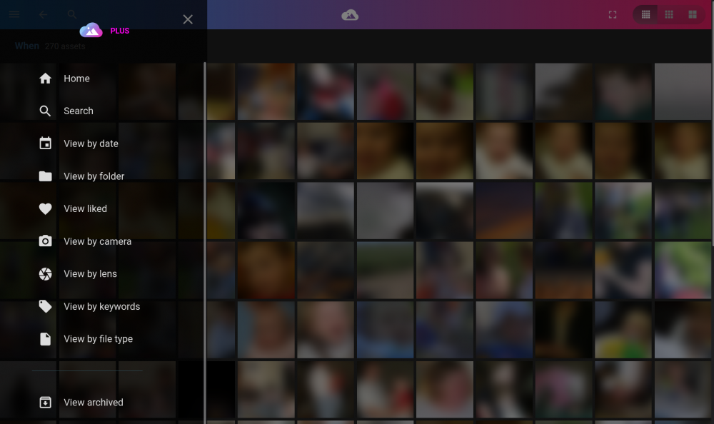

How does this differ from Photoprism?  I know photoprism uses machine learning to help with photo recognition. Have you compared at all?  I am giving this a shot and I can provide feedback.
A couple of people were looking at the app so I thought that it would be worthwhile helping with a template. I have just used it to scan 10,000 photos and it will index them by date etc.
Looks ok to browse through your collection but doesnt seem to have photo recognition.

Not sure I see the point of this application. There's no upload feature, no sync feature, no way to organize files that I can find, no way to delete pictures, etc... this is strictly a static photo viewer from what I can tell? It's kind of nice, interface wise, but really has very little point. What am I missing?
I currently recommend to my beta users that they use a sync tool on their phone.
no sync feature
Your PhotoStructure library should mirror what you've got on your filesystem. See https://photostructure.com/about/v-0-9/#-scan-path-improvements for details.
Perhaps you missed this? https://photostructure.com/getting-started/automatic-library-organization/
If you meant keyword or other metadata editing, then yes, that is missing, and on my todo list.
