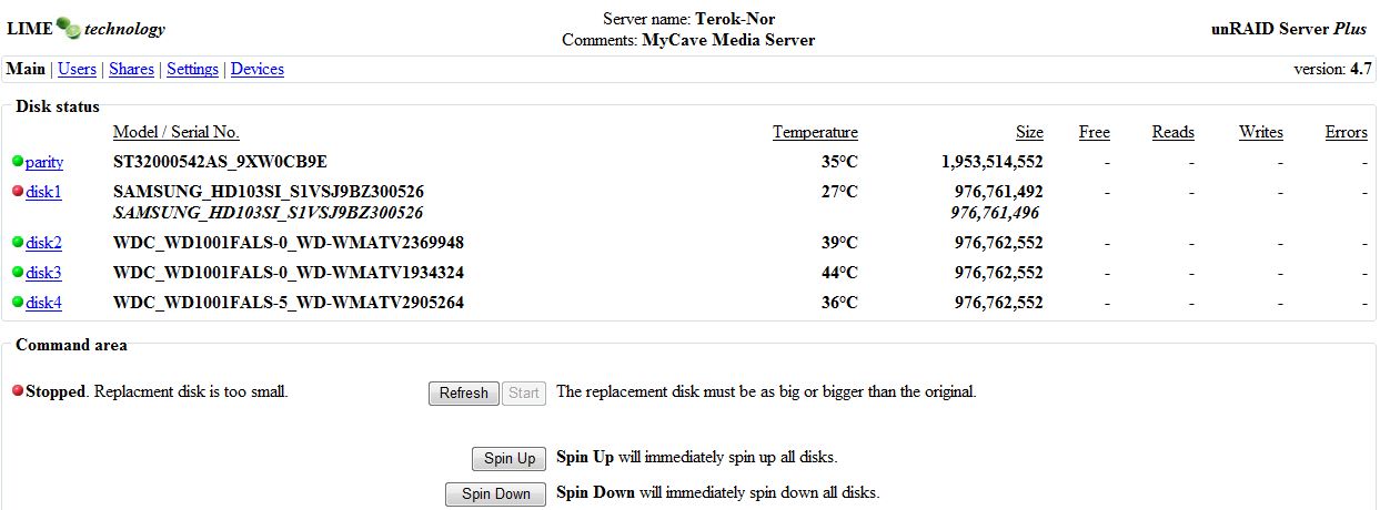

i have just moved from 4.6-rc2 to 4.7
all was well before the upgrade (only copied bzimage,bzroot and memtest) and have not changed ANY hardware or bios settings etc.
just a reboot and i get disk too small error
i have attached my syslog and a screenshot..
not sure what too do
please help.

Your problem is that you have HPA on that drive now:
Jan 26 17:01:54 Terok-Nor kernel: ata1.03: HPA detected: current 1953523055, native 1953525168
Jan 26 17:01:54 Terok-Nor kernel: ata1.03: ATA-7: SAMSUNG HD103SI, 1AG01118, max UDMA7
Jan 26 17:01:54 Terok-Nor kernel: ata1.03: 1953523055 sectors, multi 0: LBA48 NCQ (depth 31/32), AA
Jan 26 17:01:54 Terok-Nor kernel: ata1.03: configured for UDMA/133
I am going to assume you have a Gigabyte motherboard.  It just tried to "help" you by saving a copy of your BIOS settings to a hard drive... which happened to be in your array.
You need to first disable HPA in your BIOS and ALSO check for a BIOS update for your board so that HPA is disabled by default.  If it is not it is only a matter of time before this happens again.
Directions for removing the HPA are here.  You would use sde instead of sdf.
