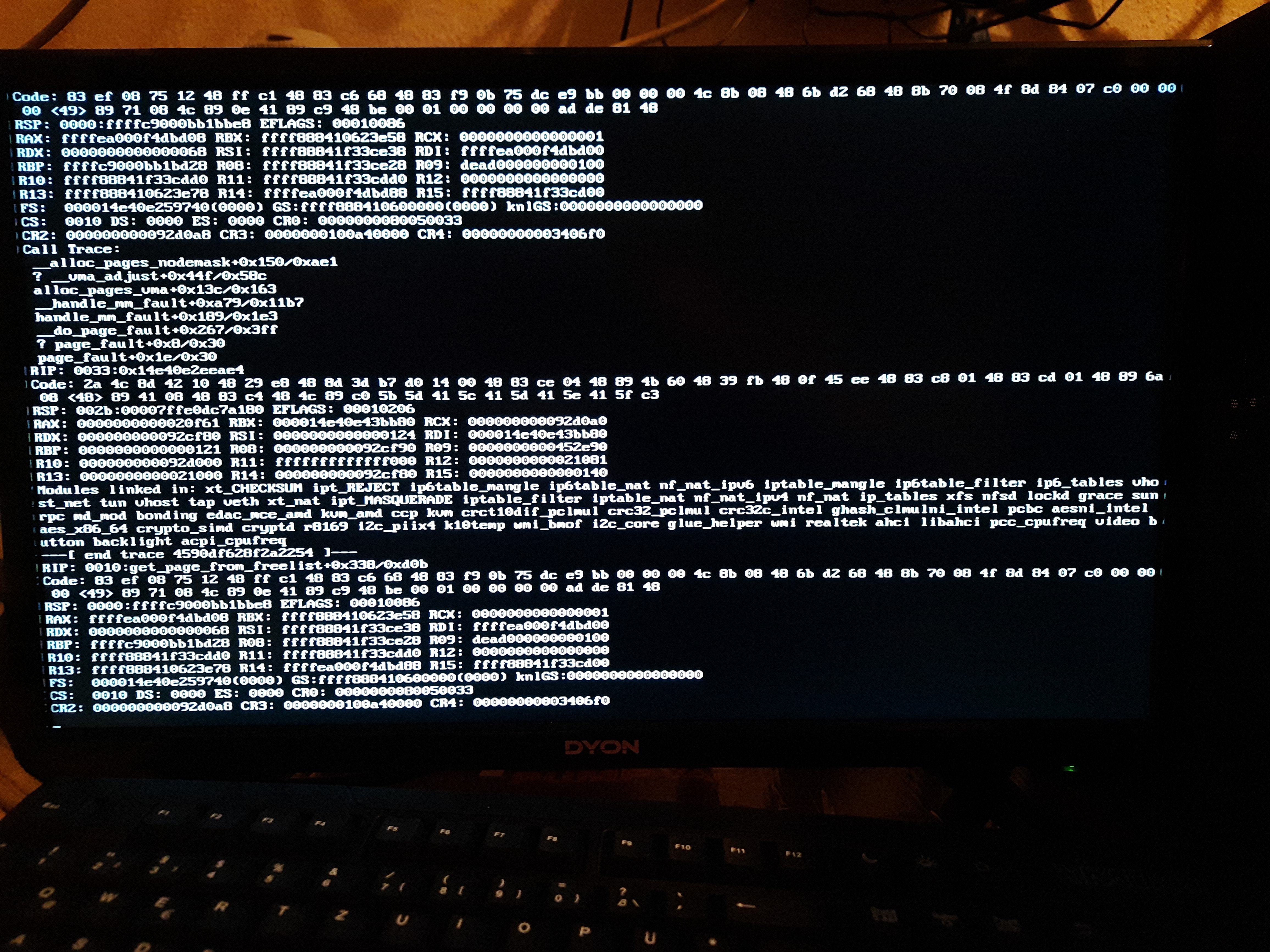

I also attached a screenshot of the console from a former crash
Before this crash I swa all 4 cores of the cpu rising up to 100% step by step

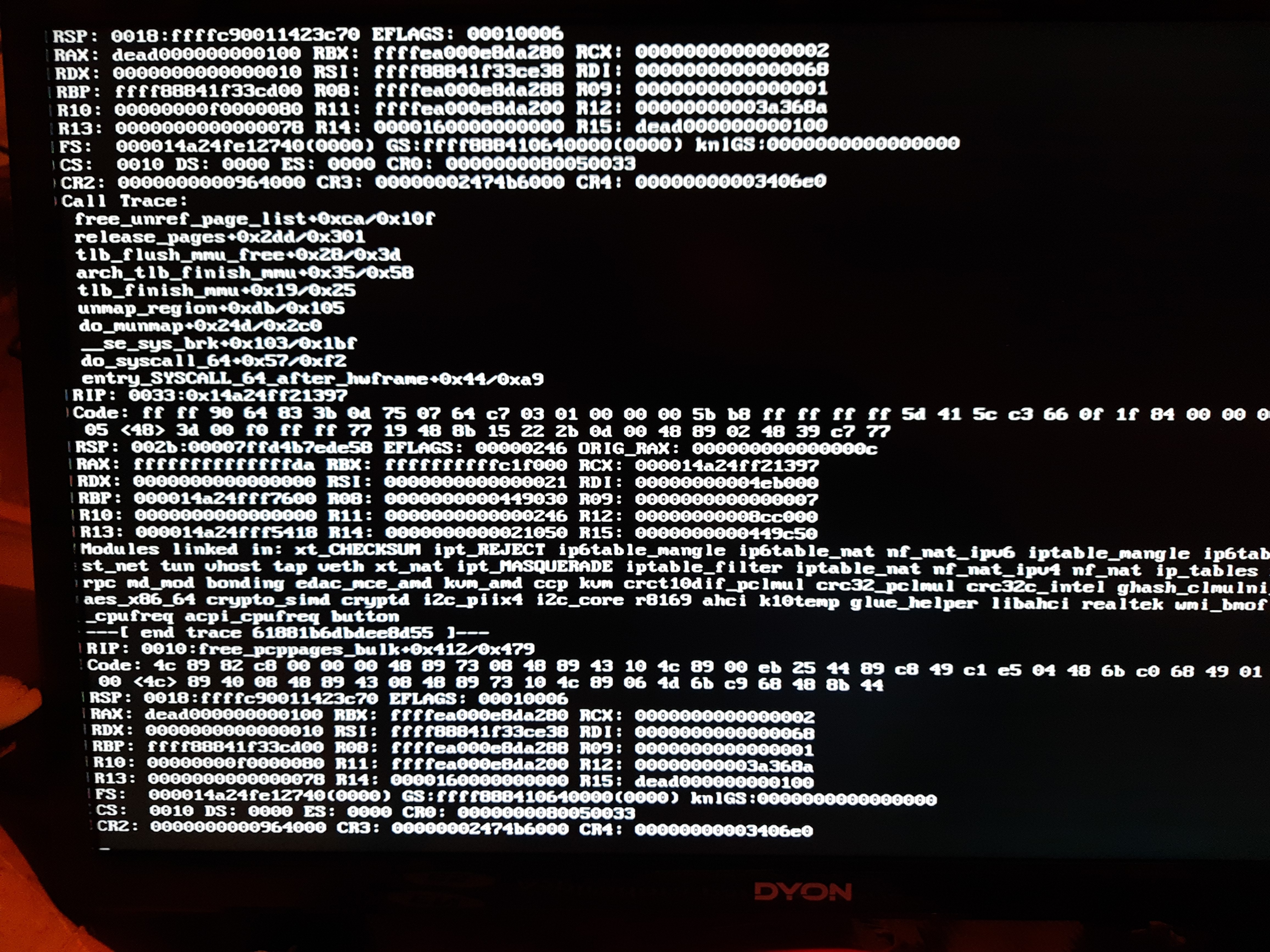

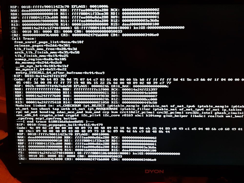

What does the page fault in the log mean? Guess this is related to memory not to the CPU, right?
