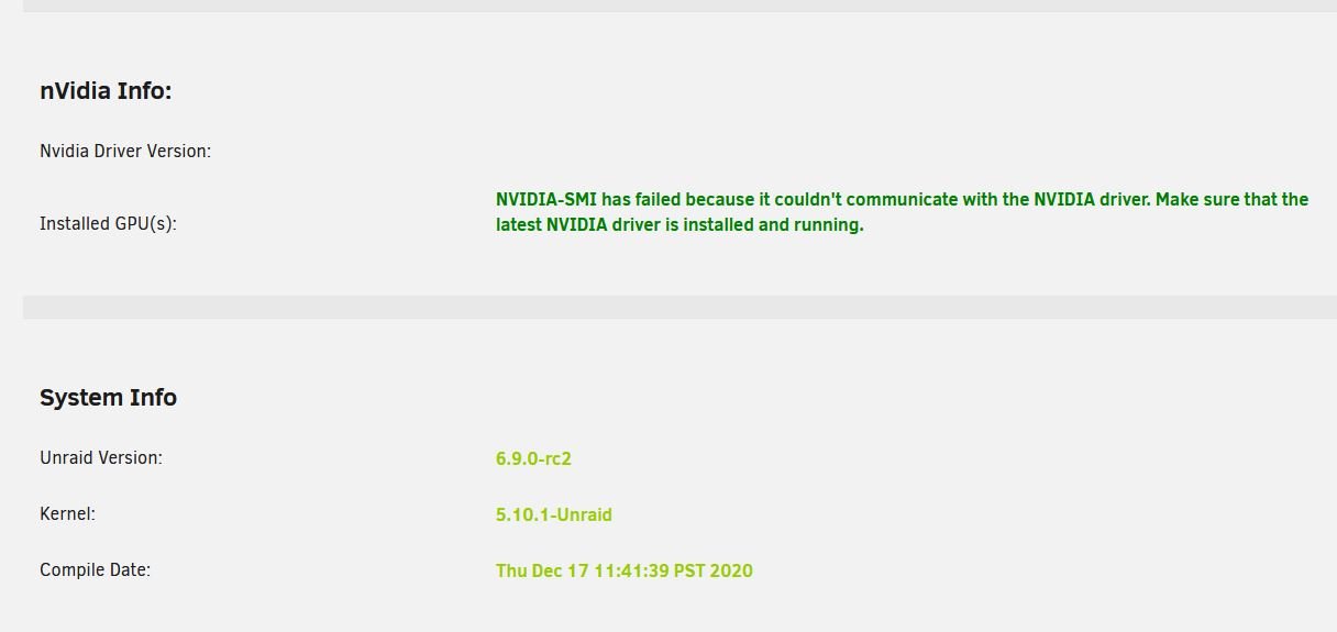

I'm stuck at the "NVIDIA-SMI has failed because it couldn't communicate with the NVIDIA driver. Make sure that the latest NVIDIA driver is installed and running."
I have a Quadro P600 card that does appear in the System Devices section.  OS version is 6.9.0-rc2 and the driver version is 455.45.01.  The NVIDIA document listed in the first post shows the P600 as a compatible card.
I'm confident the card works since it's hooked up to my KVM console and it's working fine with that display.
nvidia-smi output is the same error above.
I see this in the log though, which is weird.  My card is definitely listed in the compatibility list for the v455.45.01 drivers.

39 minutes ago, Spyderturbo007 said:
NVIDIA Quadro 600
You have a Quadro 600 and not a P600, this is a major difference... The Quadro 600 is not supported by this driver.
Click
Click
Ah crap.  I yanked it out of a machine and saw the 600 on the side and just assumed it was a P600.
I guess I can always use it for a VM, right?  Or is that out of the question as well?
Thanks!

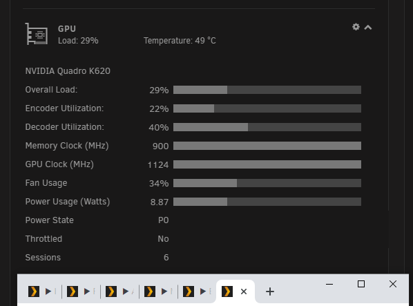

I have an old quadro k620 in my box I decided to try this on.
A $50 card from 2014 can handle at least 6 plex transcodes at the same time, using less than 10 watts lol!
