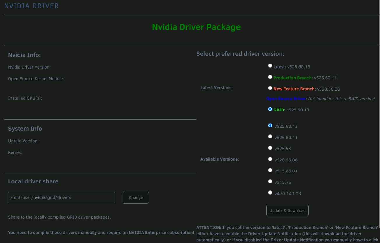

27 minutes ago, ich777 said:
Sorry but this plugin is not designed for Datacenter GPUs.
You can however fork it and create your own plugin for these cards and maybe publish it to the CA App as long as it doesn't violate the Nvidia EULA.
This would be also beneficial to other users.
I would be also glad to help if you need anything.
Providing the enterprise drivers publicly would definitely violate the EULA which is why I suggested the custom URL support or local storage support. That way people that have legitimate access to the driver can compile their own version locally. That way the plugin will never violate any EULA.
I didn't want to implement a separate plugin since the fork would be exactly the same but with custom URL/share support for driver packages which is why I asked if you would accept such a PR.
I imagined something like this, where if one would select GRID it would pull the latest compiled version from the local share.
The settings could also be enabled through an "Advanced settings" section so regular users with consumer cards won't need to bother. Of course "easy to use" is kind of a hard requirement to fulfill with this, though I could imagine providing a script where users just put the enterprise drivers in a "build" folder on the share, press a button in the UI to compile the driver package and a script would compile it. Then the compiled package would be copied over to the "driver share" for the plugin to use or something like that.
Tesla and Quadro cards are already supported by the plugin.
The cards themselves are supported by the consumer drivers yes, but not the vGPU functionality they technically support through the enterprise driver.
From my perspective everything that is needed for the cards to work properly should be integrated into the plugin package itself
Yeah it would definitely make sense to include it in the self compiled packages for the users instead of having to install it separately.
And this is where the fun begins, this is one reason why my plugin isn't designed for that because it is designed for a completely different use case.
For the use in Docker container and not in VMs (vGPU).
7 minutes ago, shawly said:
I didn't want to implement a fork since the fork would be exactly the same but with custom URL/share support for driver packages which is why I asked if you would accept such a PR.
But wouldn't it be better to create your own plugin for this specific use case and also customize it for that?
You have to understand if I implement this many support question will come in and I simply can't answer them because I don't have the hardware/time/money to even test this all and understand how this is all working.
This is where the next issue begins, what is if you up- or downgrade your Unraid installation, this share or better speaking this location is not available on boot and the plugin installation will ultimately fail and you have to reinstall the plugin again.
Correct me if I'm wrong but not all Quadro cards are supported or am I wrong about that.
...and it would in this case make also sense to customize the plugin in that way so that users can create their vGPUs from the plugin page itself.
I have to say I find it interesting but I won't change the existing plugin to add vGPU support or the support for GRID cards (I looked up the GRID cards on the Nvidia driver download page and drivers for the K1, K2, K340 & K520 are available for public download but I don't know if that's the driver which is needed).
Link to comment
That is true. Though this could be an unsupported or experimental feature. But yeah you're absolutely right.
Aren't shares available on boot or rather when plugins are installed? Of course the users would need to rebuild the driver package for that version. But wouldn't the same scenario happen right now if someone upgraded from an UnRAID version that has the OpenSource driver support to a newer version that doesn't have an OpenSource driver package like the latest version?
These are all the supported cards: https://docs.nvidia.com/grid/gpus-supported-by-vgpu.html
No sadly NVIDIA still locks the vGPU drivers behind a subscription model so the drivers can only legitimately be downloaded if one has access to the enterprise support portal and a license for guests is required as well. Which is why the only way for now would be that the users themselves would need to compile their driver packages for UnRAID.
But yeah, you have convinced me that it might make more sense to provide all that functionality in a separate plugin. When I got more time on my hands I'll definitely give it a try. Though I have to say the developer documentation for implementing UnRAID plugins is quite terrible, being scattered over multiple forum threads with lots of outdated info is quite tiresome.
Edited by shawly

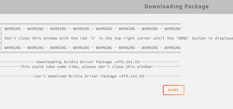

Getting this when trying to update by selecting latest radio button
| WARNING - WARNING - WARNING - WARNING - WARNING - WARNING - WARNING - WARNING
| Don't close this window with the red 'X' in the top right corner until the 'DONE' button is displayed!
----------------Downloading Nvidia Driver Package v470.141.03-----------------
---------This could take some time, please don't close this window!------------
---------------Can't download Nvidia Driver Package v470.141.03----------------
Any ideas?

27 minutes ago, KJThaDon said:
I do not
Can you open up a terminal from Unraid, issue the following command and send me the output:
cat /tmp/nvidia_*
From your syslog I see nothing obvious which is preventing the plugin from how it should work, something seems to be wrong anyways on your system, I'm really curious what is wrong there.
Have you yet tried to reboot and see if it's the same after a reboot?

32 minutes ago, ich777 said:
You already have installed driver version 520.56.06 from what I see from your Diagnostics.
What happens when you try to set it to a static version instiead of latest?
I did try that a few times also. No difference. Odd that it's showing I have the latest installed, but not on the UI.
cat /tmp/nvidia_*
CUR_PRB=525.60.11
LAST_PRB=515.86.01
CUR_NFB=520.56.06
LAST_NFB=495.46
UPDATED=2023-01-05T07:05Z
470.141.03
515.76
515.86.01
520.56.06
525.53
525.60.11
525.60.13
I will try rebooting again and see what it's showing.
Thank you
Link to comment

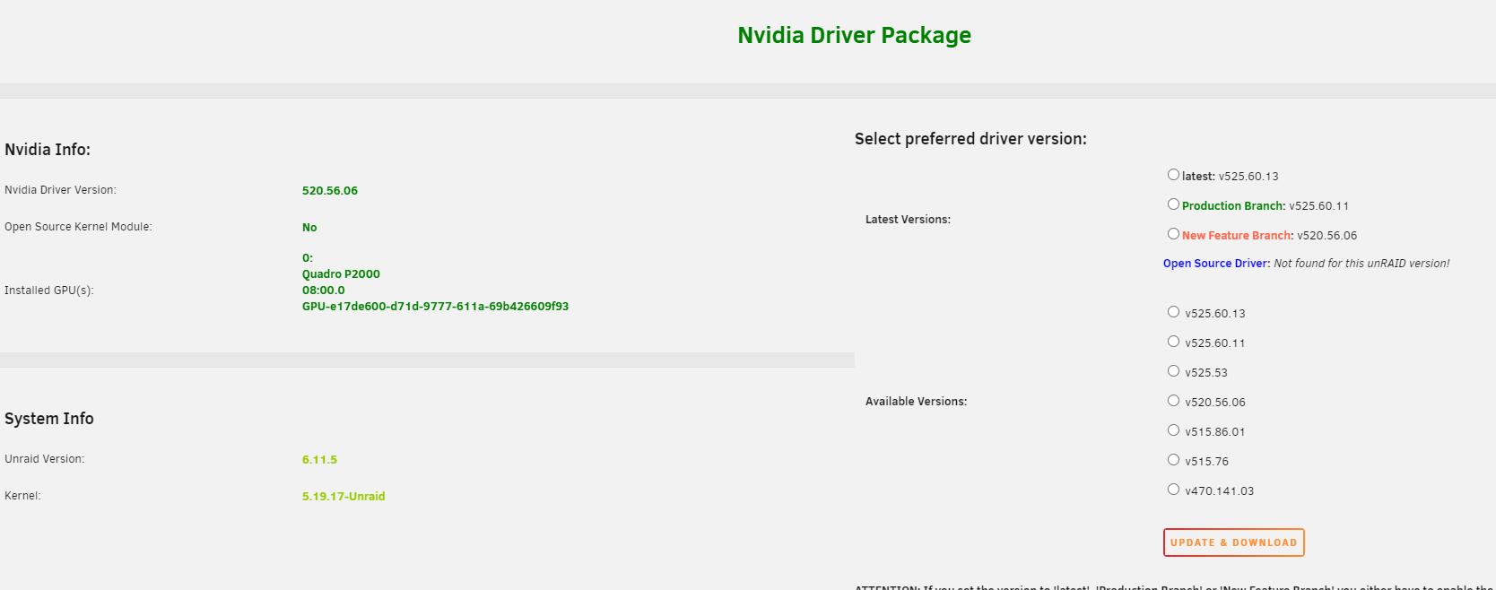

Can you also give me the output from:
/boot/config/plugins/nvidia-driver/settings.cfg
I think the settings file is messed up but I'm not too sure, I really can't tell what's going on there the output from the other files are also fine and displaying the right version numbers.
Link to comment
update_check=false
Link to comment
54 minutes ago, KJThaDon said:
update_check=false
Yeah, there are pretty much all entries missing.
Do you maybe have edited it manually at some point in the past?
If so, all values must be in there like mentioned below.
Do you know how to edit this file in the terminal? In your case it should look like this:
first_installation=false
driver_version=520.56.06
disable_xconfig=true
update_check=false
(I assume that you are booting into GUI mode with the Display attached to the Nvidia card, if not change the line disable_xconfig to: disable_xconfig=false)
  • Upvote 1
