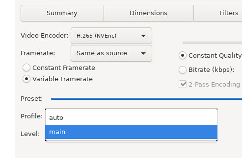

11 minutes ago, Keichi said:
Handbrake doesn't support h265 NVEnc with 10 bits sadly.
Are you sure?
Handbrake uses also ffmpeg as a backend and if ffmpeg supports it I think Handbreak also can support it but as I said before it has to be compiled with the right options.

12 minutes ago, ich777 said:
Are you sure?
Yes, i suppose :

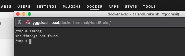

And i can't launch ffmpeg from the console :
That doesn't mean that it's not installed there try something like: 'find / -name *ffmpeg*' and it should list all files that contains ffmpeg.
It tells you only that ffmpeg is not in the $PATH of the container you have to go to the location where it lives and then execute it with './ffmpeg' or execute it with the full path eg: '/etc/ffmpeg' depending on where it lives.
But that is something for the Handbreak thread...
EDIT: But when I think of it now Handbreak is an alternative to ffmpeg and it is possible that it's not included in the container.
