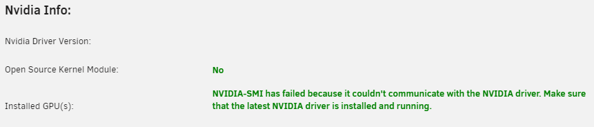

Hello, I am hoping to get some help or guidance with an issue. I had my GPU running in a previous system with unraid but recently bought an old T630 and installed my GPU (GTX 1070) into it with the power adapter provided from the seller. It lights up and seems to be working but after installing the app i get an error.
NVIDIA-SMI has failed because it couldn't communicate with the NVIDIA driver. Make sure that the latest NVIDIA driver is installed and running.
Is there anything I can do? I have done the following:
  • made sure the PCIe slot is enabled in the bios settings.
  • tried older driver versions.
  • uninstalled and reinstalled the app.
Now I am scratching my head wondering what other options I have.
Sincerely,
Sideh.
PS. doing the nvidia-smi in console provides the same out put as in the picture.
Yes, post your Diagnostics here. ;)
I'm not sure what you are talking about...
I am so sorry, can't believe I missed that. Here it is attached.
Just mentioning I am using and old Dell server incase that was an issue. Just incase.
Your card is bound to VFIO:
84:00.0 VGA compatible controller [0300]: NVIDIA Corporation GP104 [GeForce GTX 1070] [10de:1b81] (rev a1)
    Subsystem: ASUSTeK Computer Inc. GP104 [GeForce GTX 1070] [1043:8599]
    Kernel driver in use: vfio-pci
    Kernel modules: nvidia_drm, nvidia
84:00.1 Audio device [0403]: NVIDIA Corporation GP104 High Definition Audio Controller [10de:10f0] (rev a1)
    Subsystem: ASUSTeK Computer Inc. GP104 High Definition Audio Controller [1043:8599]
Please unbind it from VFIO and try again, this is the entry:
Loading config from /boot/config/vfio-pci.cfg
BIND=0000:84:00.0|10de:1b81 0000:84:00.1|10de:10f0---
Processing 0000:84:00.0 10de:1b81
Vendor:Device 10de:1b81 found at 0000:84:00.0
IOMMU group members (sans bridges):
/sys/bus/pci/devices/0000:84:00.0/iommu_group/devices/0000:84:00.0
/sys/bus/pci/devices/0000:84:00.0/iommu_group/devices/0000:84:00.1
omg I can't believe I missed that. I untick it multiple times and then scrolled to the bottom and hit done. My bad, Sorry about that.
It now says "No devices were found" I have also verified that it is no longer selected for VFIO.
I have also included the diagnostics this time 😅

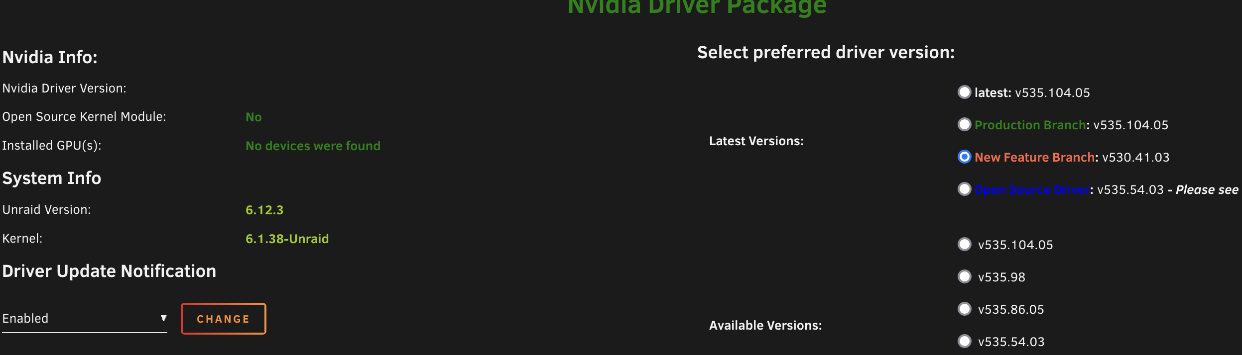

sv1-diagnostics-20230829-1543.zip
9 hours ago, KrypticKahos said:
Have any other input on why it may not be visible?
Please update your BIOS, Asrock had some issues with GPU compatibility I've read in a article but that was for RTX40 series but maybe it helps in your situation too.
I can only see this messages over and over:
Aug 29 15:30:54 SV1 kernel: NVRM: GPU 0000:04:00.0: RmInitAdapter failed! (0x25:0x65:1462)
Aug 29 15:30:54 SV1 kernel: NVRM: GPU 0000:04:00.0: rm_init_adapter failed, device minor number 0
This is a pretty generic message and often times means that there is a hardware incompatibility issue.
For earlier Ryzen CPUs I always recommended disabling C-States in the BIOS or forcing a specific PCIe generation in the BIOS instead of AUTO but please try upgrading the BIOS first and see if that helps.

BIOS was updated, and you were correct. The notes for the new version had fixes for 40 series card compatibility. This however didn't resolve my issues.
I will also go and attempt disabling C-states, and forcing the PCIe generation.

Did some more testing and C-states were already disabled, and setting PCIe generation didn't help either.
Turns out it was because I had an odd hardware configuration. I had my GPU in the secondary PCIe slot, and my HBA card in the primary GPU slot. I did this previously because I wanted maximum bandwidth to the hard drives. Turns out that my motherboard didn't like that setup. I put the GPU in the primary slot, and HBA in the secondary and now the GPU is showing up and everything is working as expected.

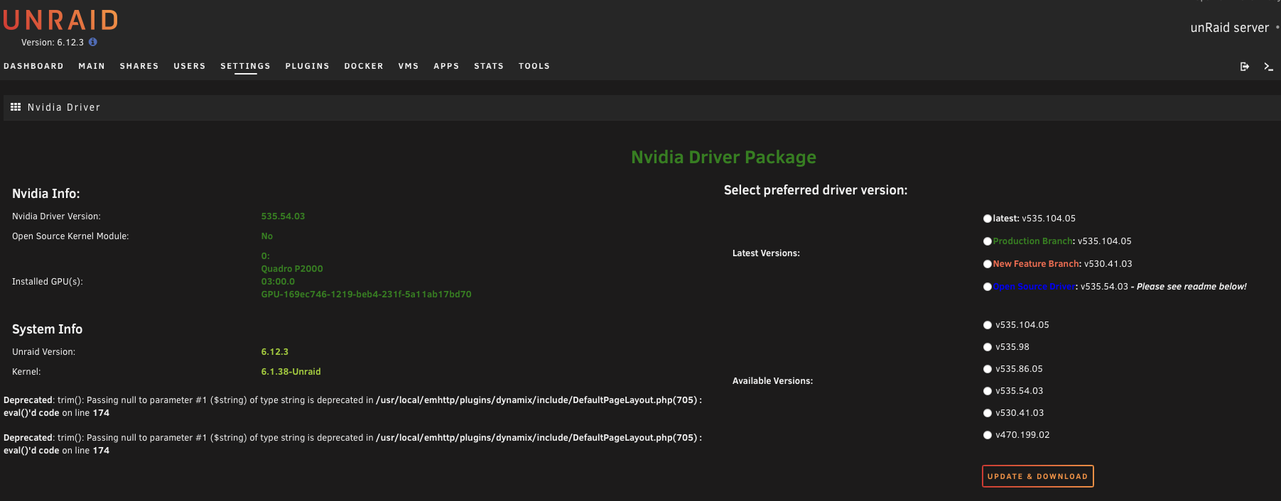

Just updated the plugin to the latest version (2023.08.31)
But cannot update to any driver version anymore.
There is a deprivation notification now.
When I try to update to latest I get the following message:
@ezhik & @giafidis thanks for the report.
I've now update the plugin_update_helper which is part of most third party driver plugins.
The upgrade process should now work as intended when you have set the Production Branch or New Feature Branch in the plugin and should not switch back to the Latest branch (which is currently also the Production Branch version).
The background to why it fails is that version 535.98 doesn't follow the usual versioning scheme from Nvidia and is missing .xx and comm can't compare if the versions numbers are not the same scheme.
Made a update to the plugin a few months ago but completely forgot to also update the plugin_update_helper, sorry...
BTW Please always report such issues in the appropriate support thread from the plugin, because the Nvidia Driver is strictly speaking not part of Unraid since it's a third party plugin.
@limetech included graciously a check for the plugin_update_helper to make sure that users are on the latest version, even if it's not part of Unraid.
Anyways, here are the tests with the updated version:
Downgrade to 6.12.13 and set the version to Production Branch (please ignore that no card is found because I currently have no card in my Test server) :
Pull the upgrade over the built in updater:
Wait for the notifications to say it is safe to reboot:
After the reboot check if it still at Production Branch:

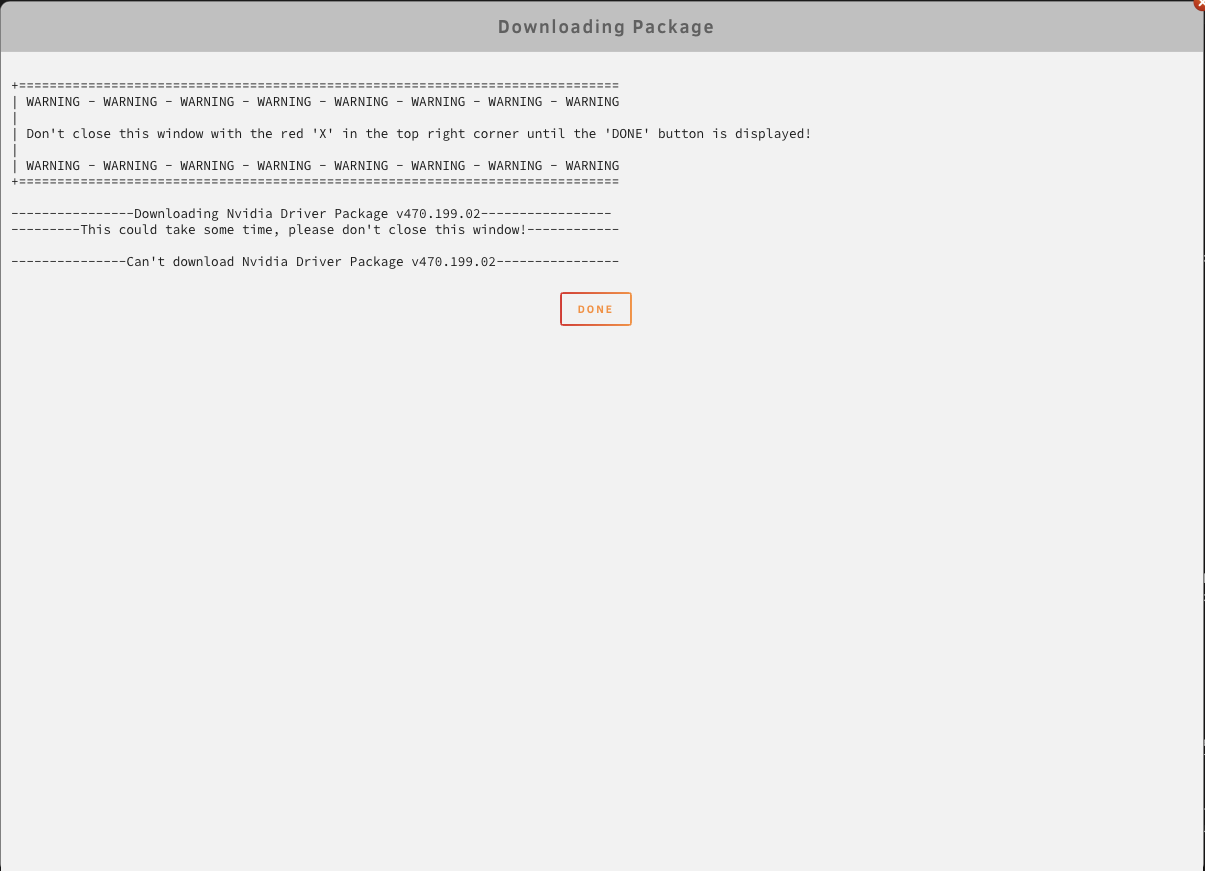

Please try if you can download that file from your local PC: Click
Nothing has changed in terms of the download routine.
Please uninstall the plugin, reinstall it and see if that helps (a reboot in between would be also recommended).
Reinstalling the plugin seems to resolve the problem. (without reboot in between)
During the reinstall, driver version v535.104.05 has been downloaded.
I still have to reboot the server. This will be done somewhere this weekend since I'm not at home at the moment.
