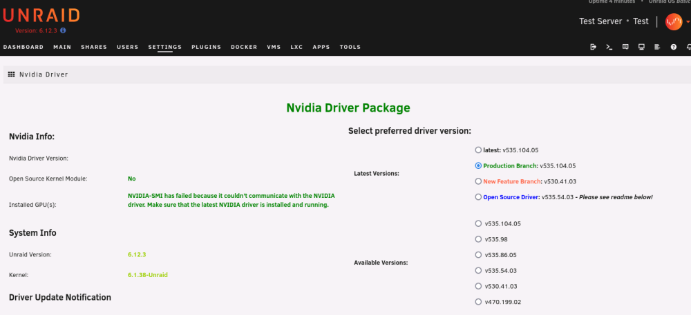

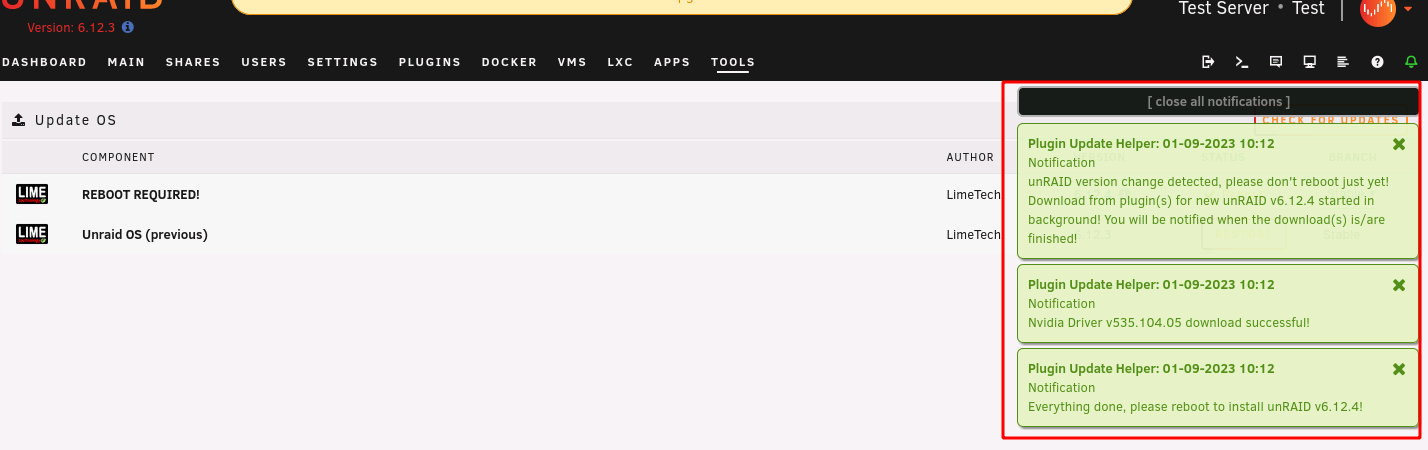

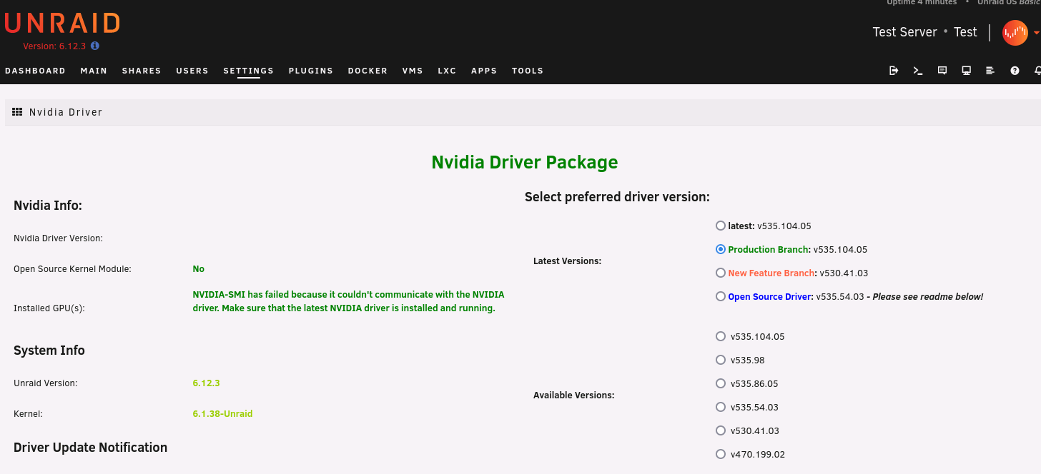

4 hours ago, ich777 said:
@ezhik & @giafidis thanks for the report.
I've now update the plugin_update_helper which is part of most third party driver plugins.
The upgrade process should now work as intended when you have set the Production Branch or New Feature Branch in the plugin and should not switch back to the Latest branch (which is currently also the Production Branch version).
The background to why it fails is that version 535.98 doesn't follow the usual versioning scheme from Nvidia and is missing .xx and comm can't compare if the versions numbers are not the same scheme.
Made a update to the plugin a few months ago but completely forgot to also update the plugin_update_helper, sorry...
BTW Please always report such issues in the appropriate support thread from the plugin, because the Nvidia Driver is strictly speaking not part of Unraid since it's a third party plugin.

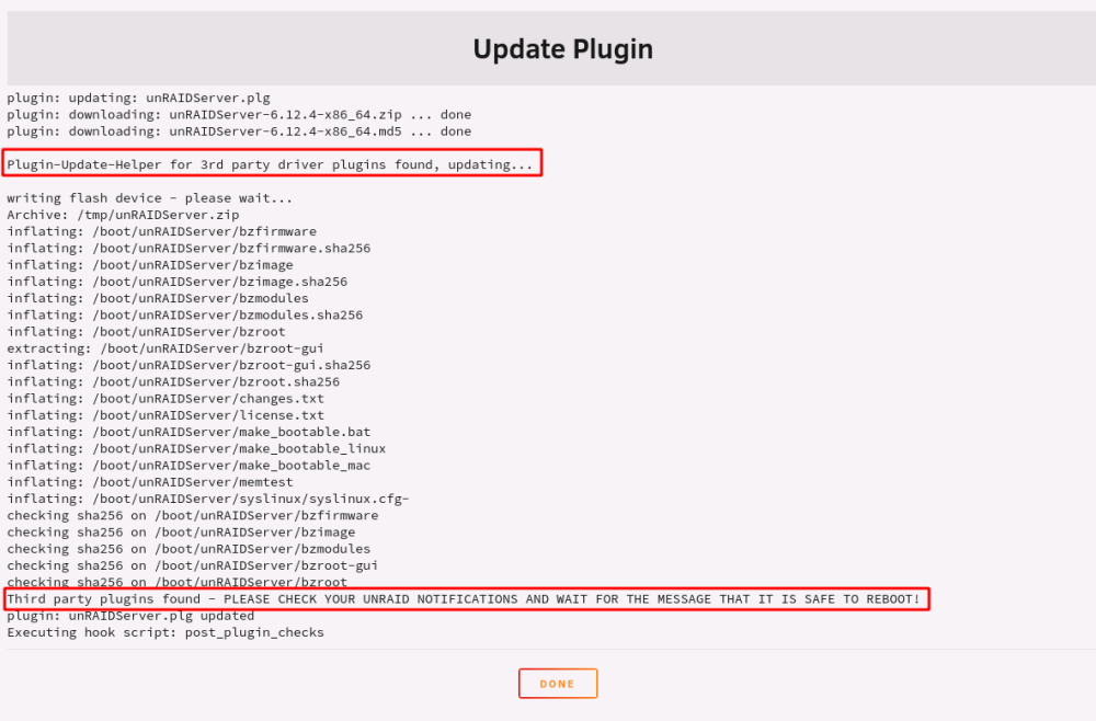

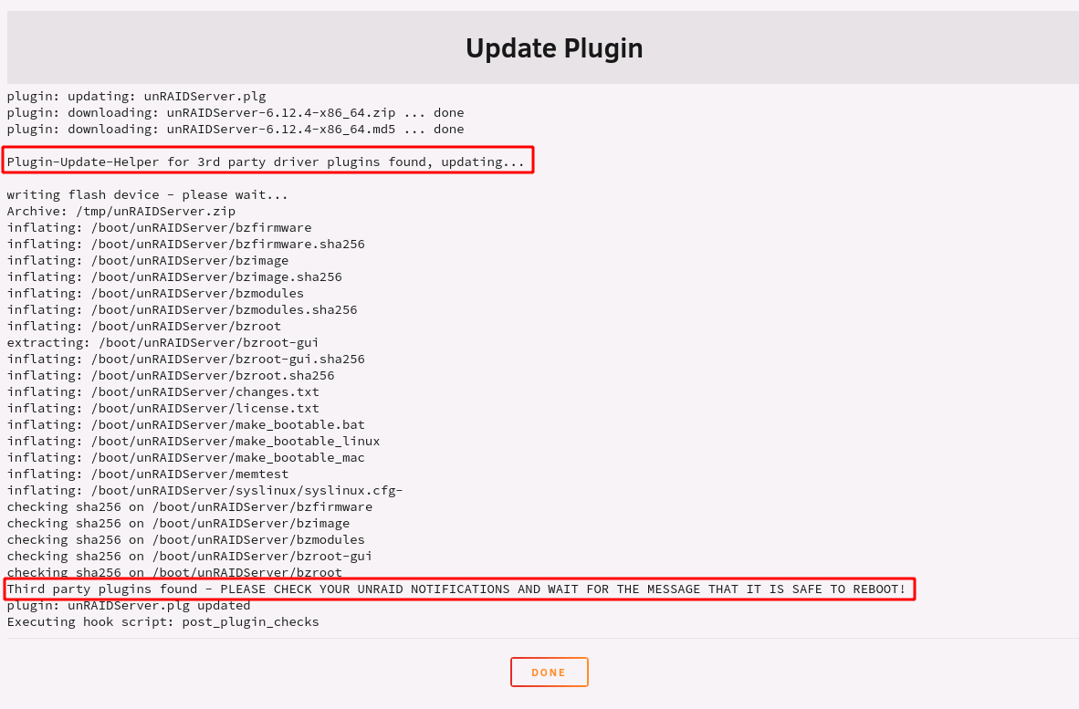

@limetech included graciously a check for the plugin_update_helper to make sure that users are on the latest version, even if it's not part of Unraid.
Anyways, here are the tests with the updated version:
Downgrade to 6.12.13 and set the version to Production Branch (please ignore that no card is found because I currently have no card in my Test server) :
Pull the upgrade over the built in updater:
Wait for the notifications to say it is safe to reboot:
After the reboot check if it still at Production Branch:
Much appreciate, and I apologize for reporting a plugin issue within the release thread. You are correct, should have been done here.
As always, THANK YOU!

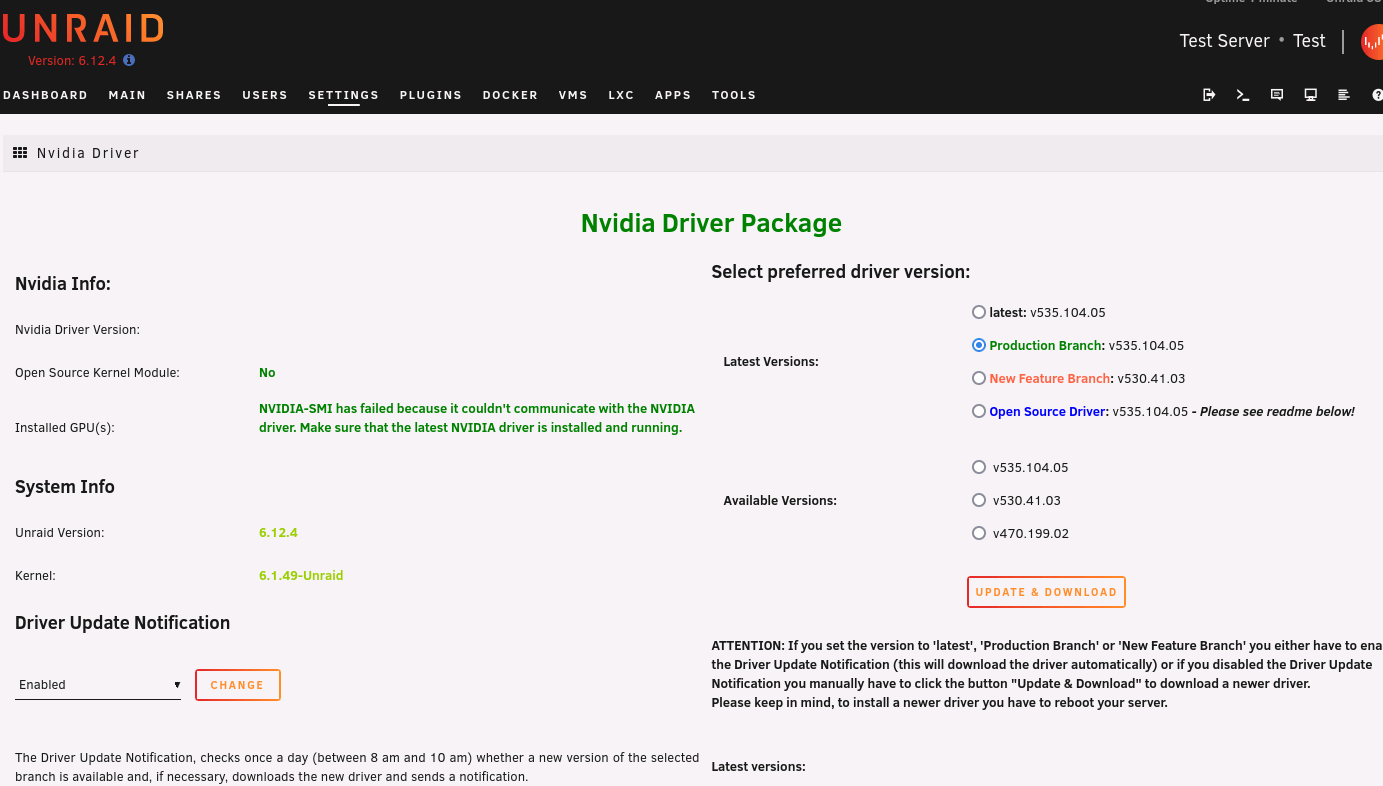

Hi, i can't use my nvidia cards anymore after update to 6.12.4. I updated the plugin before the upgrade. But it's gone in the installed plugin. Downgraded to 6.12.3 and tried to install the plugin again but still getting errors.
Install Plugin
plugin: installing: nvidia-driver.plg Executing hook script: pre_plugin_checks plugin: downloading: nvidia-driver.plg ... done plugin: downloading: nvidia-driver-2023.08.31.txz ... done +============================================================================== | Skipping package nvidia-driver-2023.08.31 (already installed) +============================================================================== -----ERROR - ERROR - ERROR - ERROR - ERROR - ERROR - ERROR - ERROR - ERROR------ ---Can't get latest Nvidia driver version and found no installed local driver--- plugin: run failed: '/bin/bash' returned 1 Executing hook script: post_plugin_checks
What can i do to fix this?
Please uninstall the plugin, upgrade to 6.12.4, reboot, install the plugin again.
How to uninstall the plugin as i can't find it in the plugin view anymore?
Then it's not installed, make sure that you have no Plugins Error tab on the Plugin page.
Then simply upgrade to 6.12.4 and then pull a fresh copy from the CA App, but only after the reboot, I would recommend that you reboot after installing the Nvidia Driver plugin again.
Yes, it's working again. Thank you
Did you wait with the reboot until you received the Unraid notification that it is safe to reboot when doing the first update to 6.12.4?

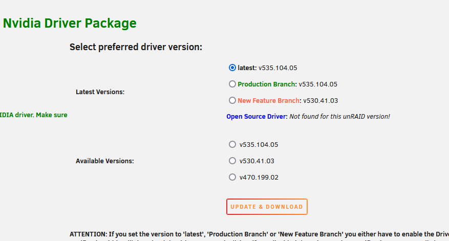

Is it possible that the Open Source drivers cannot be installed on 6.12.4 ? I have a message saying that these drivers cannot be found for this version of Unraid instead of a radio button next to Open Source in the choices (Latest, New features, Production)
Edited by vizi0n
If this is the case then they are not available, correct. 😉
Do you need them?
I had to recompile the drivers manually for this version and maybe forgot to upload them <- with that I mean that I definitely forgot it if they are not available.
EDIT: The OpenSource driver is now available, please go again to the Nvidia Driver plugin page (if it doesn't list them yet, try again in about 15 minutes).
I had reverted back to 6.12.3 in order to install them again. I don't have a choice because I'm running a 1660 and the regular drivers will prevent Unraid from booting, so Open Source driver is the only option for me.
Thanks, I will upgrade again tomorrow and look again.
Now on 6.12.4 and it even upgraded to a more recent OpenSource version. Great ! Thanks :)
This is definitely strange, are you sure that there is nothing else wrong?
Do you have any Diagnostics or better speaking a picture what message that it outputs?
