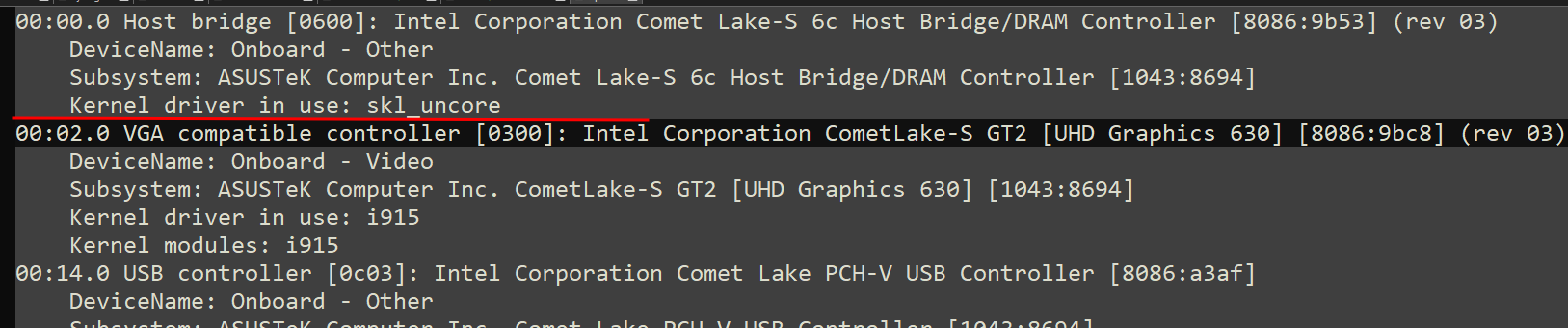

I'm trying install OBS docker.
I Installed Nvidia driver but it1s with this error.
may post your diagnostics
29 minutes ago, Braulio said:
Tks
actually, are you sure you have the GPU properly installed ?
i dont see any hardware in your pcie devices ... while if its in the main PCIe slot it would be most liekely 00:01...
and its empty like nothing is installed (hardware), may check if its properly seated and power connected ... if so, may start with a live USB Stick and see if it works ...
Ohhh, I undertand now...
I don't have an external video card.
I am using a video card integrated into the motherboard, as my server is just for running a VM and file server.
In this case, I can't install an OBS docker, correct?
ehm ... you have a Intel iGPU ...
actually i dont know if OBS can make use of it, but i assume, yes ... different setup then, /dev/dri ...
