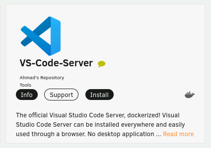

24 minutes ago, tischer.s said:
VSCodeServer (tightly integrated)
Why not on Unraid?

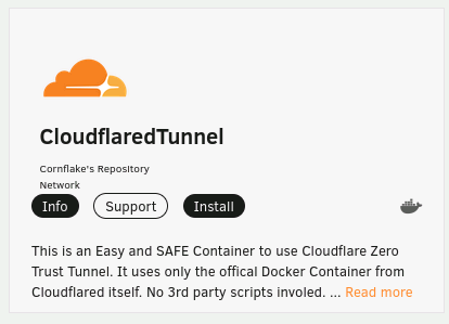

25 minutes ago, tischer.s said:
Cloudflared
Why not on Unraid?

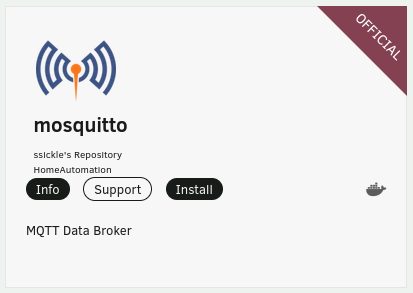

MQTT (this can be easily excluded :D)
Can be also done on Unraid (but let's exclude it here :D )?

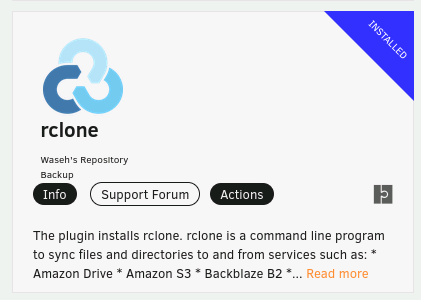

26 minutes ago, tischer.s said:
HASS Google Drive Backup
Why not with Unraid (rclone)?

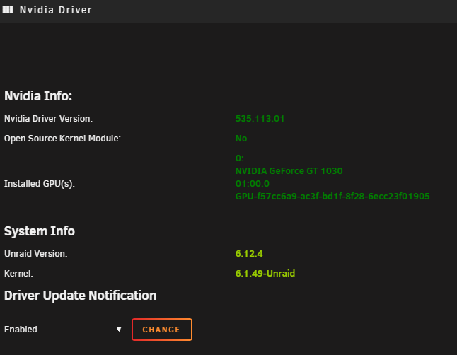

Nvidia Driver:
root@Vesper:~# nvidia-smi
Wed Oct 18 11:46:10 2023
| NVIDIA-SMI 535.113.01             Driver Version: 535.113.01   CUDA Version: 12.2     |
| GPU  Name                 Persistence-M | Bus-Id        Disp.A | Volatile Uncorr. ECC |
| Fan  Temp   Perf          Pwr:Usage/Cap |         Memory-Usage | GPU-Util  Compute M. |
|                                         |                      |               MIG M. |
|   0  NVIDIA GeForce GT 1030         Off | 00000000:01:00.0 Off |                  N/A |
| 44%   31C    P0              N/A /  30W |      0MiB /  2048MiB |      1%      Default |
|                                         |                      |                  N/A |
| Processes:                                                                            |
|  GPU   GI   CI        PID   Type   Process name                            GPU Memory |
|        ID   ID                                                             Usage      |
|  No running processes found                                                           |

Error from Homebridge on Docker start:
[10/18/2023, 8:00:48 AM] [homebridge-unifi-protect] Hardware-accelerated decoding and encoding using qsv will be unavailable: unable to successfully validate capabilities.
Did I skip a step?
2 hours ago, bjsmith911 said:
Did I skip a step?
As the error implies:
It seems like the container want to use QSV (Quick Sync = Intel), maybe a configuration error but I can't tell because I don't know the container and this question would be better suited for the support thread from the container.
Please keep in mind that the GT1030 can only transcode h264 not h265 because it's based on the now very old Kepler architecture.
Oh. That's what QSV is. I gotcha; looking for the Intel iGPU (which I wasn't using as that's been assigned to Plex). Thank you!
@bjsmith911 the GT1030 has no NVENC at all ... so no transcode at all, only decode h264 and hevc h265 but no encode ... so prolly no card for your "workload" ... rather look to get your igpu also in there (iGPU can run simultan plex and other dockers)

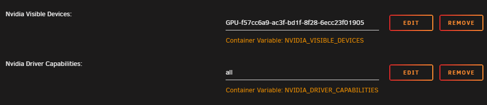

Hey guys, I seem to have trouble getting hardware transcoding working with plex. Right now, all files that need to be converted become transcoded via the CPU. So, my diagnostics and configuration are attached.
The error log I get through plex:
Oct 20, 2023 16:41:45.123 [22821048994616] ERROR - [Req#44b3/Transcode] [FFMPEG] - Cannot load libcuda.so.1
Oct 20, 2023 16:41:45.123 [22821048994616] ERROR - [Req#44b3/Transcode] [FFMPEG] - Could not dynamically load CUDA
Oct 20, 2023 16:41:45.140 [22821048994616] ERROR - [Req#44b3/Transcode] [FFMPEG] - Cannot load libcuda.so.1
Oct 20, 2023 16:41:45.140 [22821048994616] ERROR - [Req#44b3/Transcode] [FFMPEG] - Could not dynamically load CUDA
Oct 20, 2023 16:41:45.146 [22821048994616] ERROR - [Req#44b3/Transcode] [FFMPEG] - Cannot load libcuda.so.1
Oct 20, 2023 16:41:45.146 [22821048994616] ERROR - [Req#44b3/Transcode] [FFMPEG] - Could not dynamically load CUDA
Oct 20, 2023 16:41:45.156 [22821048994616] ERROR - [Req#44b3/Transcode] [FFMPEG] - Cannot load libcuda.so.1
Oct 20, 2023 16:41:45.156 [22821048994616] ERROR - [Req#44b3/Transcode] [FFMPEG] - Could not dynamically load CUDA
Things I have tried over the last two weeks so far:
  1. Restarting the server.
  2. Restarting the docker container plex. 3
  3. Double checked that yes, I do have a plex pass and that I have turned on hardware transcoding in the settings.
  4. Deleting the codecs folder and letter the docker container recreate them with a restart.
  5. Updating drivers in the nvidia plugin.
  6. Switching to older and different drivers in the nvidia plugin.
  7. Uninstalling the plugin, turning off docker containers, reinstalling the plugin, restarting, updating the drivers, and enabling docker containers again.
  8. Remapping the transcoding to happen on RAM via /tpm.
  9. Pulling my Nvidia 1080 card from a vm passthrough and adding it to the pile that can transcode (wondering if my M2000 was the problem) and setting Plex to transcode with all GPUs.
  10. Switching which docker container I used from Plex-Media-Server to just linuxserver's Plex.
  11. Maybe a few other things I forgot that I've done in the last two weeks.
Can someone please help me find a solution to this mission impossible? I feel like with two different dockers, reinstalling the plugins, and with two different working drives, I would have found the problem by now.
As a side note, I hope this isn't related but I'll put it here. I started seeing this issue come up when one of my cache drives failed and started corrupting my entire appdata share. I ended up deleting the whole thing since not even appdata backup could save it--which was devastating in terms of server progress. However, ever since I rebuilt the docker container from scratch, I have never been able to get the docker to transcode using the hardware again.
rocky-diagnostics-20231020-1633.zip
may look at page 1 from this thread, there is a tutorial incl. pics howto add the NV GPU ...
I followed it... multiple times throughout this process. My setup should be correct. I should add, I once had it working but then one day I noticed that my cpu was transcoding a file and then I realized that something stopped working along the way.
