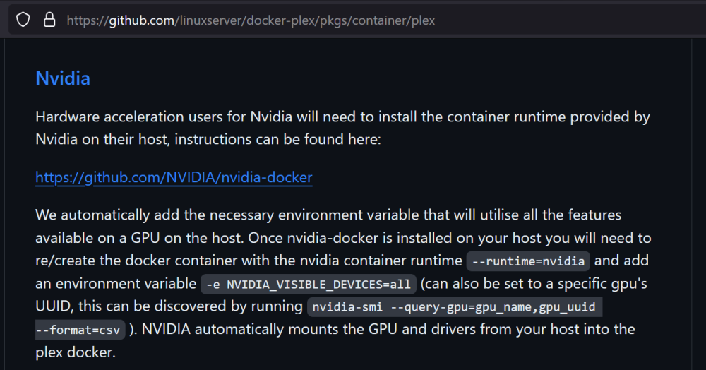

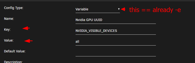

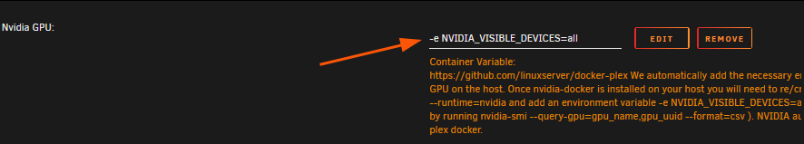

5 hours ago, BrockTrainedAsh said:
My setup should be correct
But it is not.
Look at that:
By doing it like you do it you end up passing two times -e which is ultimately wrong.
It should say: NVIDIA_VISIBLE_DEVICES=<GPUUUID>
I also don't recommend using all because this causes often times issues, decide which GPU you want to use and replace <GPUUUID> with the UUID.
The capabilities are also missing, are you sure you've followed the second post in this thread? There is a step by step tutorial for Plex there:

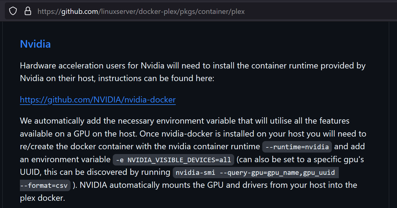

image.thumb.png.4fd019f9e2b651ad664e70e8166f0d8d.pngHey Ich777, thanks for replying. I did have my old configuration as you said when I was using the plex-media-server docker. However, the linuxserver docker instructions are a little different in setting up nvidia passthrough.
However, I did try your recommendations anyway and they didn't work unfortunately.
actually they are the same, just different approach.
this instruction is from cli docker run ... -e NVID.... =all ... while in Unraid you used the GUI, which then are 3 Parts to build this line
by adding this via Unraid GUI
image.png.afafebb74ca980d6269bda2045c43153.png#
this is then "building" the command you see in the lsio instruction, thats the only difference ...
you would see this also when you check the docker run command (after building) that there are in your setup "double -e -e .." and so on ...
in the end, if its not working while using the instructions (either way) may look at your logs and ask in the lsio plex thread what could be the reason.
That was it! That worked! I was just too stupid not to realize the GUI was changing the command. THANK YOU!

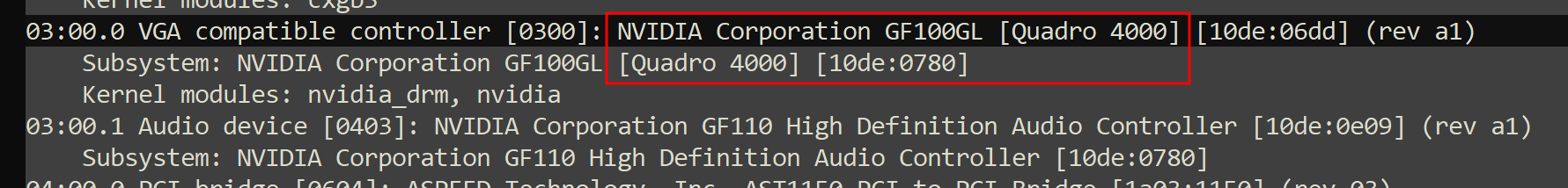

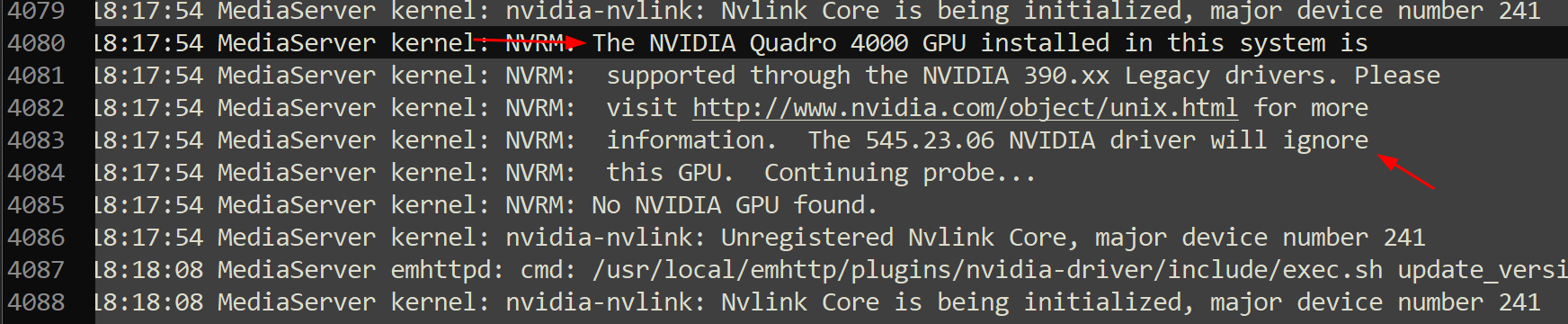

Hi, i found the driver for my Quatro 4000 " NVIDIA-FreeBSD-x86_64-390.157.tar.gz " but now i don't know where or how to install them in unraid, can you help me please ???
André
