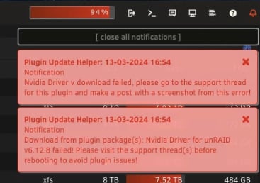

Separate to that actually though. I just updated from Unraid 6.12.4 to 6.12.8 and I got this driver download error. It said in the OS update dialog that I should hold off rebooting until this is sorted.
Do you have a active Internet connection on boot? So to speak no Firewall or AdBlocking running on Unraid which would prevent Unraid accessing the Internet on boot?
It should be safe to reboot if you have a active Internet connection since the plugin tries to download the driver on boot too, but keep in mind that the boot maybe takes a bit longer since it has to download the driver (about 200MB).
If you don't have a active Internet connection uninstall the driver, reboot and install the driver again -> maybe reboot after that again or simply restart the Docker service.

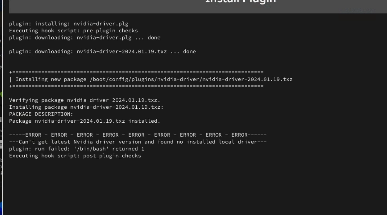

I thought I would have an active internet connection on launch. I Rebooted but it was showing as a plugin error so I deleted it from that page and rebooted then tried installed the plug in again, but got this error when trying to install it
Edited by skwisgaarz
Do you have any Unifi network gear or AdBlocking on your network?
Please make sure that your Server is able to communicate with the GitHub API.

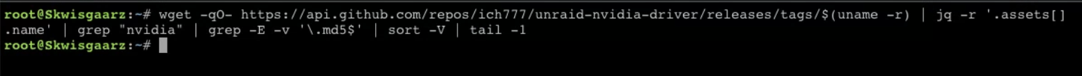

Please open up a Unraid Terminal and execute this command:
wget -qO- https://api.github.com/repos/ich777/unraid-nvidia-driver/releases/tags/$(uname -r) | jq -r '.assets[].name' | grep "nvidia" | grep -E -v '\.md5$' | sort -V | tail -1
It should return:
nvidia-550.40.07-6.1.74-Unraid-1.txz
If nothing is returned then something is blocking the access to the GitHub API on your network.

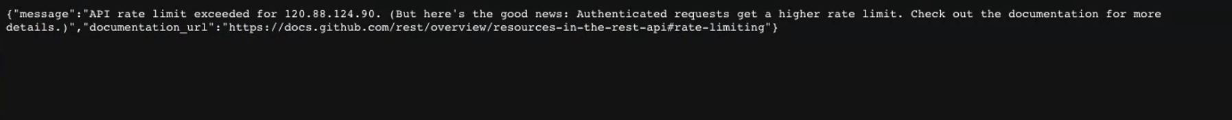

I'm just running an asus router, no firewalls or adblocking on my network. In the past I've been able to download the drivers fine with the same network set up.
I ran that command but the terminal does nothing. Not sure if this is relevant but I clicked on the url in the command on a device on the same network and I get the attached api error.
Also, again not sure if this is relevant but I tried pinging github.com from the terminal and I get a response.
Are you using the GitHub API?
I can only think that you are behind a CG-NAT and your public IP is shared with other users from your ISP and someone is using the GitHub API quiet heavily.
Could that be the case or do you have a dedicated public IP address?

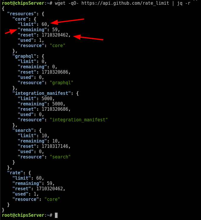

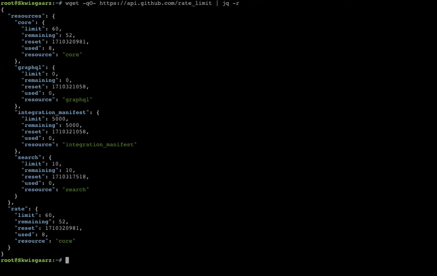

8 minutes ago, skwisgaarz said:
relevant
You can run this command:
wget -qO- https://api.github.com/rate_limit | jq -r
There you can see information about the GitHub rate limit:
The free tier is 60 and right below that line you can see the remaining ones, you will also see the reset time which is displayed in a Unix timestamp that you can convert here.
Maybe try to convert the reset time on the linked page above and try downloading the the driver quickly when the reset from the API call is triggered (maybe run the command from above first to see if there are API calls available).
I have a static IP.
Running that rate limit command shows 52 remaining under resources.
Gotta be honest I don't fully understand your last paragraph. Do you mean wait until the reset number from the command lines up with the unix time and try to install the plug in asap after that?
Please run the command again, now, does the number decrease?
So, I noticed in my plug in errors that docker patch had errored for some reason. Deleted that and installed the latest docker patch and the driver installed successfully. Sorry to make you chase this up, I should have noticed that error.
No worries, I think that some container is using your API calls and that's why it is failing sometimes.
Do you have a Docker container installed that monitors uptime or something like that? I remember a few people reporting a similar issue here and they discovered that this container is calling the GitHub API really heavily.
