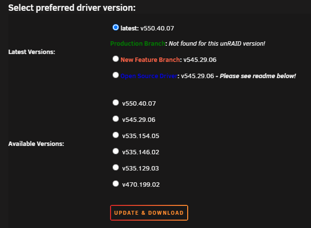

3 minutes ago, CorneliousJD said:
I'm just not clear if I need the nvidia.conf file in the modprobe.d since "latest" right now seems to be the open source driver
Can you send me a screenshot please?
Latest should never be the open source one.
The open source option is a dedicated option and not bound to latest, production, new feature branch or a static version listed below. The version numbers might be the same but the open source is a completely separate package and should never be latest.
Just stick with latest, that should be fine.
Ok thanks - that's where my confusion was, the Latest and Open Source were the same version number, and I assumed that it was auto-selecting the open source option.
I understand how that I look at it a bit deeper (Today is the first day I've seen this plugin page option)
Sorry for the confusion, but thanks for the explanation! :)

I too am having a recent issue where nVidia HW transcoding used to work perfect, but recently I have been troubleshooting system issues and now that I think I have my system stable I have noticed that my Plex container will NOT use the nVidia GPU at all for transcoding and will only transcode video at all if I disable the option in Plex setting for using HW transcoding if available (then it will fall back to CPU transcoding). I like the previous poster have the same green info (different specific GPU of course) in the Nvidia info section of the nVidia driver settings option page in UNraid but when I have the plex setting enabled for "Use hardware acceleration when available" and "Use hardware-accelerated video encoding" Plex will NOT transcode at all and just sits there with a black player screen and no usage of either CPU or GPU (as shown in GPU statistics on the Dashboard of Unraid). What am I missing? To my knowledge I haven't had any changes to the docker edit settings (advanced) for anything and especially didn't change anything for GPU arguments. Can someone spot an issue? One strange thing is that in the nVidia driver settings page, I see that it shows "
latest: v550.40.07
Production Branch: Not found for this unRAID version!"
(I am on Unraid 6.12.6)image.png.971279547b110360eea92447e57dab58.png  image.png.453e33e854d215236222291303d285e3.png  image.png.b80541915fc10dfbeb02ec8b5bfbe20a.png  image.png.b427551587a322587e9c0f19d747d11d.png  image.png.d6652f243e1352e509716de7dcb253af.png

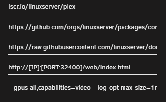

I created a Nvidia docker using the plex template as a base for my template choices:
and i did add the 2 variables to the Nvidia template:

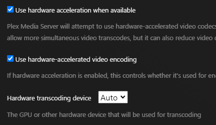

I have nothing in my transcoder log, nor could i get it to show up on my plex transcoder settings.
I also checked in the plex dashboard. I'm not sure what i'm missing to get it to work:
You have to force a transcode, you are using direct play, on your ROKU device you have to lower the quality below 1080p and transcoding should kick in.
You also have to have --runtime=nvidia in the template (in Extra Parameters with advanced view enabled in the template).
Thank You!! I set up the docker as a separate thing versus in the plex docker, it is now working!
