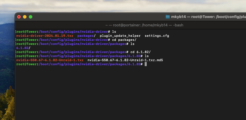

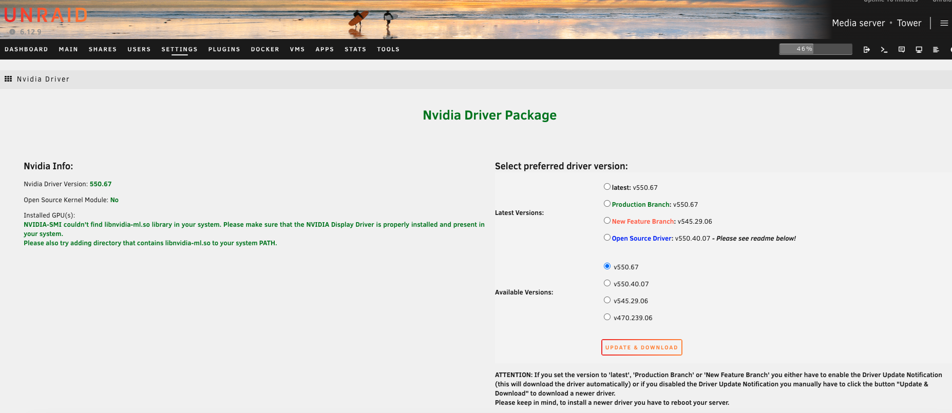

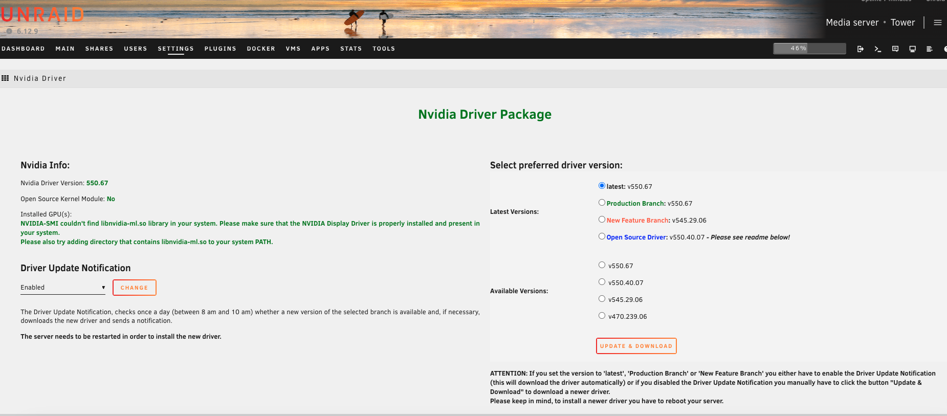

Looking for some direction here.  I've had to remove all my plugins and docker.img.  started adding all the dockers back and got to the nvidia plugin for my p2000.  When doing the update, rebooting , I only get this info on the plugin page...
I'm not sure what directory or file this is referring to.  I can't seem to find anything googling it.

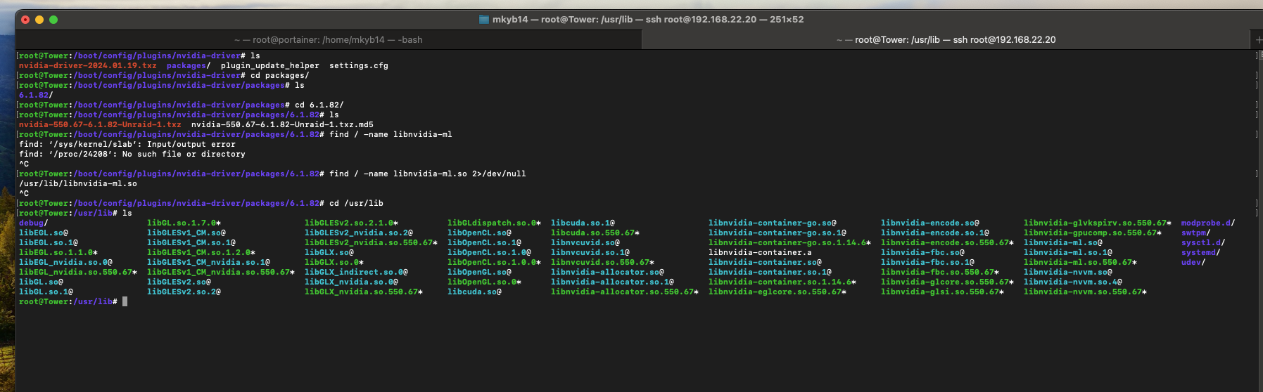

Please post your Diagnostics.
12 minutes ago, mkyb14 said:
added.
Have you yet tried to reboot?
BTW, this is the wrong location the file is located in /usr/lib64 you are actually looking at the 32bit libraries in the screenshot above.
Have you any special scripts in place that maybe modify the PATH variable on your system or something similar?
I can't see anything obvious from your Diagnostics at a first glance.

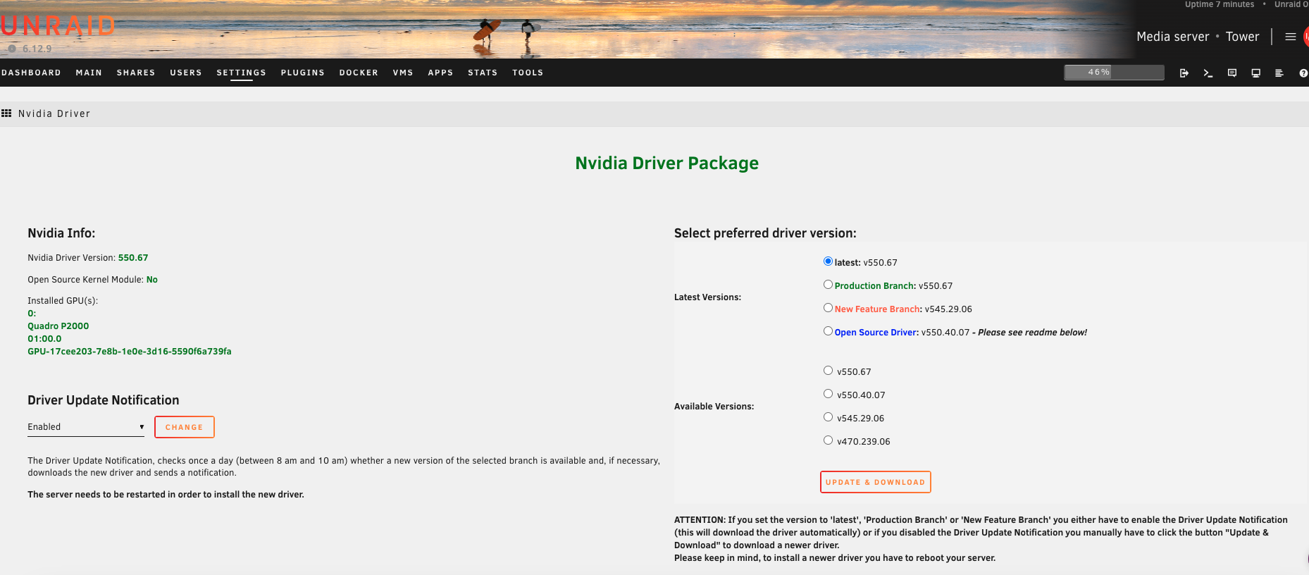

I will remove the plugin and start over.  I removed everything as I was having the system lock up randomly after updating to 6.12.8.  no one could tell me why in other forums... so I booted to safe mode and slowly turned on dockers and then after that plugins and crashed after a while when I had enabled the nvidia one...so I removed everything to start over.
give me like 5 mins and I'll redo the plugin again and post diagnostics again
hmm weird, reboot again just to make sure and now it shows....
10 minutes ago, mkyb14 said:
same result.  remove plugin, re-install, reboot.  plugins, screenshot
Are you really sure that your RAM is okay?
As said my best guess is that there is something wrong with the RAM and the files not installing correctly.
Are you on the latest BIOS version?
There must be something else going on since I also tested this exact driver package and it is working fine over here.

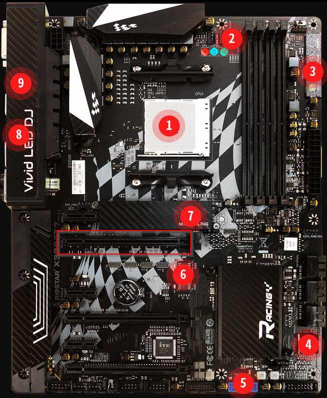

Please also see the slot I have the GPU plugged into..

BTW, I think that your Motherboard supports Resizable BAR support maybe it is named differently.
