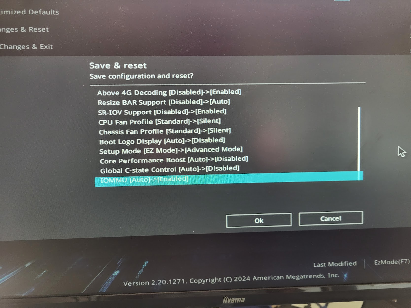

- In the Bios I have only the Option for Resize Bar "disable" or "auto", and it sits on auto.
- "Above 4G Decoding" is ON.
- I thought I have disabled the c-states, but those were actually enabled... Corrected that now.
- PSU is 550 watt from the original build of this PC. Even with the GPU, the whole thing should not need more then 220 watts. So plenty wattage :)
- Pressing "power" 2 times didn't work :( As I dont have speakers in this Case (Jonsbo V4), at least I didn't find cables for the case speaker, I waited at the case, if anything happens... unfortunatly nothing happend. If I do a shut down or restart from the GUI everything is fine.
Yes, I did not unplugg the card inbetween the several installation processes. And yes, the plugin was installed while I generated the diagnostics. I thought this would be better for the informations. But I can unplug the Card, uninstall the plugin and then get a new diagnostics if that would be helpful.
I now have some minutes and will do bios update, control all bios settings and check if anything happens in the GUI.

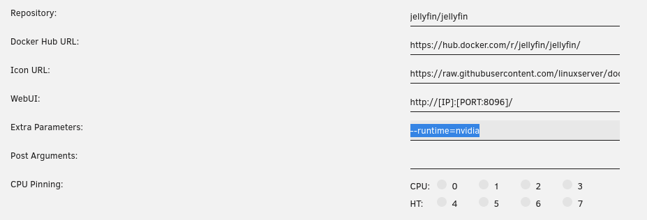

  • To utilize your Nvidia graphics card in your Docker container(s) the basic steps are:   Add '--runtime=nvidia' in your Docker template in 'Extra Parameters' (you have to enable 'Advanced
Please don't forget to disable C-States again after the BIOS update and validate all other settings.

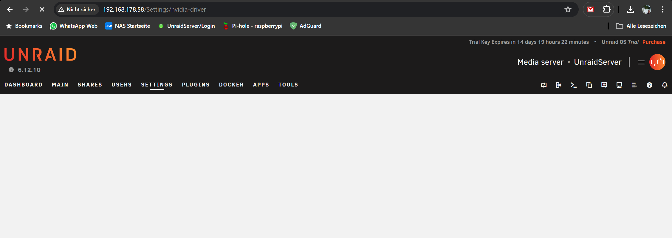

Bios Update is done. All settings should be correct:
Starting the server and entering the GUI I stopped all dockers and installed the plugin again. The opening windows states, everything should be fine:
But unfortunatly, I still can not enter the plugin... The GUI just stoppes working.
Here, 5 minutes after trying to enter the plugin:
As the server is still connected to a display, I can see inputs from the keyboard, which is also still connected.
Wow... Whats this?
As I tried starting the plugin while typing here, I did not do a hard reset as I was looking up how to do a SSH call (yes, I am that kind of a noob). I recognized, that the unraid tab in my browser was not loading anymore. It showed the page with all my installed plugins. I now pressed the plugin button again, and I am in the plugin...

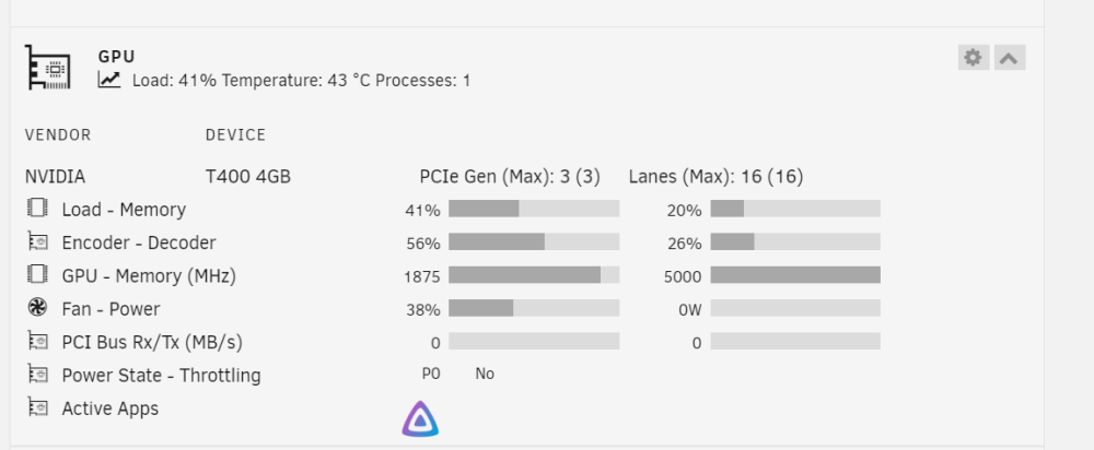

Seems running now. Thank you @ich777 for you support :) Now I will try to add the Card to jellyfin for transcoding. So maybe I will be back in some minutes 😅

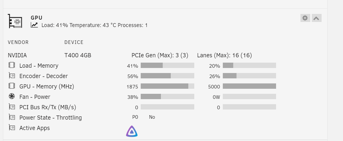

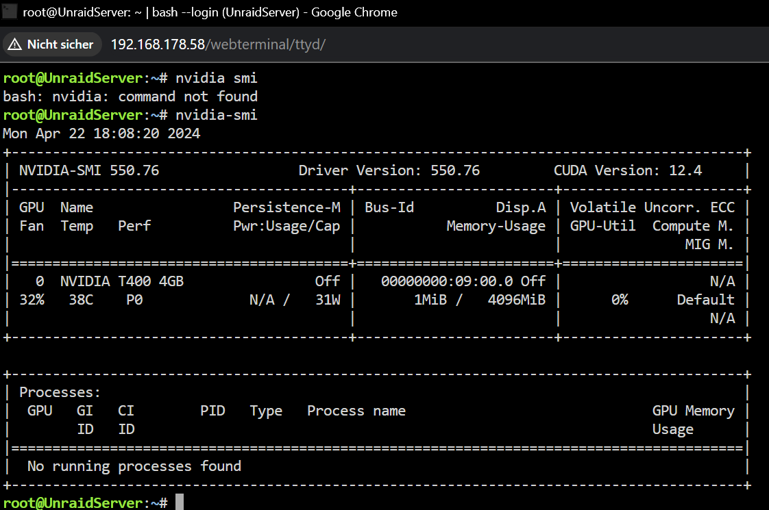

Transcoding on the T400 is working. As I am playing a video in jellyfin, the gpu statistics plugin shows activity on the card :)

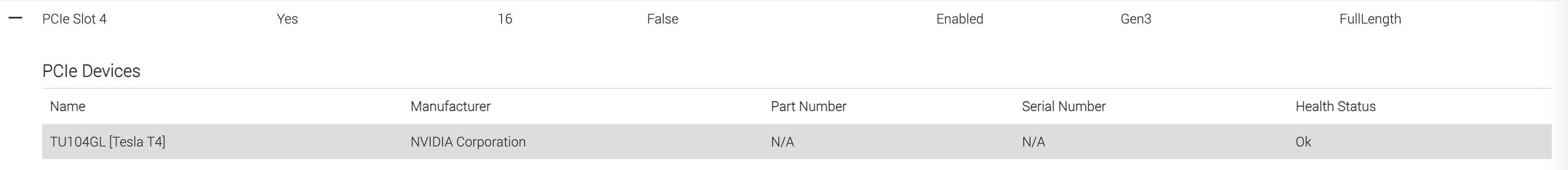

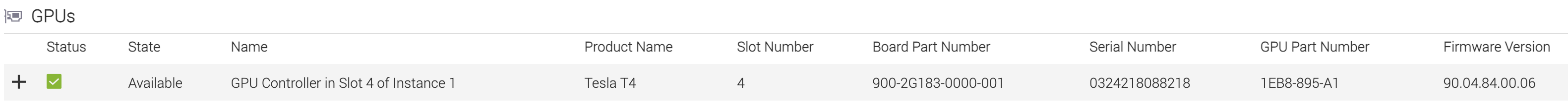

The GPU is also recognized in BIOS/iDrac
1280133543_Screenshot2024-04-23at19_31_52.thumb.png.97621e85a0ae201c5d932079ded96eec.png
131385308_Screenshot2024-04-23at19_32_04.thumb.png.c4b06d320122054ddf8f1ff6448fe94e.png
Is it possible to fix? Could be the GPU broken?

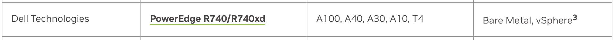

It is also possible that the GPU is not compatible with your server, this would not be the first time that I see a card because it's not Dell, HP,... certified.
it should be compatible..
https://docs.nvidia.com/certification-programs/nvidia-certified-systems/index.html

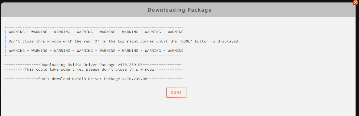

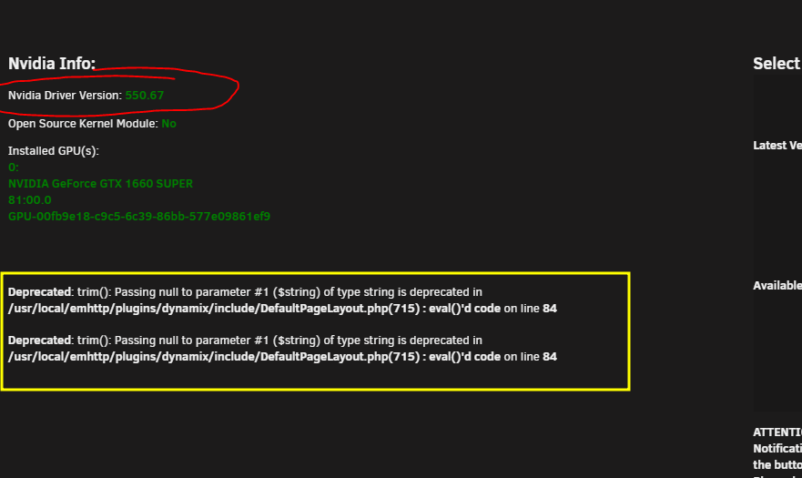

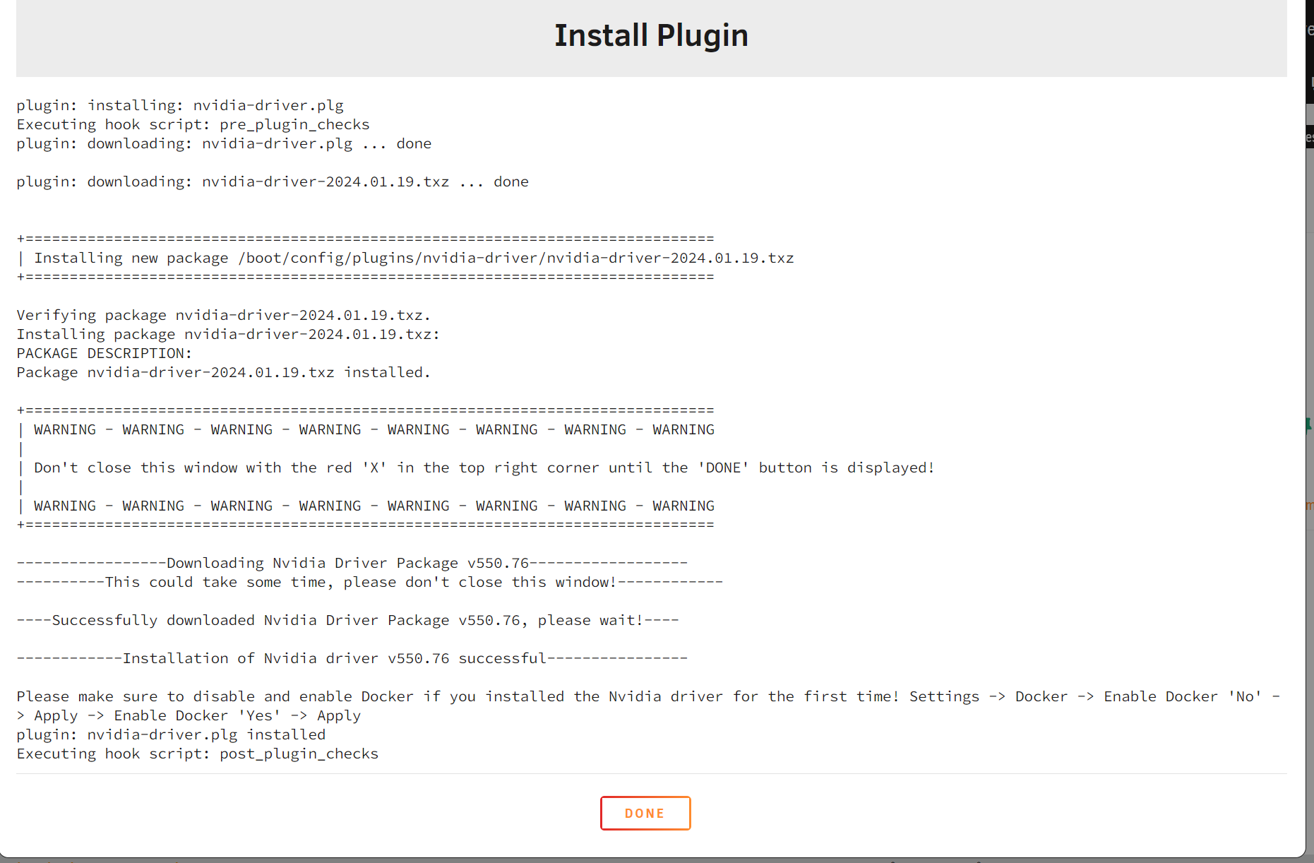

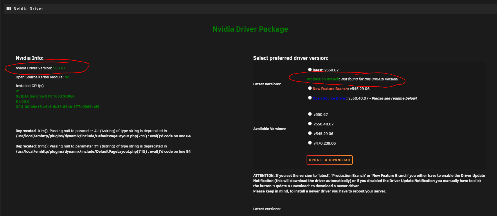

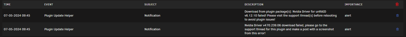

Went to upgrade to Unraid 6.12.10 today and got these errors, unsure what to do.

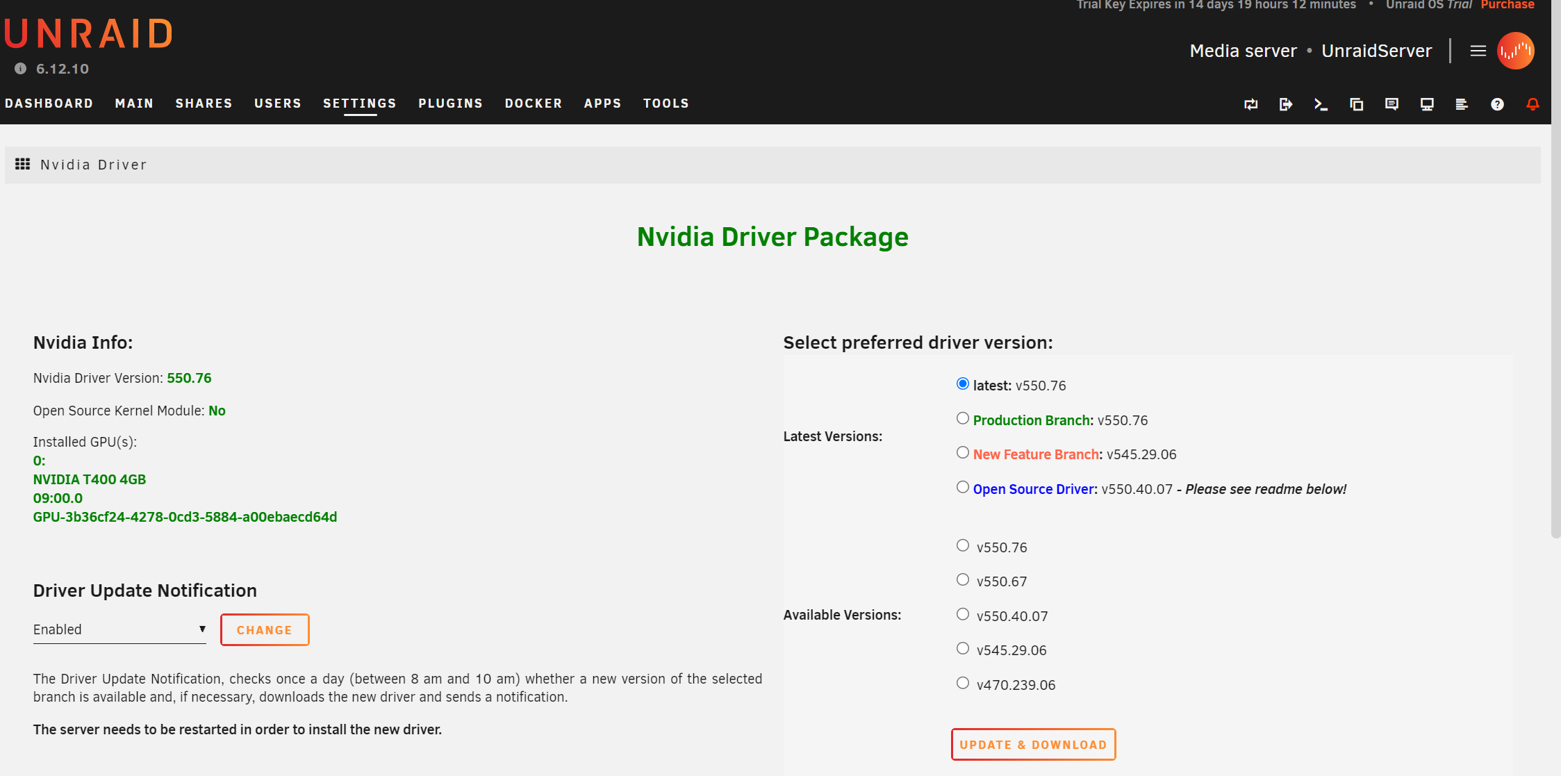

Download from plugin package(s): Nvidia Driver for unRAID v6.12.10 failed! Please visit the support thread(s) before rebooting to avoid plugin issues!
Nvidia Driver v470.239.06 download failed, please go to the support thread for this plugin and make a post with a screenshot from this error!
I don't know why it tried to download v470.238.06, that seems wrong. I have v550.67 installed currently. The production branch is what I use, and now it says that there is no version found for this version of Unraid.
Update: tried to just switch to the latest, but it's still trying to download the wrong version.
Edited by Indi
This is a good indication that something is broken on the Nvidia Driver plugin on your system:
Please uninstall the plugin, reboot, install the plugin again, reboot again.
After doing that everything should work as it should again.
On what Unraid version are you, please try the above procedure first before replying.
I am on Unraid 6.12.9 currently, was just moving up to 6.12.10
The below process fixed it up, things seem to be okay now and I am on 6.12.10
1. Uninstall Plugin
2. Reboot to finish upgrade to 6.12.10
3. Reinstall Plugin
4. Reboot
Hi all,
I've just updated my system and now my 1070 isn't being used to transcode. I've followed the steps above but smi still shows no processes using the GPU when I am actively playing a show in Jellyfin.
Posting here as I feel it's more related to the plugin than Jellyfin, but delete if it's Jellyfins issue. I haven't included logs due to this. Happy to post them if wanted, however.
System:
unraid 6.12.10
Nvidia Driver plugin ver 2021.01.19 (using latest driver v550.78)
Jellyfin 10.9.1
GTX1070 8GB
I originally updated the plugin and rebooted, then came to the support page and followed the steps below.
disabled hardware accel. in jellyfin
uninstalled plugin
rebooted
installed plugin
rebooted
re-enabled hardware accel.
rebooted
played an episode
opened unraid console and checked smi
Edited by RancidGnar
Adding comment about lack of logs
Did you also add this:
Are you also sure that you force a transcode, if you just play media and the client is able to play it natively then no transcoding would happen.
To force a transcode, play some media, click on the gear icon in the Jellyfin player and select something really low:
(I would also recommend that you make sure you play some media that is maybe 1080p with a relatively high bitrate so that a transcode is necessary)
If you still have issues please also post your settings from Jellyfin itself for transcoding, a full screenshot from your Docker template with Advanced View enabled and your Diagnostics.
