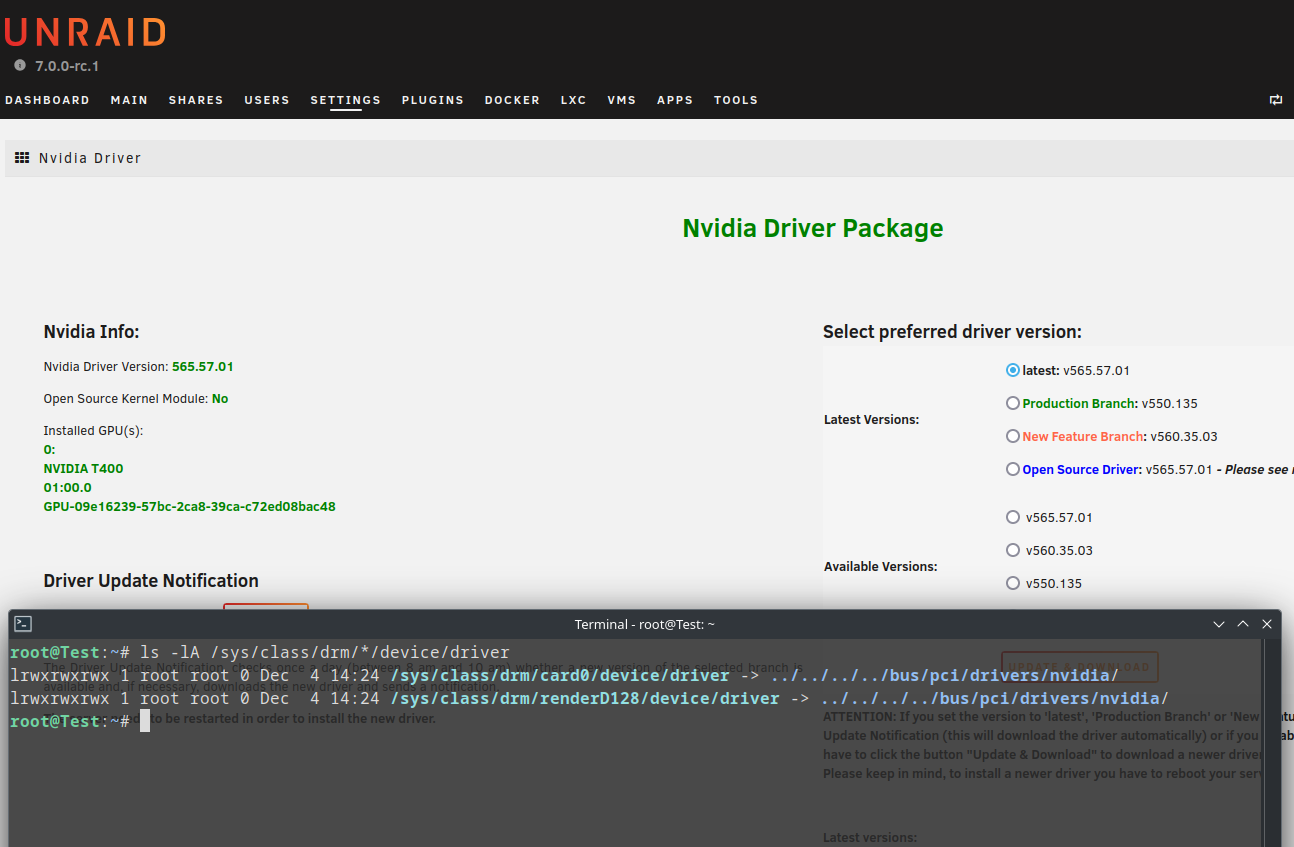

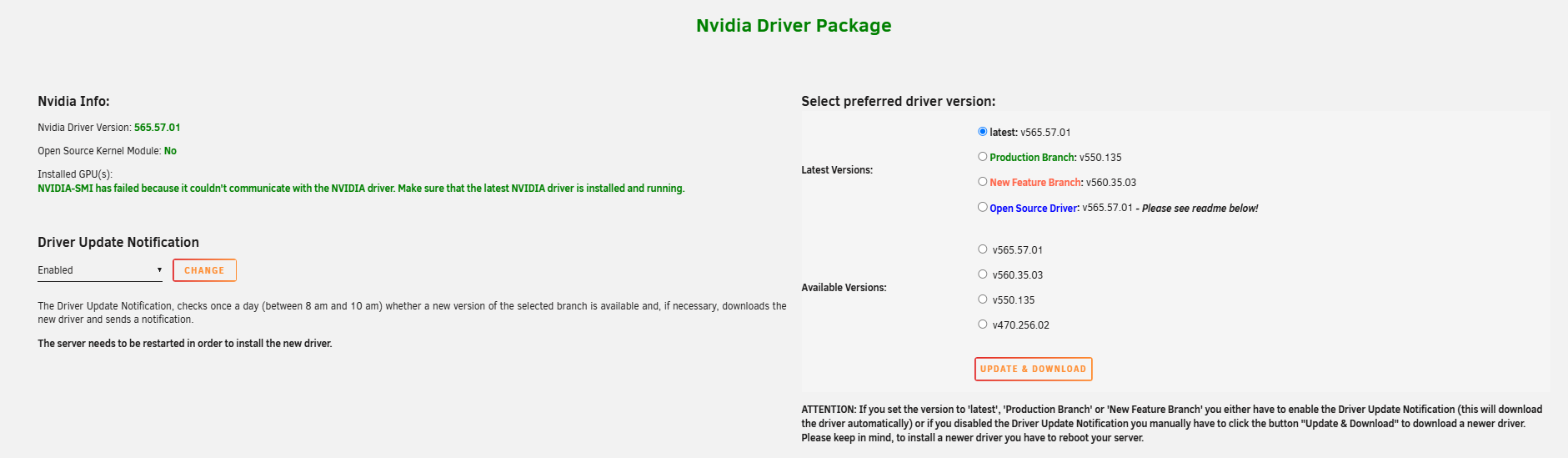

After upgrading to rc-1 I noticed kasm stopped working. Upon further investigation it seems the latest 565 driver does not create the requisite /sys/class/drm entries. Downgrading to 560 "new feature branch" fixes it.
Unsure if this is an issue with the plugin, the nvidia driver, or rc-1, but posting here first since if nothing else I'll be redirected accordingly.
Edited by Spitko
Thank you for the report, I will look into this ASAP and report back!
Sorry but I can't reproduce this over here and everything seem to work totally fine:
Even transcoding works fine:
It would be super helpful if you could pull the Diagnostics next time when this happens so that I can take a deeper look why it was not working for you.

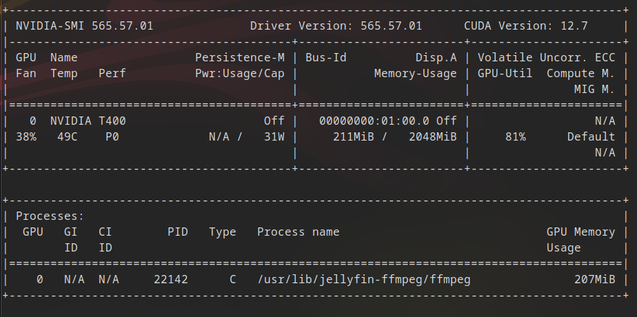

Hi @ich777,
I am having an issue with Jellyfin transcoding ffmpegs. I read through a few of the previous posts on this issue and the solutions there don't seem to be what I am looking for.
Based on the versioning issue shown in the log I updated the driver, but for some reason this still seems to be an issue. Any direction you can point me in would be helpful. Thank!
Nvidia-smi screenshot as well:
error_log.txt
Please post your Diagnostics.
Have you read the second post on how to pass through the GPU to a container?
What container (repository) are you using?
Are you on a really old version from Unraid or why are you on Nvidia Driver version: 545.29.06?
Please upgrade to a newer version from Unraid to get newer drivers since this seems to be your issue:
[h264_nvenc @ 0x5618f57a3040] Driver does not support the required nvenc API version. Required: 12.2 Found: 12.1
I didn't realize I was so far behind on my Unraid version. I updated that and it looks like everything is working now. Thank you for your quick reply and help!
