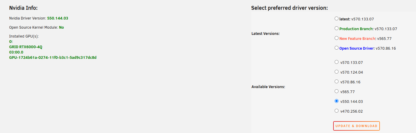

4 hours ago, bmartino1 said:
I would recommend dropping to v550 as well. the newer NVIDIA driver for linmux is staring to drop support for older cards.
Where are you taking these information from? This is completely not true. Please don't spread wrong information on the forums.
Please also note that you are using a GRID card which is basically a datacenter card and not meant to be run with the consumer driver and therefore you could run into issues, it is not even listed as supported for the 550 driver version:
https://www.nvidia.com/en-us/drivers/details/240524/
I have now tested the newest driver 570.133.07 and it is working just fine with Plex. You are even not on the same Unraid version as the user that you answered to.
This makes me wonder, if you are not on the same version, why was it working for the user that you answered to on the Unraid version you are currently on and why is it not working for you, could it be possibly an issue with Plex?
Have you read this here:

Hi, sorry to be a pain. I wondered if it was possible to have the latest 570.133.07 Open Source Kernel Module drivers on Unraid 7.0.1? Thanks
Sorry currently I only compile the latest driver version from the open source driver which is available at the release from the Unraid version you are running.
This might change in the future but for now it is what it is, however if you are willing to upgrade to 7.1.0-beta.1 (which is stable since I run that on my production Server where I also compile and create the plugin packages for the 3rd party driver plugin) then you would be able to download this driver.
Background to that is that the plugin is in it's current state not fully able to detect the correct version if there are multiple version from the OpenSource driver in the repository available.
I hope that somehow helps, sorry for not having better news currently.
