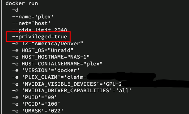

Hi @ich777,
Final update
I was able to fix the issue 🙂
I used a new flash drive and fresh Unraid 6.12.15 install to rebuild my server from scratch.
When I booted up the array for the first time, all of my data and dockers came back. I then did a fresh install of the Nvidia driver plugin, and to my amazement I still had the nvidia-container-cli permissions issue when starting Plex w/ my gpu passed through.
To fix, I found that an specific order of operations key:
My first attempt: 1) delete docker.img, 2) reinstall Plex docker and configure gpu passthrough, 3) install Nvidia driver, 4) disable + enable docker, 5) restart.
This failed - I encountered the nvidia-container-cli permissions issue again on my next boot.
Attempt two: 1) disable docker, delete docker.img, enable docker, 2) install Nvidia driver, 3) disable + enable docker, 4) install Plex docker and configure gpu passthrough, 5) restart.
WORKS!!
For some reason, it was crucial that I a) delete my docker.img and then b) install the Nvidia driver first before any of my old dockers.
I do wonder if deleting my docker.img and the other steps I took would have fixed the issue in my original Unraid install but I'm not going to get hung up on that.
This saga is finally at an end. Thanks for all of your help!

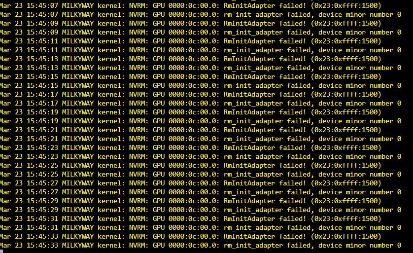

Hi All,
I'm currently having issues getting my 5070 ti not being detected. Currently running on 7.1.0-rc1 due to battlemage support.
Plex docker detects it with the app, and VMs can see it but the NVIDIA plugin is returning no devices.
Plugin
Plex
VM
I do see interesting logs but from the driver plugin i can't use the open source ones
diagnostics-20250412-1042.zip
Please go to the plugin page again and select the Open Source driver (blue one), click Update & Download, wait for the download to finish and reboot your server.
