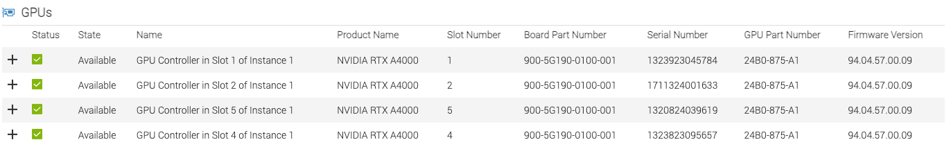

I only noticed this because of throttling when running the models, I have not tried to control the fans before finding out that the fans do not run. The cards are all the same with the same firmware on all 4.
I tried to control fanspeed to see if I could fix the issue
I know it works with 2 cards, since when testing ollama with 2 cards i did monitor fan speed and temps
Edited by Output
added info
Usually the fans or better speaking the fan curve is stored in the vBIOS and controlled by the card itself, the driver on it's own by default does nothing to the curve nor to fan control.
When you issue the commands that you wrote above you get no output but usually it also won't change anything because these commands do not work on Unraid.
Are those probably branded HP or Dell, it might be possible that their management software does in fact is responsible for the fan curve and even if the Firmware seems the same it must not be the same if they are branded differently.
All 4 cards are dell cards, only serial numbers differ:
In the bios, I cant find a way to control the fan curve, but as I said, 2 cards work fine.
Running the commands, to set fan speed control to automatic actually seems to do something:
Attribute 'GPUFanControlState' ([gpu:0]) assigned value 0.
Attribute 'GPUFanControlState' ([gpu:1]) assigned value 0.
Attribute 'GPUFanControlState' ([gpu:2]) assigned value 0.
Attribute 'GPUFanControlState' ([gpu:3]) assigned value 0.
But it does not change the actual fan values, GPU1 & 2 are fan 41% and GPU2-3 are fan 0%
Running commands:
nvidia-settings -c :0 -a [gpu:0]/GPUFanControlState=1 -a [fan:0]/GPUTargetFanSpeed=50
nvidia-settings -c :0 -a [gpu:1]/GPUFanControlState=1 -a [fan:1]/GPUTargetFanSpeed=50
nvidia-settings -c :0 -a [gpu:2]/GPUFanControlState=1 -a [fan:2]/GPUTargetFanSpeed=50
nvidia-settings -c :0 -a [gpu:3]/GPUFanControlState=1 -a [fan:3]/GPUTargetFanSpeed=50
output in terminal:
Attribute 'GPUFanControlState' ([gpu:0]) assigned value 1.
Attribute 'GPUTargetFanSpeed' ([fan:0]) assigned value 50.
Attribute 'GPUFanControlState' ([gpu:1]) assigned value 1.
Attribute 'GPUTargetFanSpeed' ([fan:1]) assigned value 50.
Attribute 'GPUFanControlState' ([gpu:2]) assigned value 1.
Attribute 'GPUTargetFanSpeed' ([fan:2]) assigned value 50.
Attribute 'GPUFanControlState' ([gpu:3]) assigned value 1.
Attribute 'GPUTargetFanSpeed' ([fan:3]) assigned value 50.
This results in GPU0 & 1 the fans are running at 50% and GPU2 & 3 fans still at 0%
So, the commands do work, but still only for the first 2 GPU's, not for 3 and 4.
I'm only running the commands to test why I have this issue, not that I wish to control the fans of the GPUs
Edited by Output
I really can't help with that sorry, I was never able to control the fans.

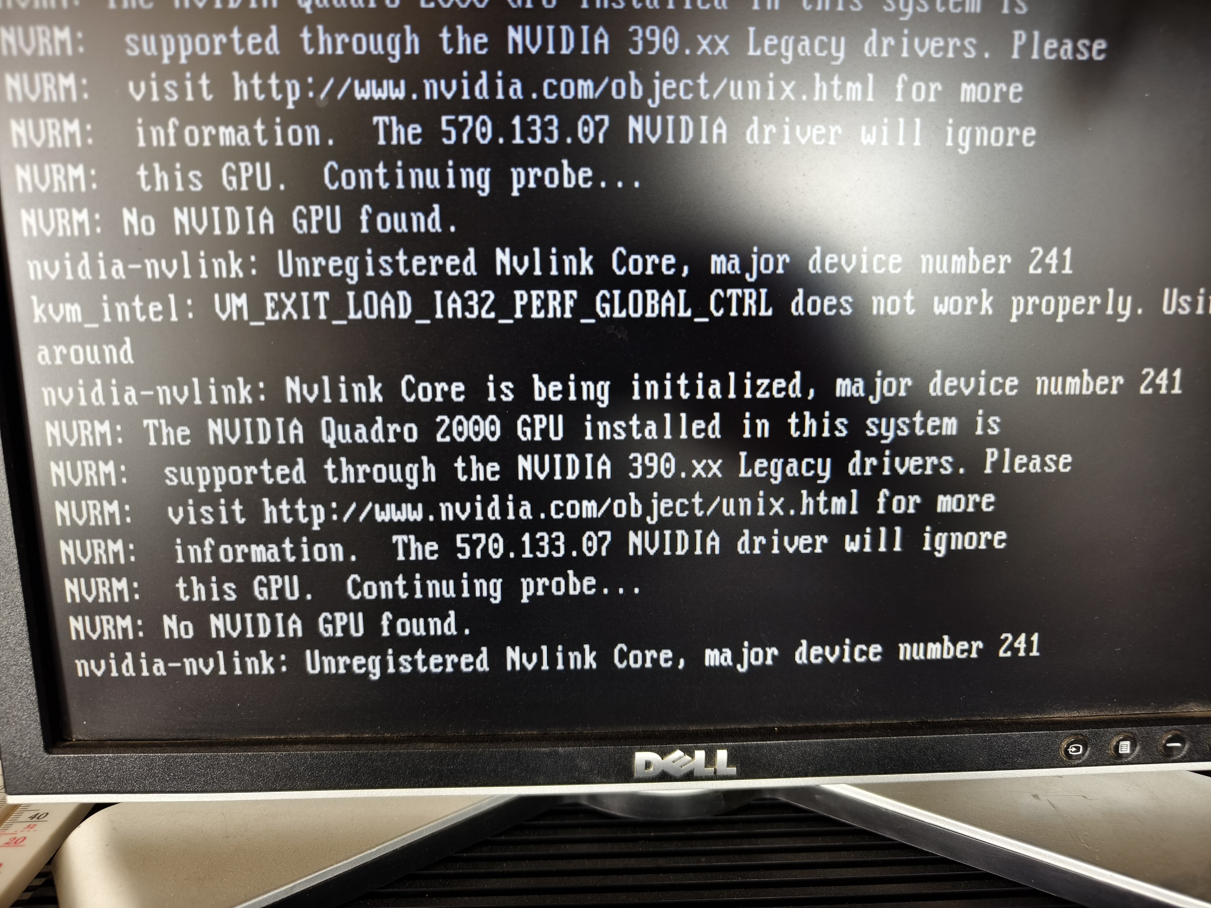

Is there a way to install older driver via plugin? I need v370.xx for Nvidia Quadro 2000 on HP Z800. If manualy run, driver needs gcc. Thanks!
May I first ask why do you need this driver or what is your use case for this driver, better speaking what should the card do?
Thanks for answering. I wanted to try to use some llm-s which refuse to start if nvidia driver isnt loaded. And new driver does not work. See the pic.
Have you seen the first recommended post on top of this thread?
Issue is that these old card don‘t support the container runtime and in addition to that LLMs won‘t run on them because they got too less VRAM and also they are missing feature sets.

Sorry, I'm new. I will look for some supported card. Thanks!
No worries, I'm here to help.
Maybe try to look for something like a Nvidia T400, T600 or even T1000 but please be aware that those cards nothing that you wan't for LLMs and Machine Learning in general since you need huge amounts of VRAM.
