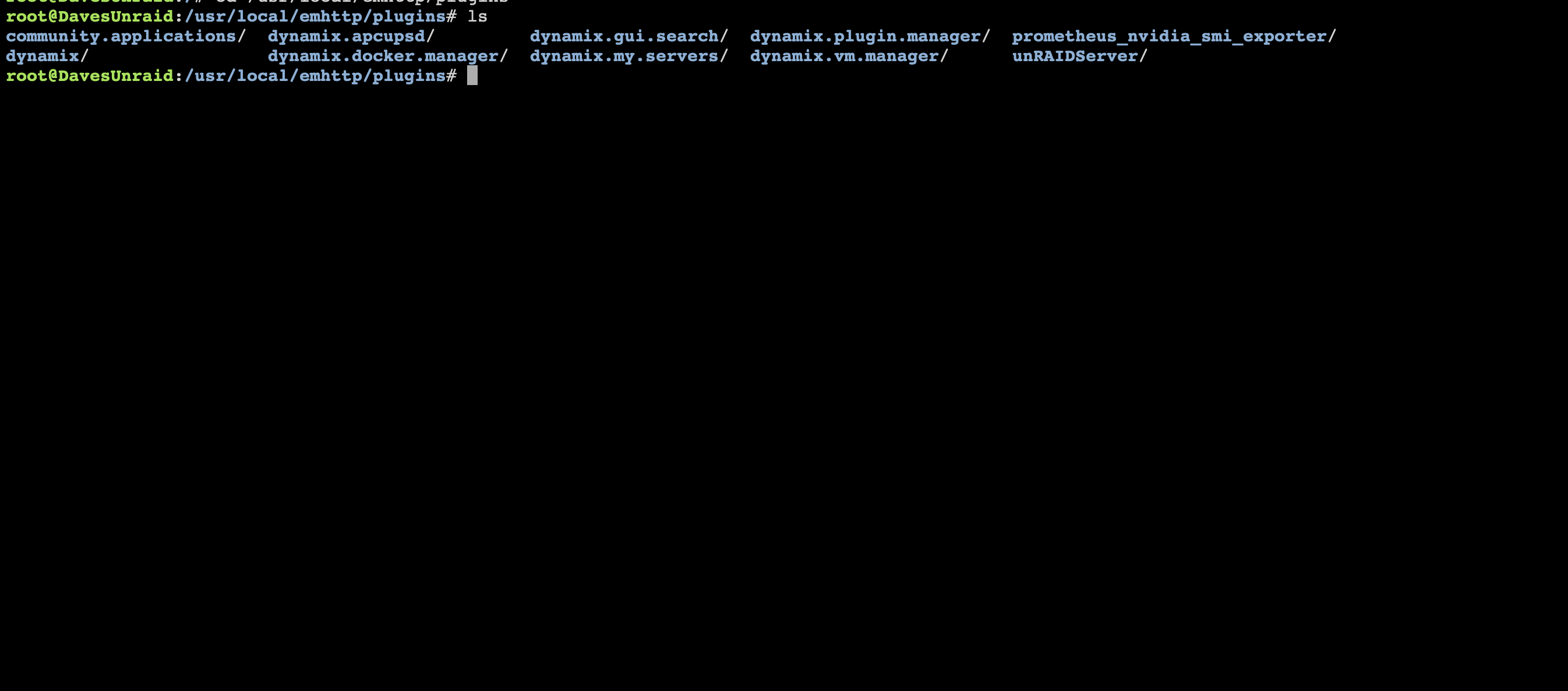

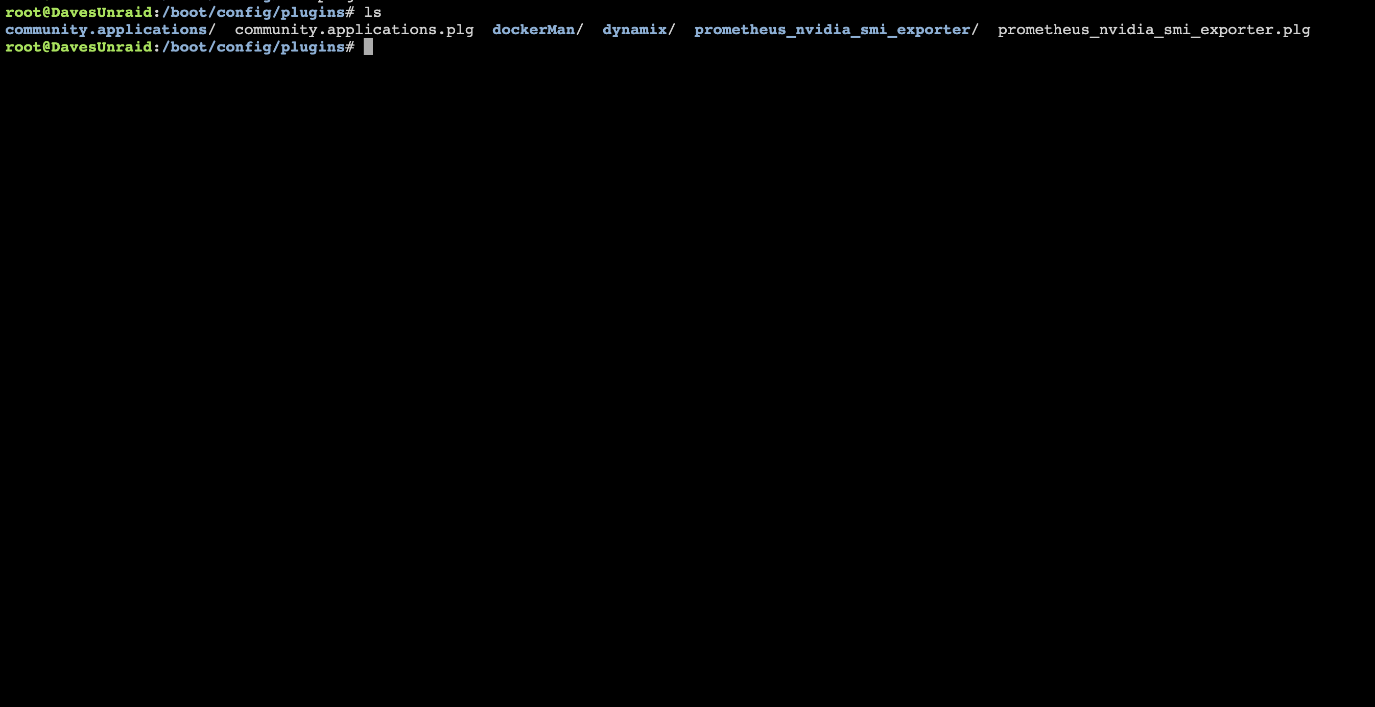

When I navigate to /boot/config/plugins/nvidia-driver/ it doesn't exist.
When I navigate to /usr/local/emhttp/plugins/nvidia-driver/ it doesn't exist.
This is a pretty fresh install of unraid. I only set it up about 2 days ago..

root@DavesUnraid:/# diagnostics
bash: diagnostics: command not found
Please create a post in the General sub forums, I think your USB flash drive dropped offline and that's why you can't issue the command:
At least something seems wrong to me, please try to reboot your server and issue the command right after the reboot.

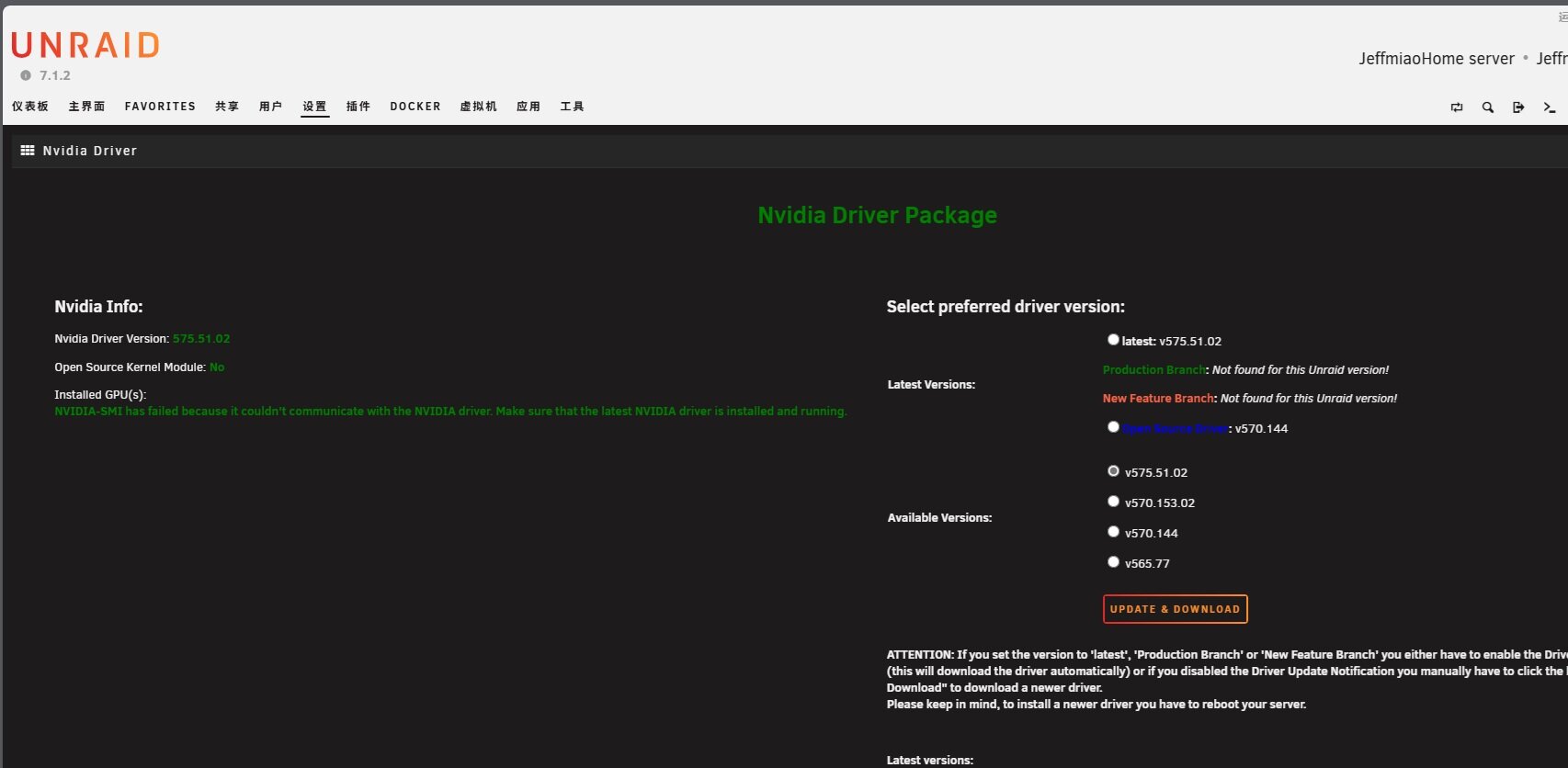

update unraid 7.1.2  Not available Tesla P4
39 minutes ago, Jeffmiao said:
You've enabled the nouveau driver by creating the file /boot/config/modprobe.d/nouveau.conf:
May 20 17:34:58 JeffmiaoUnraid kernel: NVRM: GPU 0000:b3:00.0 is already bound to nouveau.
May 20 17:34:58 JeffmiaoUnraid kernel: NVRM: The NVIDIA probe routine was not called for 1 device(s).
May 20 17:34:58 JeffmiaoUnraid kernel: NVRM: This can occur when another driver was loaded and
May 20 17:34:58 JeffmiaoUnraid kernel: NVRM: obtained ownership of the NVIDIA device(s).
May 20 17:34:58 JeffmiaoUnraid kernel: NVRM: Try unloading the conflicting kernel module (and/or
May 20 17:34:58 JeffmiaoUnraid kernel: NVRM: reconfigure your kernel without the conflicting
May 20 17:34:58 JeffmiaoUnraid kernel: NVRM: driver(s)), then try loading the NVIDIA kernel module
May 20 17:34:58 JeffmiaoUnraid kernel: NVRM: again.
May 20 17:34:58 JeffmiaoUnraid kernel: NVRM: No NVIDIA devices probed.
If you want to revert that and use the Nvidia Driver plugin you have to issue this command from an Unraid Terminal:
rm -f /boot/config/modprobe.d/nouveau.conf
and reboot afterwards.

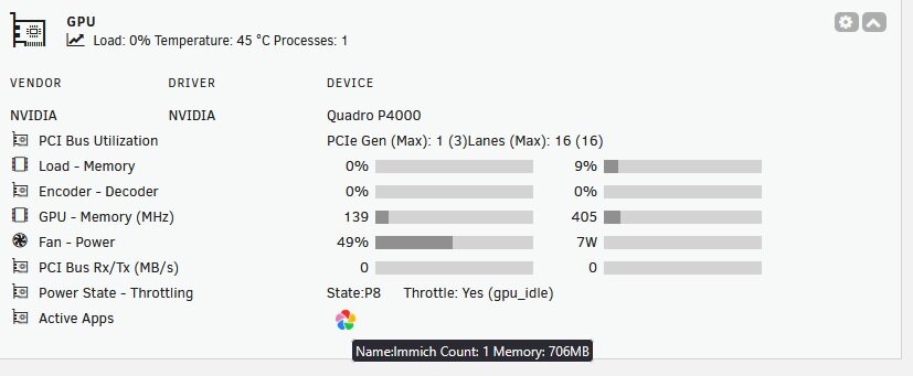

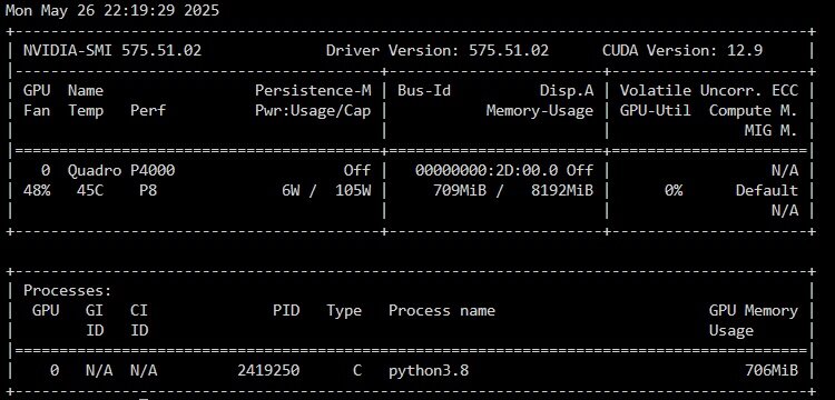

Thank you for your response.
I believe I have everything working correctly now. The P4000 is installed in PCI slot one, and the 5070Ti is in slot two.
The P4000 is being recognized by the production branch of the Nvidia driver and is functional within Docker. The 5070Ti is operational within a Windows 11 VM.
server-diagnostics-20250522-1007.zip
IMG_0330 - kopie.HEIC
Edited by mrkwkns
Yes looking good, from what I see you switched slots from the GPUs and enabled UEFI boot.
Glad to hear that everything is working now.

Hi Since upgrading to 7.0 now 7.1.2 i keep getting an error saying its failed to download the updated driver, it then borks the GPU and the whole system needs to be rebooted for the GPU to be recognised
I have uninstalled and reinstalled the plugin, change from production to Nvidia Driver currently installed v575.57.08. I then have to manually select a different branch for it to force a download and reboot.
Any ideas what the issue is?
