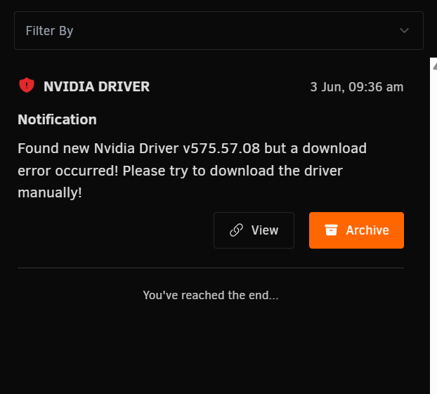

Hi Since upgrading to 7.0 now 7.1.2 i keep getting an error saying its failed to download the updated driver, it then borks the GPU and the whole system needs to be rebooted for the GPU to be recognised
Can you please give me a few screenshots or do you know the exact message?
Diagnostics would also help.
If we are talking about the automatic update because you are on the latest branch then this even won't bork your system because it would simply remove the new driver which failed to download and the old driver will be still be running, you always have to reboot to switch drivers, the plugin on it's own never does a update from the drive when it's running.
2 hours ago, Rkpaxam said:
Any ideas what the issue is?
Diagnostics after the error message would maybe help or the exact error message itself.

Not the original poster but I am having the error after updating. Weird part is it is trying to download v565.77 but I am choosing v575.57.08 . Diagnotstics attached.
Thanks for the fix below. Sorry I missed it the first time.

Sorry its took a few days for it to come back up Please find attached. As before due to this happening the GPU is now not recconised and I will have to change to another driver and reboot to get it to work. {A8048024-B04D-4A69-81DD-5D02CF96E32B}.png

Do both of you use Unifi gear by any chance? If yes please check your IDS/IPS rules and logs if there are any hints in there.
The driver is pulled from GitHub making a GitHub API Call and then the download from GitHub is initiated, there is nothing more to it.
However what I noticed lately that GitHub Downloads can be at times, from certain regions in the World, be very unreliable.
I'm not sure what causes this but these are the main reasons what could cause the download to fail:
  • No left GitHub API calls for your IP (60 per hour)
  • Unreliable Download from GitHub
  • Insufficient disk space on your USB Boot Device
Im using Opensene router with crowdsec & Geoblock and TP link (TP link does not interact with unraid server on the network) with some AGH instances (however the server is on a bypass from these due to reasons). but never had this issue before the upgrade to 7.0 and have no other issues with Github downloads.
And as I can still download the file manually I cant believe those are related to my issue at least.
No issues with the USB plenty of space and no other failings.
For now I have stuck it on a specific driver so it shouldn't try to update.
As it's only transcoding I can't see being a few drivers being being an issue.
Edited by Rkpaxam

Yeah, sure do. Opened up the regions I had blocked and that didn't help, one of my plug-in updates specifically fails to download from GitHub, but I think you're on to something with the boot drive. I've suspected a problem with it and have a replacement coming later today. Hopefully that is my solution.
I've just selected a driver and told it not to auto update and I will manually do it as I want to.
I personally can't see it being my USB or isp setup as this issue only started with 7.0.
The fact it is multiple people with the same issue would lead me to think either unraid, plugin or hardware issue with the newer kernel

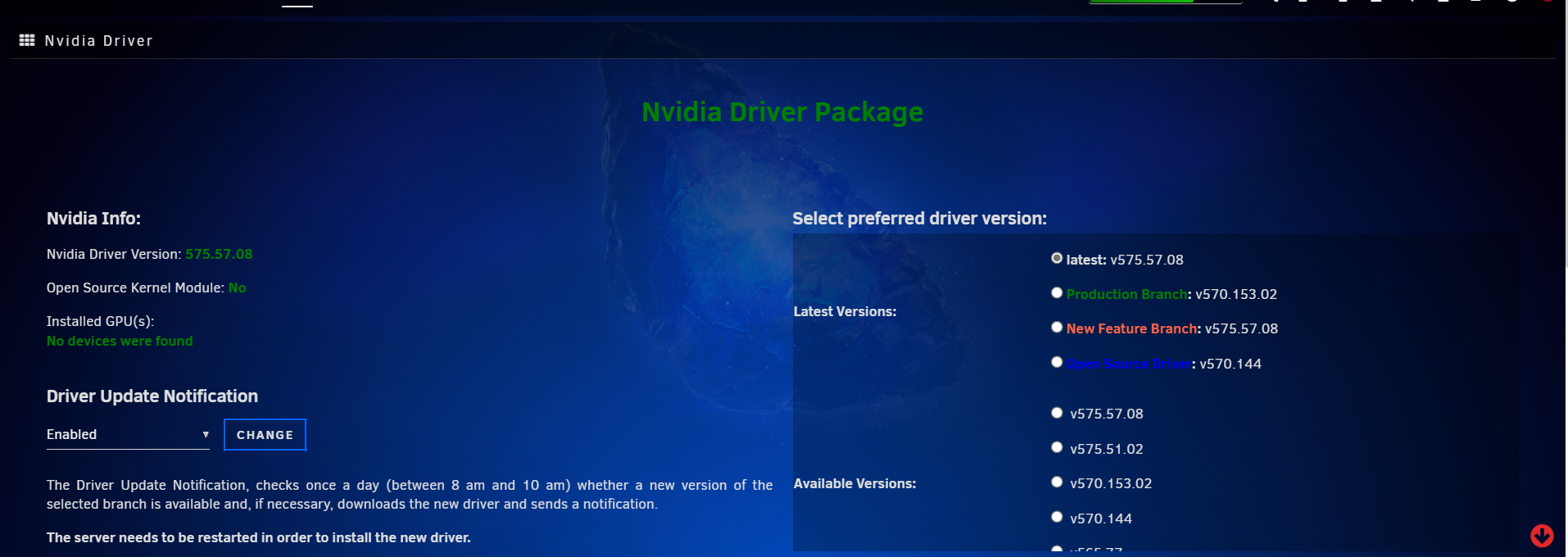

Hey all.
I'm also affected by the RTX 5070 driver situation.
Any info on when (or if) the open source 575.57.08 driver will be released?
What situation?
On what Unraid version are you on?
4 hours ago, ich777 said:
What situation?
I'm on UNRAID 7.1.2, and restricted to using the open source driver with my RTX 5070. However CUDA does not work on version 570.144. I read somewhere that 575.57.08 has better support for CUDA.
Open source drivers are compiled once when a new Unraid version is released, you can upgrade to 7.1.3 and there you should have the driver.

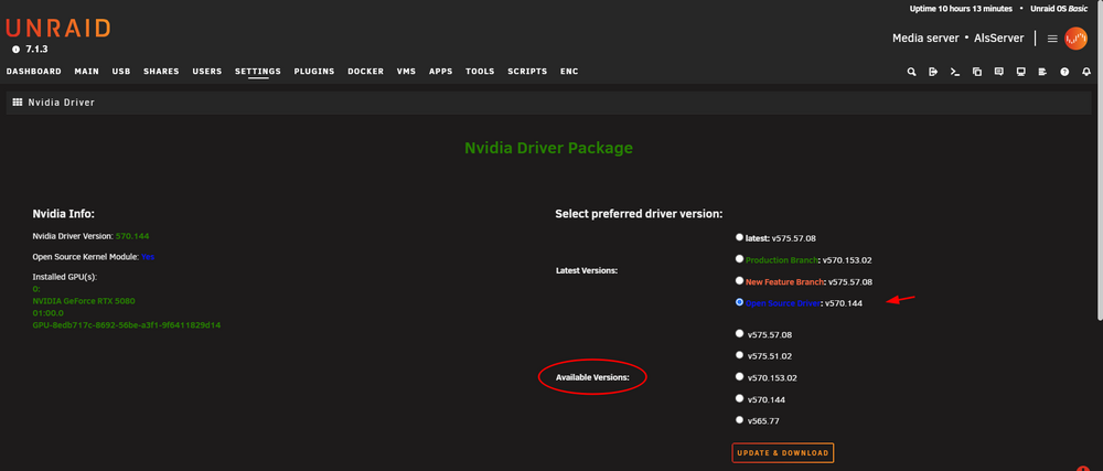

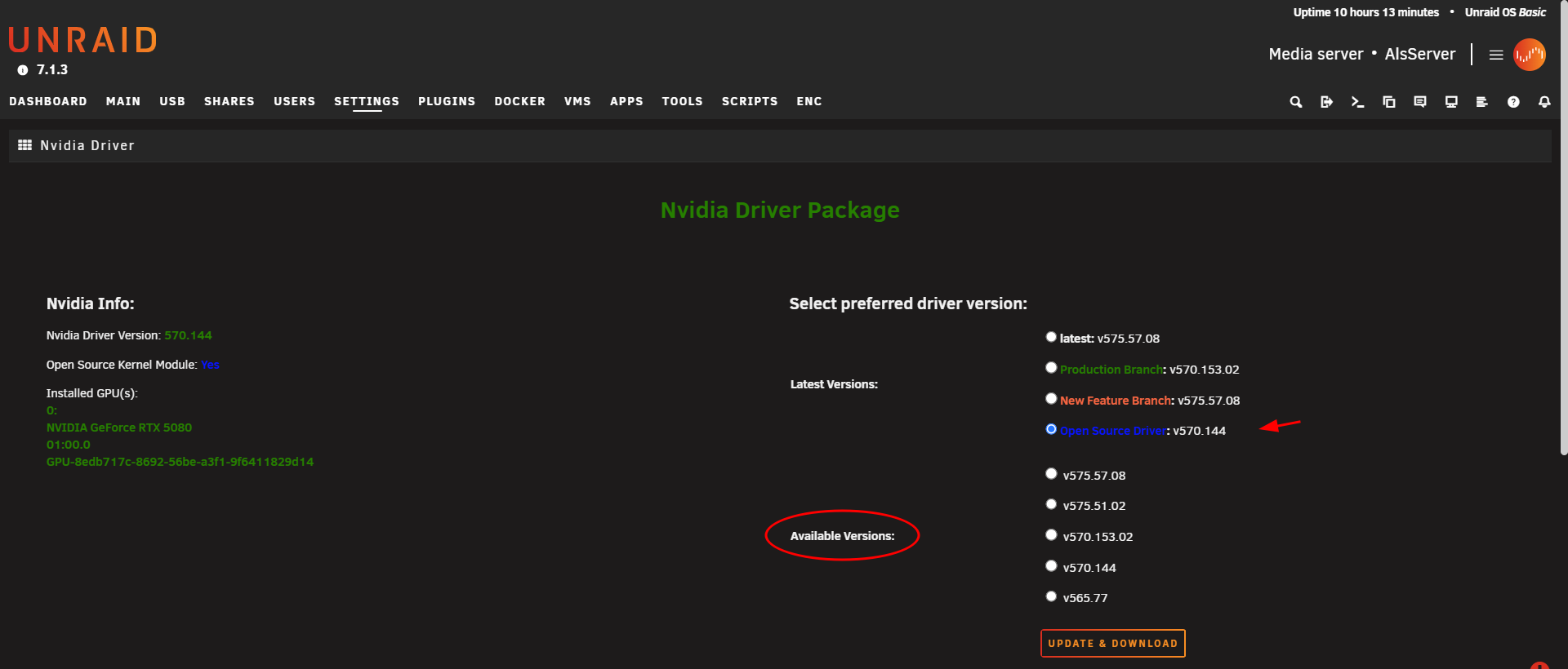

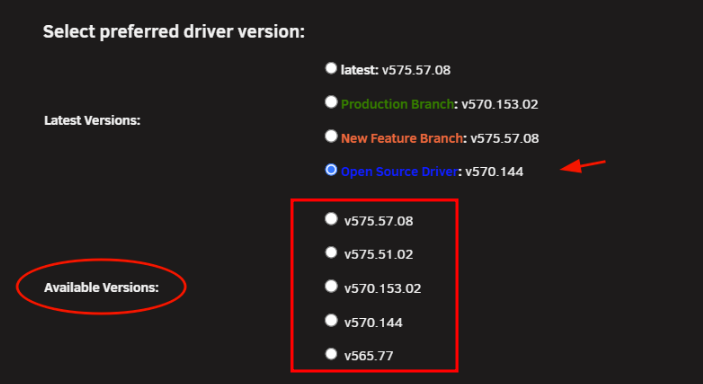

Seems that the nvtop plugin is also linked to this thread for support. Just came to ask if there's any plans to bump nvtop to the latest version?
i assume users are maystuck here
opensource says latest 570.144
while on available versions there is no choice to choose between regular and opensource

Ok so i think i found the issue, whilst my unraid is whitlisted in my AGH instance it seems to be having issues randomly so i have gone back to the data harvesters that are google and all is well.
