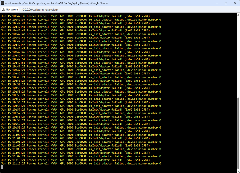

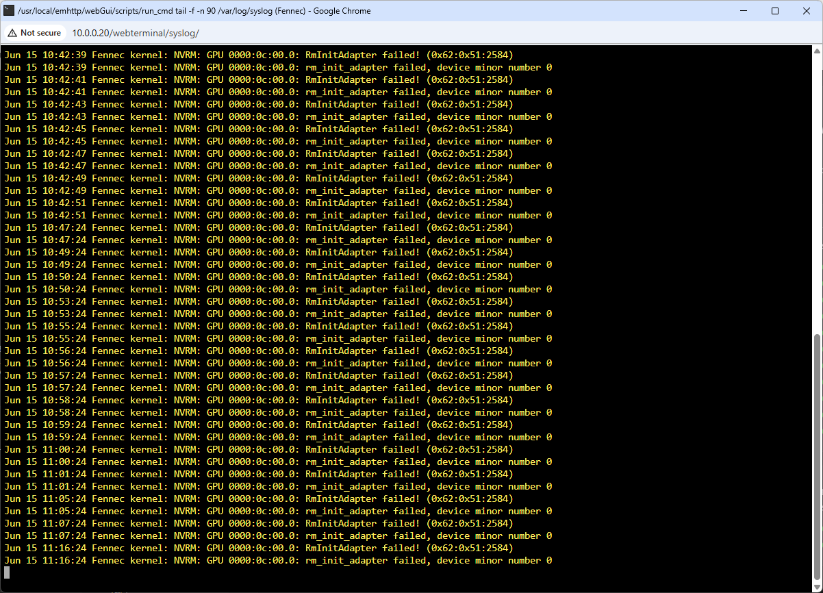

Hi all,
I am having issues using this plugin and retaining a "connection" to the GPU. The GPU attached is an RTX 3060 (was a 1660 Super -> same issue) and is using driver version 575.57.08 on Unraid 7.1.2. The GPU is being passed through to Jellyfin in docker for transcoding and is not utilized anywhere else. Within 24h of the system being booted if a transcode attempts to occur, my syslog will be filled with:
Jun 12 01:54:01 Fennec kernel: NVRM: GPU 0000:0c:00.0: RmInitAdapter failed! (0x62:0x51:2584)
Jun 12 01:54:01 Fennec kernel: NVRM: GPU 0000:0c:00.0: rm_init_adapter failed, device minor number 0
This will cause my transcodes to not start and the media will fail to play. Things I have tried include:

11 hours ago, tykateetee said:
I took a look through the forum but the only other issues with the keywords "RmInitAdapter failed" were for individuals with a faulty GPU and the message was present on boot.
Please disable C States in your BIOS and male sure that your BIOS is up to date.
This unfortunately did not work. The "RmInitAdapter failed!" message is still present in the syslog.
I'm open to any other suggestions that you or others may have.

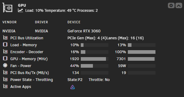

6 hours ago, tykateetee said:
I have also notices that the error occurs in the syslog randomly, even when there is no transcode running.
You have probably the Dashboard from Unraid open when you notice this, correct? GPU Statistics is also querying the state from the GPU and that‘s also what could produce that error.

The dashboard is open, and GPU Statistics is installed. This error still occured before I installed GPU Statistics for the first time. The error did show up one time at 3AM and I don't think a dashboard was open at that time, but I could be mistaken there.

2 minutes ago, ich777 said:
That's weird, that shouldn't work at all...
Welcome to my last month XD. I've thrown in some screenshots to show that I'm not fully crazy.
May I ask to what interval you've set the refresh from GPU Statistics?
However this seems like a firmware issue to me...
